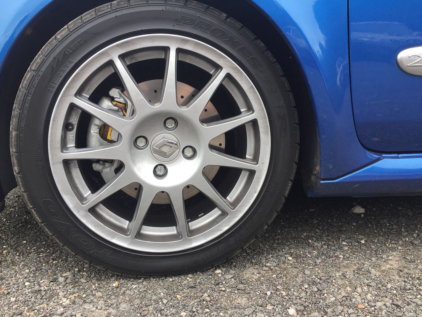

Some pictures of the brakes:
b3_1.jpg~original
b1_1.jpg~original
b2_1.jpg~original
The brakes are certainly more powerful with stopping force, the pedal feels very solid with fantastic feel, all round the brakes feel totally fantastic, normally small hatches feel under braked, but the Clio felt quite good stock, but now it feels like its got serious stopping power with great modulation.
