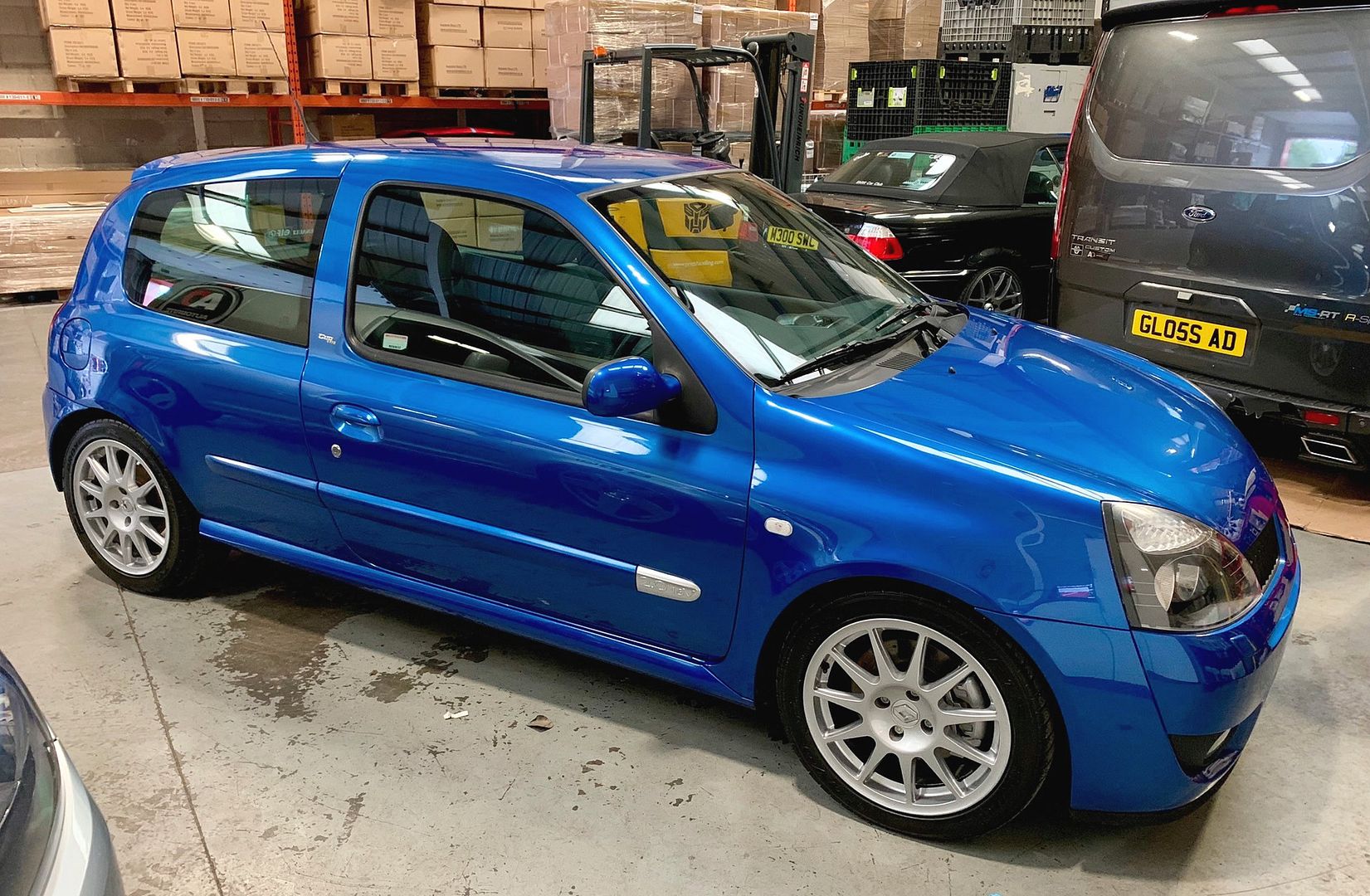

Pure Motorsport lightweight stainless exhaust system arrived:
It is a modular system, this one is designed to fit 182 manifold, I also have a 182 manifold, this one has 200 cel performance catalyst and centre silencer with the standard stealth (downturned) back box, noise wise its probably marginally louder than stock system, of course been modular swapping in a de-cat pipe or even removing the centre silencer is easily accomplished should one ever wish for more noise.
As my car has a Klarious ECP cheap exhaust on it, I wanted to get a nice quality system on it and the PMS system really is indeed very nice, good welds and a lovely polished finish which will really finish off the underside.
Shall also remove the spring from the brake bias, that should hopefully stop the rears locking causing instability when braking hard from high speeds.
Next step is off to see Chris at EFI for a remap, question is should I pop an ITG or other performance panel filter in the stock air box or do they not make any additional power?
On the standard 172/182's getting an air feed to an induction system is very difficult, you basically have to run the CAF to the wheel arch where the stock air feed is, so you make very little gains if any. I was told not to bother.
On the Cups there is plenty of room to run a CAF to the front grill which has seen beneficial results, but you're only talking 5bhp.
My 172 had a 182 manifold, decat, 2.5" KTEC exhaust and an RS Tuner map on it. It made 177bhp. Best mod on it was definitely the decat, car revved so much better. The RS Tuner bringing the power in earlier also made a nice difference.

Hi there
So the exhaust has been fitted today, the garage did not enjoy the job, took around five hours alone to fit the exhaust due to the subframe having to come down in order to be able to get the 182 manifold fitted, all new gaskets fitted throughout entire exhaust system along with brand new 02 sensors as well, again I don't mess about, everything brand new! Picture of the exhaust installed:
Looks good, also both front CV boots were showing some wear, very marginal hole in both, so replaced both CV boots for good measure.
Camber bolts also installed and now have an extra degree of negative camber each side, so now -1.50 per side negative, can get upto around -2.00ish if so desired but feel -1.50 will be enough.
Upon first startup and driving the exhaust was kind of boomy at which point I thought mmmmm not so sure about this and damn I am glad I got the catted and silenced version.
But after 30-40 minutes driving the boom and drone seems to have reduced a lot, I am guessing it is furring up inside or whatever you wish to call it.
It sounds OK, as good as a 4 pot can sound I suppose, the induction side of this car is where there is more potential for good sound. I would say at high RPM its got a nice burble and the blips on downshifts sound good.
Car certainly feels like its got more go everywhere and the top-end seems to rev faster.
Handling is improved for sure, car has a lot more front end grip for sure, so clearly needed that additional negative camber.
I got the ITG panel filter but am deeply unimpressed by it, up removing it from the plastic seal there was a huge amout of oil peeling away and excess oil generally on the filter.
Plus then upon putting it in the air box it seems like say 1mm too small in width and is not sitting nicely, in the end I put stock fiilter back in, not happy at all.
Shall probably take it back to ECP tomorrow and see if they will give me a refund. Surprised as ITG is normally good, but over oiled and does not fit well, not happy.

The extra camber is a beautiful thing, my god it was such a yobbo before, but then you can literally just throw it and I can now really feel it cocking a rear wheel in the air, front-end grip is massively improved and the R1R tyres really do feel like poo poo to a blanket especially in the cooler ambient temperatures of this morning.
Also rear spring removed from brake bias, which should not be there, car is now mega stable under braking, such incredible brakes on this car!

So this morning I made the trip to EFI Parts for my custom mapping session on the dyno at a cost of £179. Car setup and ready to get some baseline figures:
Chris was very professional, really knows his stuff and told me Cup 172's typically when stock will make 166-171BHP if they are healthy and as I have the 182 manifold and PMS exhaust system fitted it should be worth 5-6HP additional if the cars factory ECU has not leaned or gone too rich due to manifold change.
The first run car made 175HP, then 176HP and a final run at 177HP. This pretty much means if the car was stock, still 172 manifold and exhaust setup it would have probably made around 169-171HP, but the moment I fitted the 182 manifold and PMS exhaust system, the 5-7k rpm pull felt stronger, so when Chris said to expect 5-6HP from a 182 manifold / cat setup he was pretty much bang on.
Chris said, very healthy car indeed and once mapped to not expect much at the top-end as the fuelling is pretty good as it is, so expect maybe 180HP.
So Chris spent close to an hour fine tuning the car, getting the fuelling where he wanted and improving the drive ability of the car and reducing the cat warming setup so it no longer drives poorly when cold, something Renault do on purpose to fast warm the cat up, the downside is it makes the car feel very flat for first 30-60s of driving around 2000rpm.
Fine tuning complete and the car made 180HP and 161lb/ft, a result I am very happy with as the cars only modifications are 182 manifold and full PMS sport cat exhaust system. Chris said a panel filter put it in the 182HP region or a full CAI maybe 185HP but then the issues of heat soak and less power in real world hence the favourite option generally been PH1 air box or V6 air box, or the ITG Maxogen setup.
Dyno graph:
You can see he has achieved more power and torque everywhere, now on the graph your maybe thinking that don't look like much and your never gonna feel 3-5HP gain, but do remember this is a 1000kg car.
I handed over the monies and drove home and within the first two minutes of driving the improvements can be felt, the car is smoother, it pulls away more cleanly, the 2000-4500rpm range feels transformed, it feels like its gained a solid 20-30HP here, of course it has not but the fact it feels like it has really shows you the improvement in drive ability. Coming out of corners now if your under 5000rpm are no longer an issue, before the car could feel flat due to how the stock map really leans out to give that kick. Whereas now the car feels much stronger, the kick is still present and the pull to 5000-7500rpm is just very clean.
A vast improvement, well worth the money and very happy. Might be taking a venture to Blyton Park in it end of this month as a few mates are going and they said in the Clio it will be great fun as its a track that suits smaller and lighter cars.
What is next, really nothing, that is really now as far as this car goes, anything further would detract too much from the car Renault designed, its an incredible and fun road car, pretty handy on a circuit too and very easy to drive. Now just to enjoy. :)

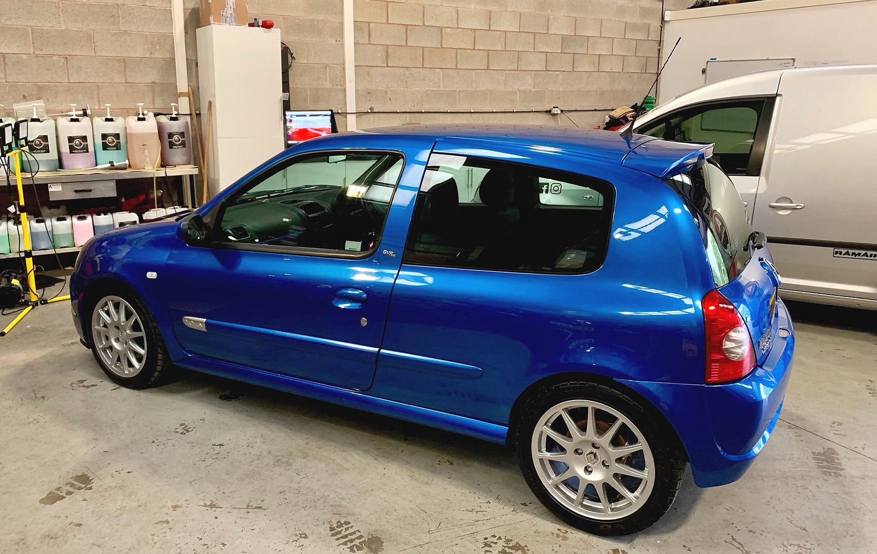

Full paint restoration completed by Autobrite:
ab6.jpg~original
ab7.jpg~original
ab4.jpg~original
ab5.jpg~original
ab1.jpg~original
ab2.jpg~original
ab3.jpg~original
Top job as always, car looks better than it did the day it arrived in Renaults show room, that is this cars restoration complete, first time I think a car was ever truly completely by me, now time to continue with the M3. :D
I probably have the most mechanically sound and cleanest 172 Cup in the UK, maybe in existence considering mechanically every is now fully refreshed when it comes to suspension, brakes etc.
OcUK Staff
OP
17 Oct 2002
38,225
OcUK HQ
Amazing transformation mate, very nice.
What did the paint correction involve and how much if you dont mind me asking. What kind of defects did it fix etc. My 350z would benefit I feel
There was a lot of light scratches which are now 99% removed, there were some deep scratches which are improved and far less noticeable but still able to see if pointed out.
Swirling removed.
Interior de-fogged, to remove any odour from previous owner, paint sealed, wheels sealed, interior cleaned etc.
2 days work.
£300
