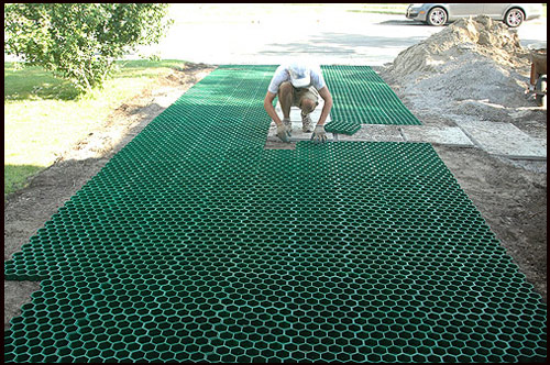

if you dont want to have a big slab of concrete down the garden what about some grasscrete or something. Theres two designs, one is a concrete slab that you can grow grass on or another design is plastic/metal/rubber stuff with lots of holes in it, again allowing grass to grow. That way it wont stick out as much.
http://farm1.static.flickr.com/82/211203615_86128f2054.jpg?v=0
http://www.frankejames.com/art/layingperma_0103.jpg
+1
This will also allow rainwater to soak down to the ground easier. If you have a large expanse of slab, this willcreate runoff and maybe needing some sort of half gutter to one side or something.
+1
great, now your front garden can look like a temporary car park at a festival! Seriously, I would wager those two "solutions" will not really look great to prospective purchasers if/when the OP decides to sell their house (I assume they own as doing this kind of work on a rental property would be madness).
