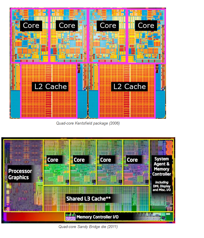

Surely the motherboard bus speeds will be the primary reason for these discrepancies... after all, doesn't the Q6600 sill use the concept of a northbridge as an external memory controller and PCI express controller?
Yes that's one of the reason. However the overall richness and complexity of cpu core design (improved logic etc) has to be taken into account aswell with the memory controller being part of the overall design.
http://www.anandtech.com/Show/Index...page=1&slug=why-ivy-bridge-is-still-quad-core
Just look at the transistor density and design of the individual core in Q6600 vs Sandybridge.

Yes that's one of the reason. However the overall richness and complexity of cpu core design (improved logic etc) has to be taken into account aswell with the memory controller being part of the overall design. #snip#
That certainly would account for the improvement at the same clocks.
Just to point out though, the memory isn't running at the same frequency in this example, so it's not a true apple-apples comparison. Plus I'm guessing it's DDR3 vs DDR2...
What this example does serve to emphasize though is - newer technology delivers the same AND MORE instructions per clock cycle.
