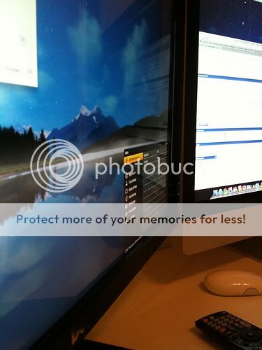

Iv got a U2410 which I would love to have the glossy screen like you see on some. Basically before going all out on my U2410 will full warranty iv got a old 17" dell ultrasharp with the same anti glare coating. Its soaking at the moment so should have some results tomorrow to show the difference.
Its supposed to give a near gloss finish comparable to the iMac screens. Heres the guide I am following and a few pics of the finished product.
http://forums.overclockers.com.au/showthread.php?t=878149
First is a screen with the mod done next to a stock screen with the coating.
Has anyone done this before? Just to add this voids any warranty obviously and i take no responsibility if you try it and mess it up. :)
