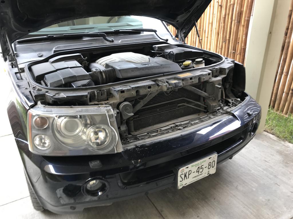

Wasn’t so easy sadly
Decided to do both whilst the grill was off
And it all worked out in the end. Ridiculously complicated for a simple bulb though.
28 Sep 2012
3,865
Monterrey, Mexico
Crazy, you'd assume load of space would exist behind the headlights!
There’s a fair bit of space, and I saw a video of a guy doing it without taking the light unit out. The problem is, mine seems to have an extra wiring harness where his didn’t which means you have a lot less space, and seating the bulb correctly without touching the glass on anything, then reattaching the ballasts is virtually impossible.
