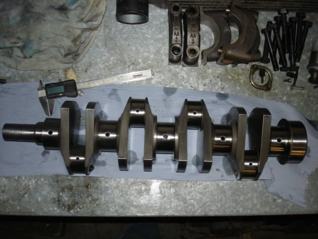

I have changed my mind on crank stroke, it's surprising what you can get in there with a little thought
For now all I'm saying is that the stroke will be quite long, it wont want to rev super high but I'm not bothered about that in the slightest.

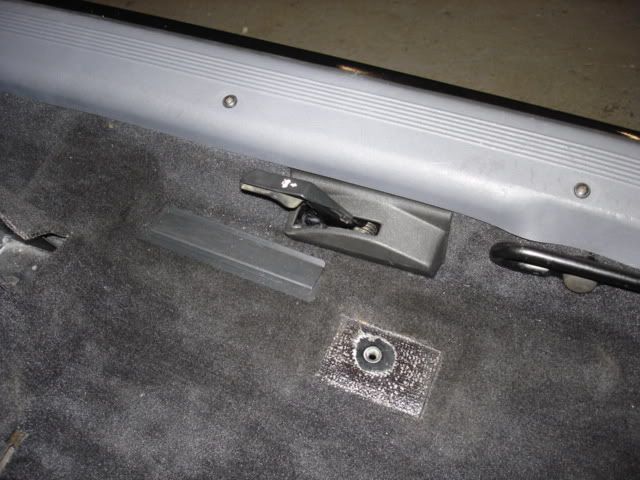

Boot release

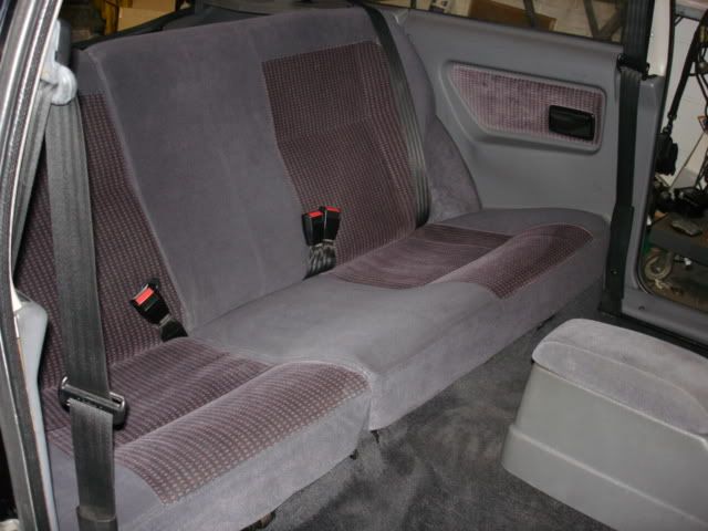

Rear seats and trims in...
Got the crank today :grin:
It will be 2.3 Graham, I'm pretty sure its a Farndon. Got it off Len for a very good priceD:
