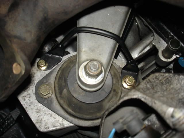

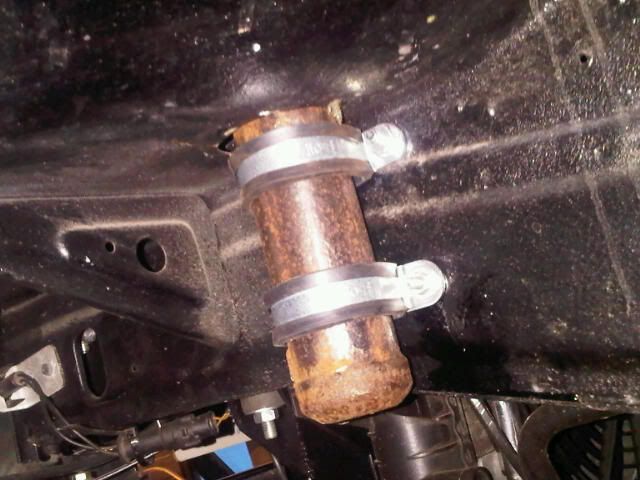

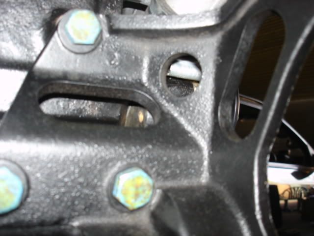

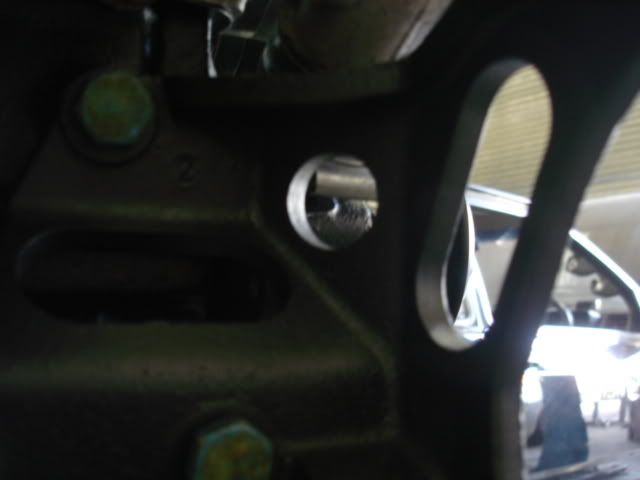

As I'm using std Escos mounts I needed to stop the engine lifting in the event of the drivers side mount failing..

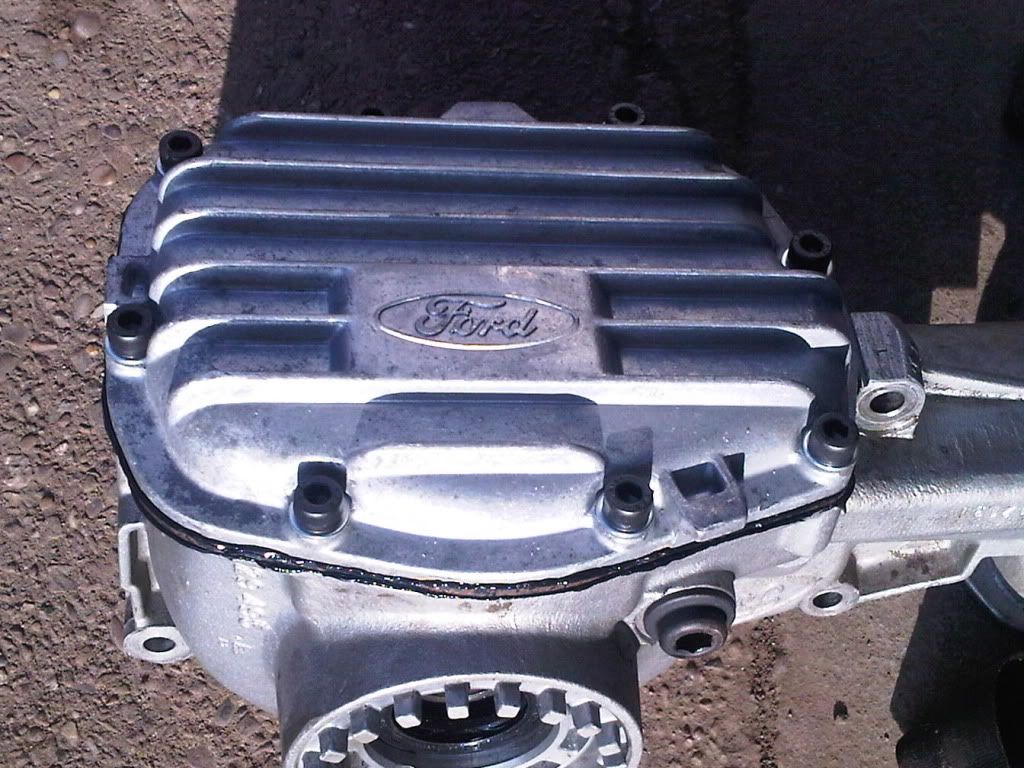

Std front diff casing drilled and re threaded to M8 (instead of M6) with strenghthening plate too..

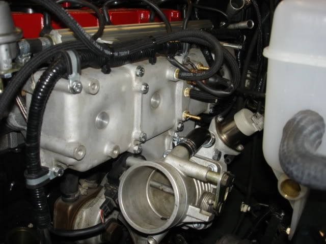

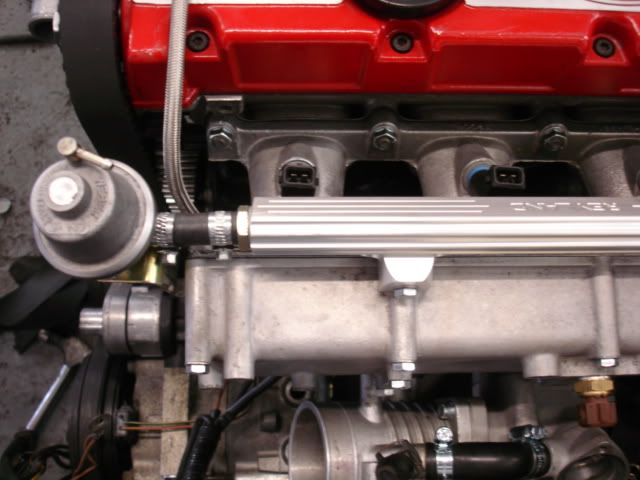

Std Weber reg with alloy fuel rail..
As it sits now (boost hose just fitted for trail fit)..
Only using 4 injectors so I blanked the others off..

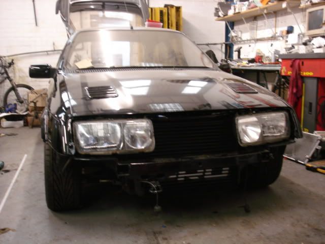

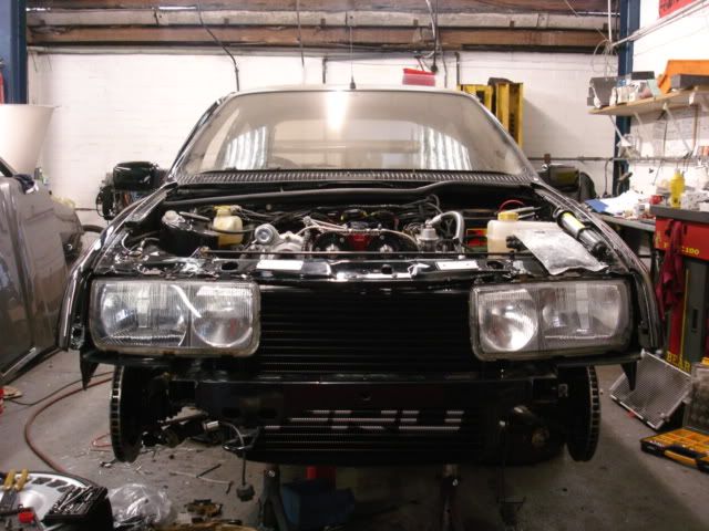

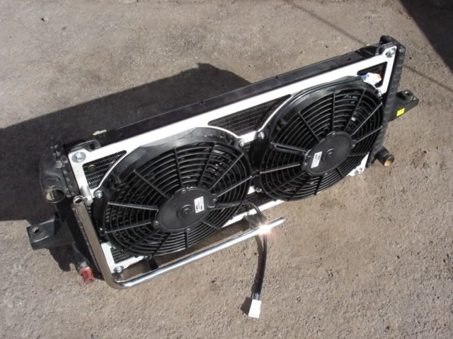

Bit more progress today, got all the rads in and was able to have the car running for ages whilst messing, its very quietD:

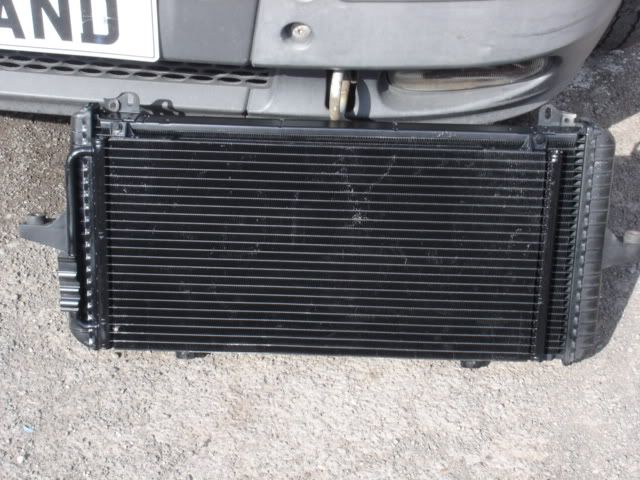

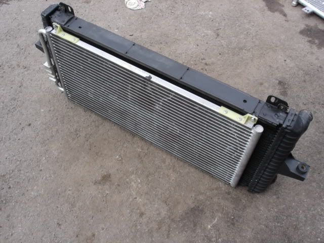

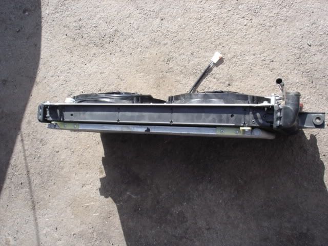

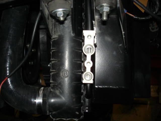

As you know I have fitted aircon but finding somewhere for the aircon rad hasn't been easy, first off I thought I'd see what air temps I would get if I mounted it in front of the 60mm Pro Alloy intercooler but I just know I'd end up moving it afterwards.. So I thought I'd try it between the I/C and the cooling rad...
Pipe connections should be easy enough..
As it stands now...

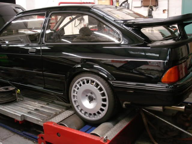

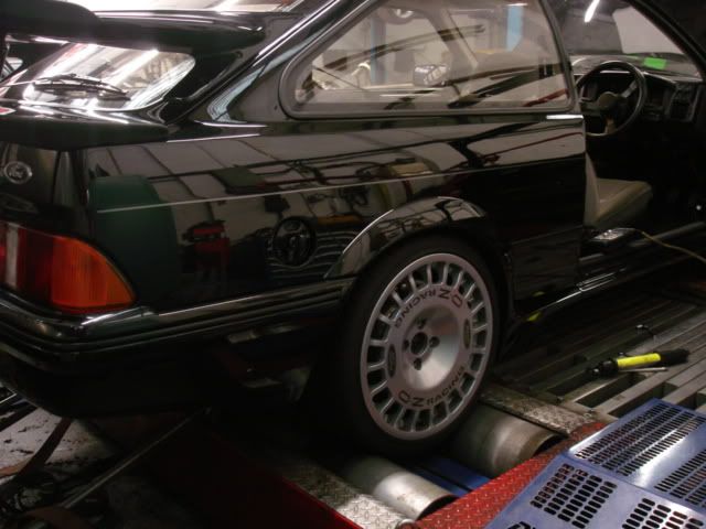

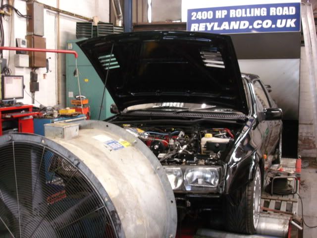

Will have it on the rollers during the week and map it upto 1 bar and then run it in on the road, hopefully get it MOT'd in the week too and then I can get the number plate transfered on and start getting some miles on her.
Just the o/s one causes the shaft to pull out when it fails..
Anyhow, it's starting to look like a car nowD: I could get all excited!

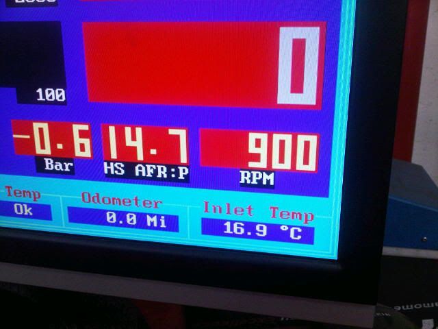

Spent some time today mapping it upto 1bar/6k rpm so I can run it in.... Couldn't help myself and decided to power run it at that to see what it makesD: It actually made 1.1 bar of boost and I reved it to 6300rpm, at that it made 400.3 hp which I reckon isn't bad.

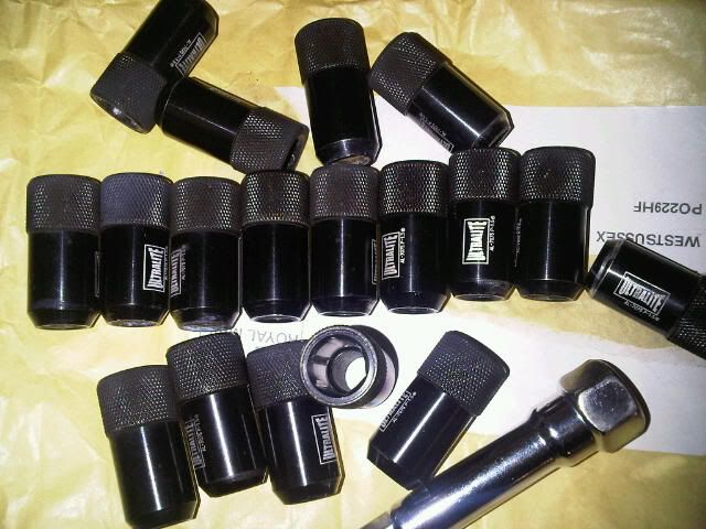

Won these Ultralite wheel nuts on ebay for £22 the setD:

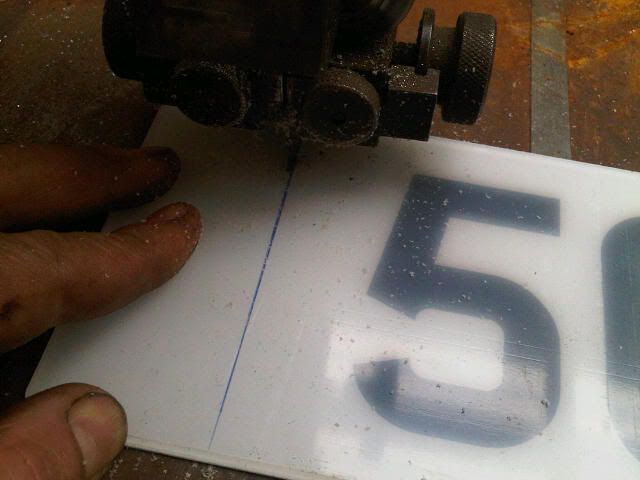

Number plates are too long for my liking!...
That's better!!
