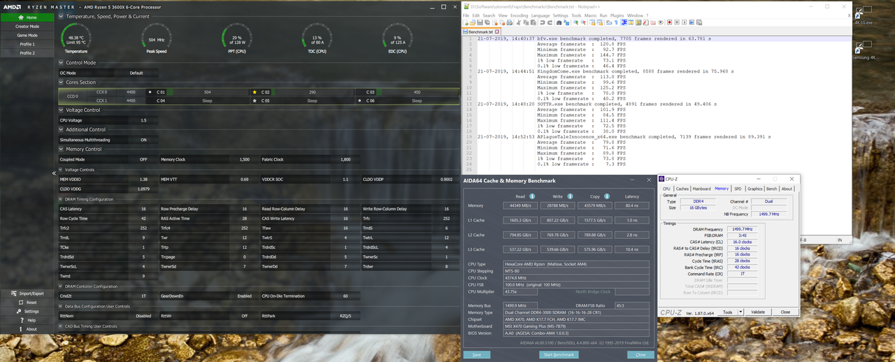

Ryzen 3600X Tested Tight Ram Timings 2133Mhz 2400Mhz 2933Mhz 3200Mhz 3733Mhz 4000Mhz 4200Mhz 2560x1440 Ultra settings.
There are plenty of 1080P and lower test,these test are aimed at people who blew there cash on $500+ graphics cards and are not quite sure if they should upgrade their ram.I say no if you game at higher resolutions.
Battlefield V I noticed that above DDR4 4000Mhz average FPS started to climb.Which is weird because memory clock/fabric clock/memory controller switch from 1:1:1 to 1:1:2 so memory controller gets cut in half.
A Plague Tale Innocence had two areas where FPS lows dropped to 16 FPS and 7 FPS in the same spot on every test
All games gave the exact same game play every test.
Video of game areas tested
RAM TIMINGS USED FULL NO AUTO
♦ 2133Mhz (16GB)CL10-10-10-10-21
♦ 2400mhz (16GB)CL10-11-11-11-21
♦ 2933mhz (16GB)CL12-14-13-13-26
♦ 3200mhz (16GB)CL14-14-14-14-28
♦ 3733mhz (16GB)CL16-17-16-16-34
♦ 4000mhz (16GB)CL16-18-17-17-36 -(memory clock 2000x2/fabric clock 1800x2/memory controller 1000x2)
♦ 4200mhz (16GB)CL16-18-17-17-36 -(memory clock 2100x2/fabric clock 1800x2/memory controller 1050x2)

You wouldn't find much difference because you changed the column access strobe (CAS/CL) as speeds increased, not saying that's wrong, that you shouldn't have, that the benchmarking is irrelevant, that it could've been done any other way, or anything else negative about the testing. I'm just trying to point out that when looking at RAM benchmarks people need to take into account the correlation between CL and clockspeed.
To put it in perspective these are the real world latencies at each of the tested settings...
♦ 2133Mhz (16GB)CL10-10-10-10-21 (9.37ns)
♦ 2400mhz (16GB)CL10-11-11-11-21 (8.33ns)
♦ 2933mhz (16GB)CL12-14-13-13-26 (8.18ns)
♦ 3200mhz (16GB)CL14-14-14-14-28 (8.75ns)
♦ 3733mhz (16GB)CL16-17-16-16-34 (8.57ns)
♦ 4000mhz (16GB)CL16-18-17-17-36 -(memory clock 2000x2/fabric clock 1800x2/memory controller 1000x2) (8ns)
♦ 4200mhz (16GB)CL16-18-17-17-36 -(memory clock 2100x2/fabric clock 1800x2/memory controller 1100x2) (7.61ns)
Goes without saying those aren't 100% accurate as the other sub timings would've also effected things slightly but give or take a few 0.01ns they should be fairly accurate, it's also worth saying those are only real world access times from when the memory controller issues a request to when the first word is presented on the pinout, subsequent word accesses increase in latency. Also I'm not 100% sure how much is added when switching to the 2:1 divider but i suspect it adds at least one clocktick.
