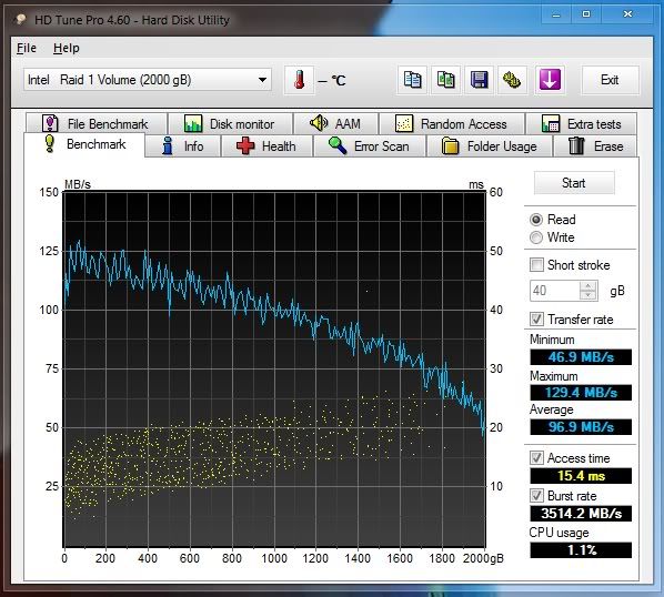

Here's a bench of the drive:
I've tried going onto Samsungs website and downloading their 'Acronis Advanced Format Drive Alignment Tool', it shows my Samsung F4 2TB but the icon next to it says 'This is not an Advanced Format Drive'! WTH!!?
