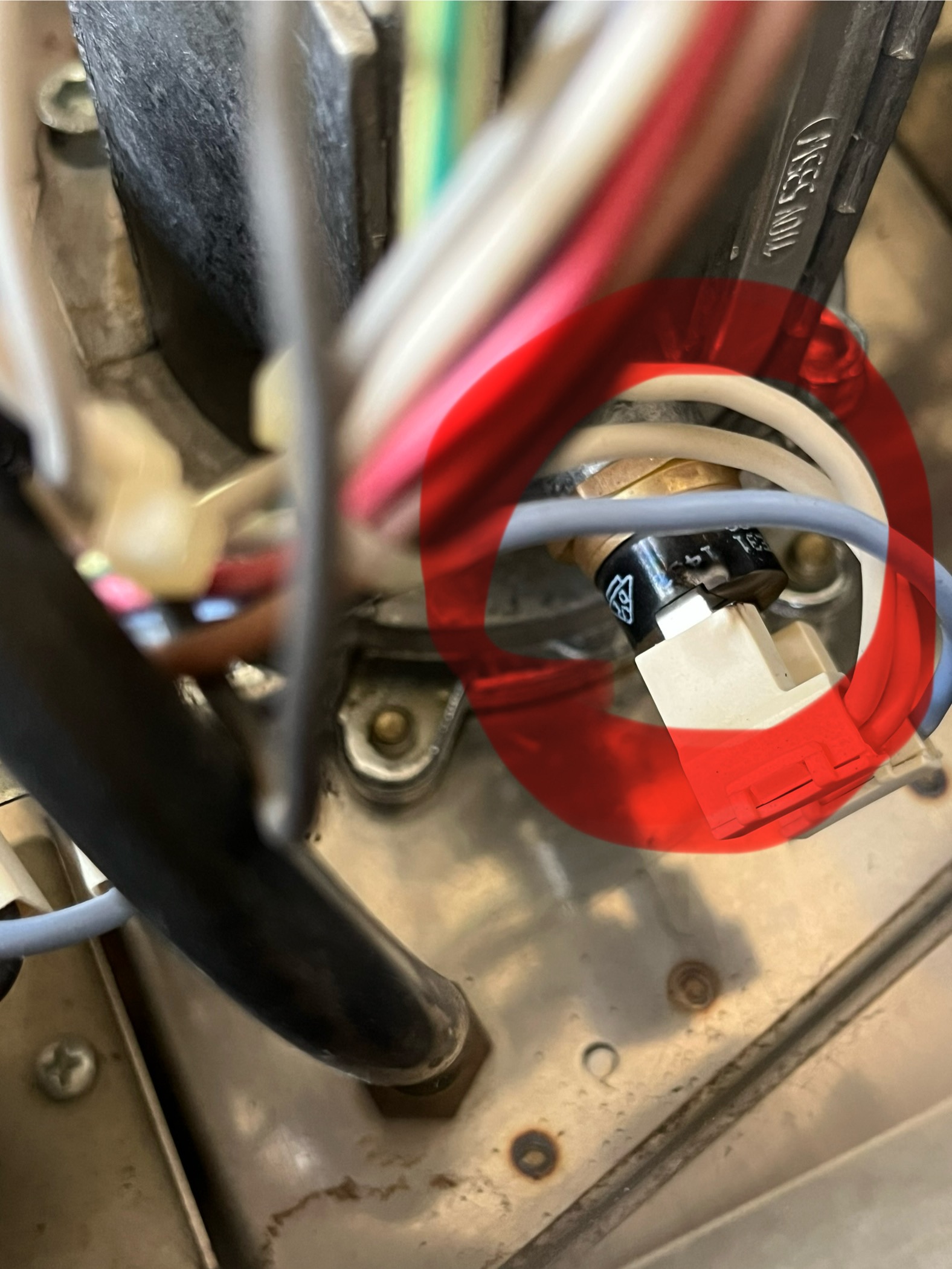

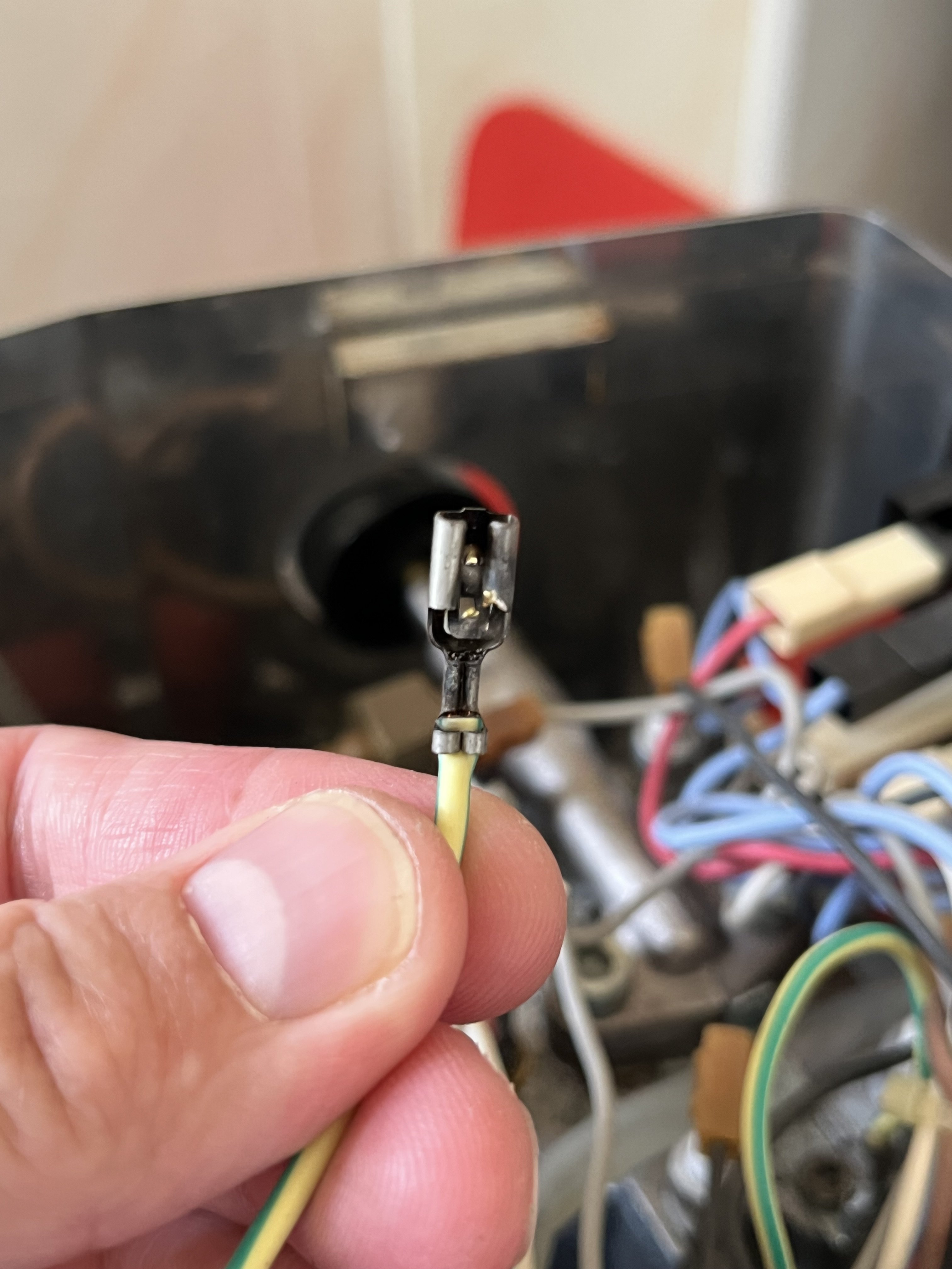

I thought my Classic had blown up in dramatic fashion this morning. I was pulling a shot and there was a big flash, a really loud bang inside the machine and the power in my flat.
I popped the lid earlier while the kids were watching a cartoon, just out of curiosity. Last weekend I replaced an O ring inside it and had disconnected the earth wire on the lid. Forgot to reconnect it… and it had found itself a nice source of high current to touch. Hence the flash and the big bang!
I’m calling that ‘got very lucky’. Reconnected it, lid back on and it all still appears to work fine.

You got lucky then! So it shorted on the thermostat?
Yes, I wasn’t sure what it was when I posted but it is the thermostat. I’m guessing it has full power running through it on this machine!
