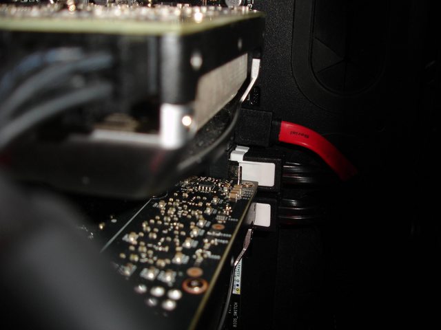

Long story short - if I move the new card into the slot above, it seems to be fine. In the red slot where the manual says I'm supposed to put it - it's unstable. I note that the card seems to be touching the SATA cables at the edge of the motherboard.
I've tested both cards individually in the top slot (no obstructions) and they both seem to work fine.
So, how can I get to the bottom of this? Seems to be it can either be:
1) Faulty PCI-E slot
2) SATA cable or other obstruction forcing card slightly out of socket/alignment
3) Metal contact on SATA connector shorting out on card?
Really lost for an explanation on this and I'm rapidly losing my patience with it all.
As a side note here's a couple of pics showing the clearance on the top card (:o) and that there is no obstruction on the right.
