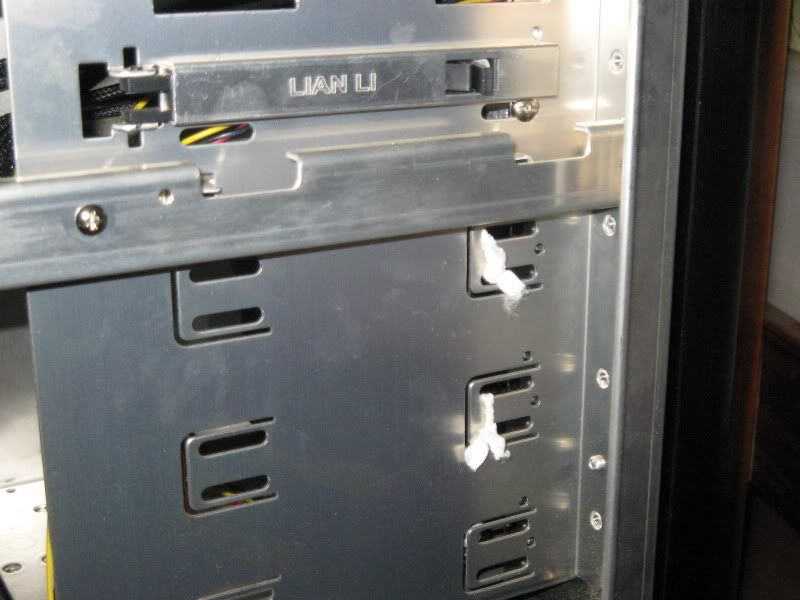

Done a bit of ghetto case modding tonight, added another intake fan into the 3 remaining 5.25 bays.
Held in place with sewing elastic.
Also hung a 120mm 1500 rpm fan behind the gpu's, cable tied to the atx power connector and suspended on a shoe lace, cards idling at 33-32c respectively, ran heaven bench and temps maxed at 79-76c, a drop of 6c on the top card from a previous run.
Ghetto gpu fan mod.
Should tide me over till i can afford a side panel with fan mounts, found a shop that stocks a window panel with dual 140mm fan mounts, costs £60.00 though.
