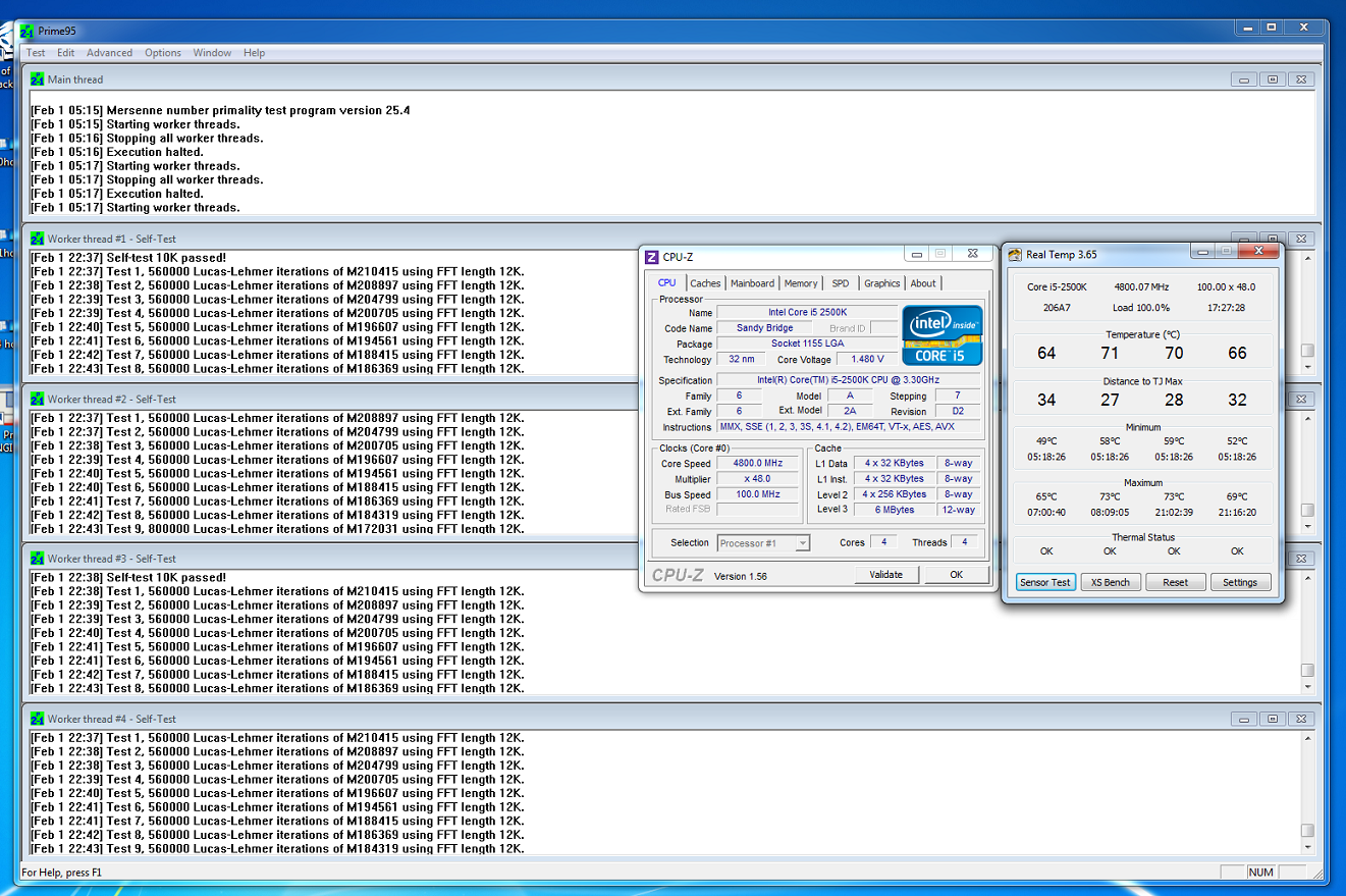

So, like a lot of you people on here, I've spent the last week or so tinkering with my new sandy bridge. I've been impressed by some of the crazy max overclocks (Hello 1Day) and even got upto 5.3ghz myself
Couldnt do much with it though after getting into windows, so I set upon the task of finding my maximum stable overclock:
Thats about 17 hours stable running prime, so 99% sure its good :D
Anyone else care to share their findings?
If so, could you try and show a similar screenshot so we can all compare temps and vaults at load please, showing at least a 10 hour prime session. The main thing I notice about mine is the fairly high voltage needed at load.
The temps are pretty good though thanks mainly to the 480 SR rad I have set up with a new EK supreme block. Cant help but thinking though that if I got a better chip, I could have a 5.2ghz or more stable overclock, due to the voltage/temp I'm getting now
Cheers

I've got my 2500K running at 4.8GHz Prime stable for 12hours.
Max temp was 65C on core 1 and idle temps are about 27C on all four cores. VCore is set to 1.325 in BIOS and is about 1.38 under load (can't remember exactly) and 1.344 idle in CPU-Z.

Looks like you're playing with fire with that VCore mind!
Yeah, its a little high. Like I said, its gotten me very tempted to take a punt and grab another one in the hope of getting a better chip, and seeing what I can do with my cooling

As for IBT, I did a 50 pass run at one point, and then started prime after that and it failed in under 15mins. So stuck with prime
