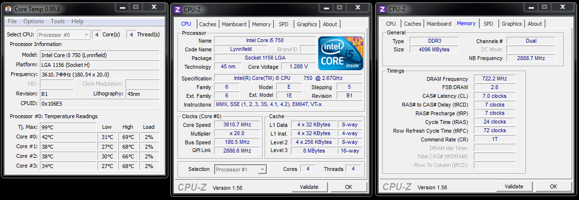

31 Dec 2010 at 13:27 #23 .Griff. .Griff. Soldato OP Joined 16 Apr 2004 Posts 3,892 Location Shropshire Another day.. Last night I overclocked it to 3.6ghz, completed 20 passes of IBT and Linx and left it running Prime 95 blend test overnight. Can someone check my temps and memory details in the screenshot below and tell me if it all looks ok?
31 Dec 2010 at 18:36 #24 mmj_uk mmj_uk Caporegime Joined 26 Dec 2003 Posts 25,692 All looks fine to me, if you hit another wall with memory try dropping the timings down to 8-8-8-24 as your current ones are quite aggressive. Glad you got it sorted.
