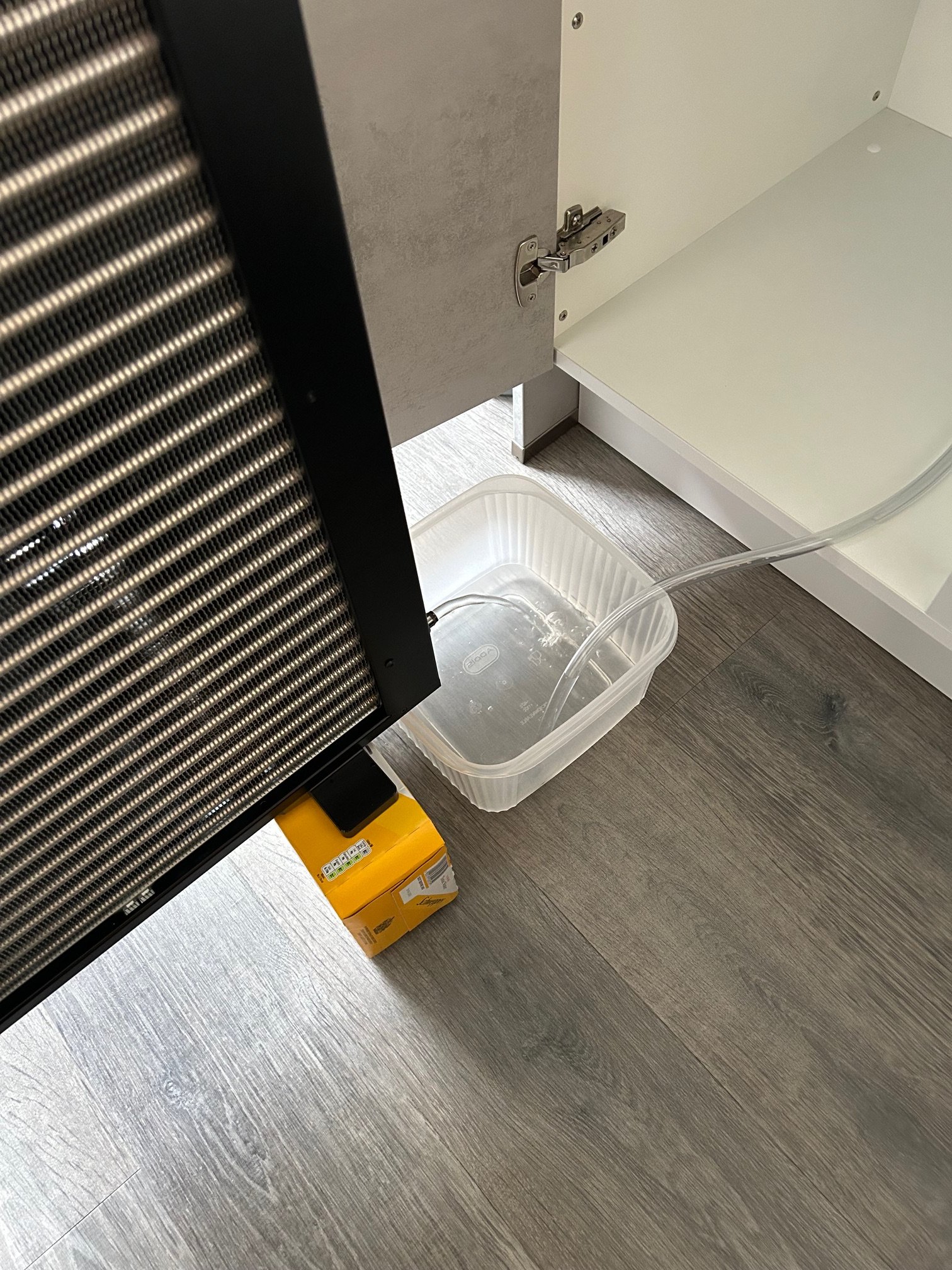

My cunning plan, tapped into the hot water, flushed it out for 15 mins (looked clean straight away, no evidence of anything in there).
One last flush through with a 5l of deionised and it's ready to go.
Did you get any flakes out of it at all? Maybe I'm cynical and the process has been improved but my one had a fair amount. Shaking it was key and diluted vinegar really helped. Although I don't envy you trying to shake the larger version!
Nothing at all, water wasn't even dirty with left over flux, so I'm pretty sure they must flush them before they leave the factory.
