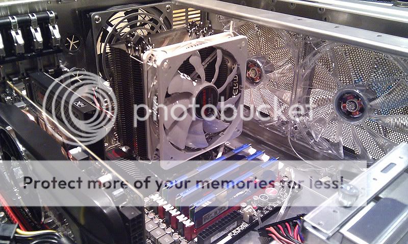

The King of Coolers
While your current cooler may well be running very cool & be a big improvement over your last cooler, I don't see how you can declare it "The King of Coolers" without having done extensive tests on lots of different coolers. I do however agree AS5 is very good, if not the best.
