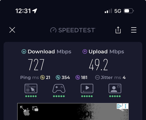

If i hold my iPhone on Smarty up to my office window this is the result. Its promising but I've read in this thread that Smarty doesn't allow for using data sims as home broadband replacement ?!

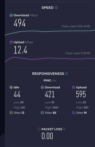

Finally getting round to trying to get a stable connection on a 5g sim (as in, no packet loss).
Changing from 3 to iD I noticed a general decline while tethering from a Poco F3, and then recently switching to a Pixel 10 it got even worse.
I've ended up with an outdoor ZTE Modem and indoor ZTE Router. Wasn't impressed with the performance given the cost of the hardware.
I've downloaded NetLimiter and capping both the upload and download speeds has helped tremendously, barely any packet loss now!
Thanks for the replies. Cadged, I did the availability check trick and it let me through. I haven't ordered but I did read about the outdoor router that you can install on the window. So I went to the other side of the house and put my phone on the window ledge :o
I'm going to head into the local 3 store today and show them this test and ask about availability. I'm nervous about ordering when its not actually available in the area.
Journey - If this doesn't work out I'd love to do that, thanks very much for the offer! Given that the connection seems stronger outside are antennas and internal routers preferred over outdoor routers ?

So the outdoor hub is up at the top of the house now and moving outside nearly doubled the upload speed via Ethernet cable connected straight to the Eero.
I'm very happy that Three and this outdoor package has saved us from terrible FTTC speeds. My cat5e cable takes it reliably downstairs and Wifi around the house seems to cut download speed to between 300 - 600 but I might put another Eero 6 downstairs eventually via the cable to see if that helps!
