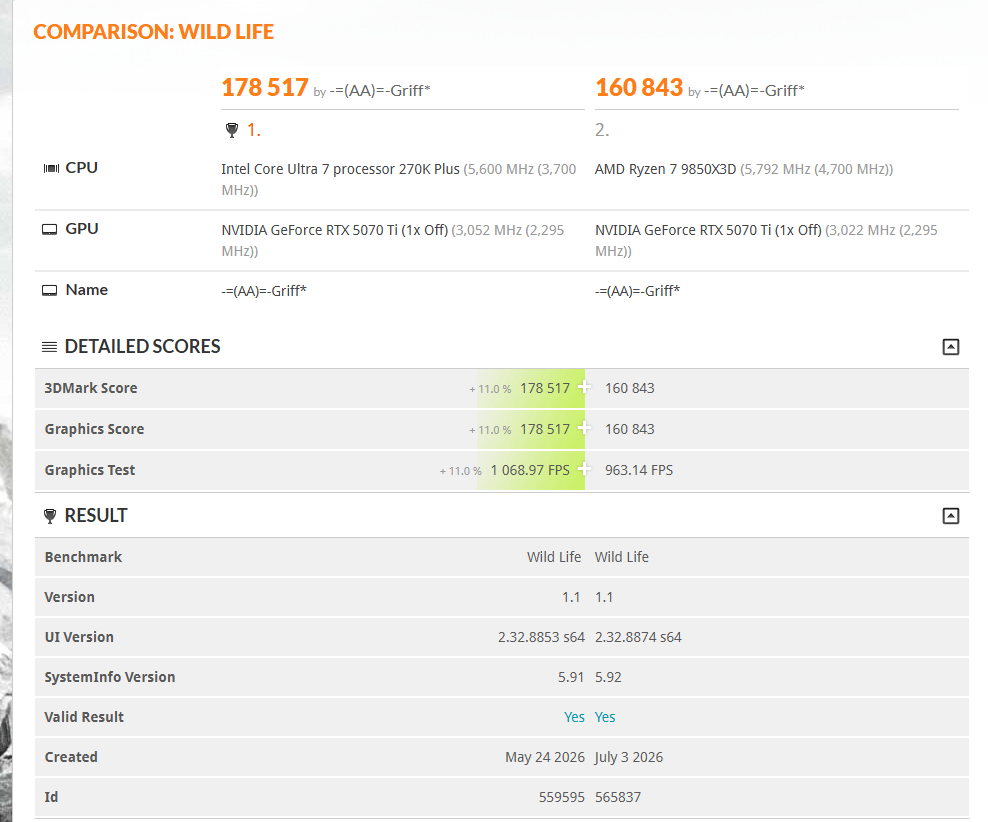

Wildlife is basically benchmarking which CPU can shovel lightweight frames at the GPU the fastest and is not leveraging the 3D v-cache at all. Games have a lot more going on.
I'd run an in-game benchmark at settings that a 5070Ti can easily handle to see what difference the AMD chip is making.

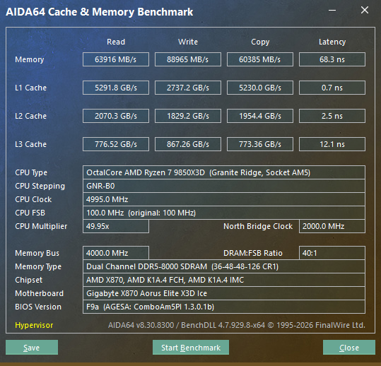

The RAM might be an issue? 8000 must have fairly grim timings? I'd have went for the 6000 speed DDR5, set EXPO and saved it.
Also check the EXPO settings are on in BIOS and not default ram speed.
the point I was making is the 18000 difference in score

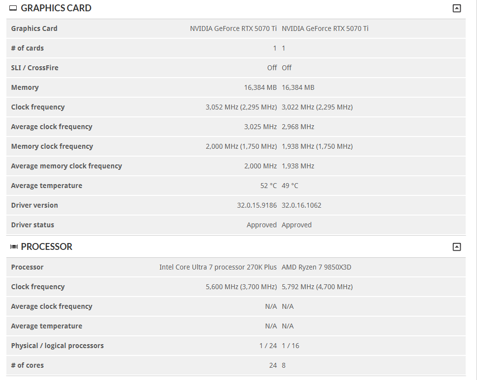

here is a few answers from the above posts
Yes it is a fresh install of windows
yes latest bios is installed
yes all latest drivers are installed and w11 is latest as well
yes expo is set in bios
temps during gaming is around 60c which is not bad seeing the temps out side ate the moment
GPU temps are around 60c as well.
Ram is running at 8000mts with these timings
does this info show anything I am missing
You already had good advice. Command rate. T1 Memory. Memory a 6200/6400 tightest timings with a 1-1 ratio.
