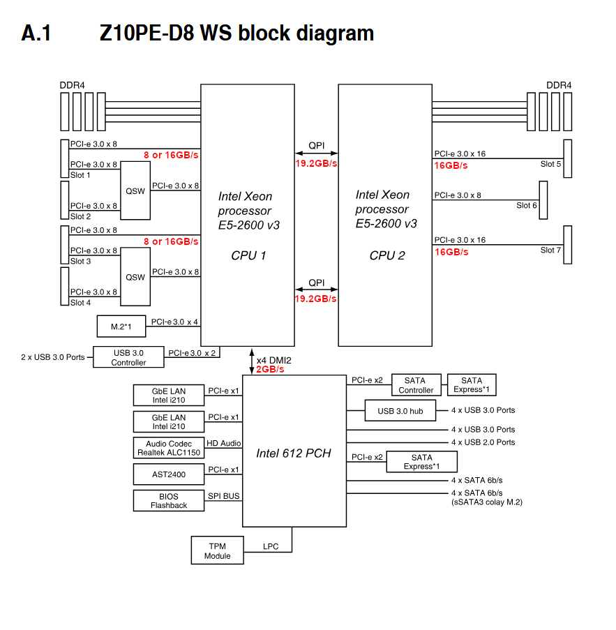

Thanks for this, I'll take a look into the NVlink and DMI between cards you mentioned (I don't know what either are currently).
My current viewpoint is that running 4x, and potentially 8x, V100's on the one board should be possible. It that not the case?
What is an Nvidia certified system?
So with a c612 chipset you have a total of 80 gen3 PCIE lanes, but these are split between CPUs 40 each and these have supply everything. In essence what you have is a pair of system liked by the DMI and all communication is over DMI which is painfully bad.
In performance terms linking two cards over 16 lanes of PCIE3 is like taking a trip from Edinburgh to Glasgow via the M25. Linking more than two cards is like doing the same trip via Paris.
DMI is completely irrelevant (until you are trying to link pools over ethernet) when talking about utilising V100 cards in a pooled configuration utilising SXM->PCI-e for GPUs off the direct CPU link it will utilise QPI - approx. 30GB/s each way.
Though you are right it is a poor substitution for a proper nvlink setup, but not as bad as you are making out.
It’s interesting how you can contradict yourself within the same paragraph. With these old Xeons you can never reach 30gb each way with this configuration. The maximum possible (theoretical) throughput would be 15 gig/s running 8x PCIE gen3 at 8 lanes.
No it’s not as bad as I’m making out, it’s actually much worse…

Think I'm right that you have 7 slots on that board - so running 8x cards would require messing about with SXM boards with integrated NVLink Lite - I think - a bit beyond my working knowledge when it comes to non-standard setups for NVLink.
When you have more than 4 GPUs connected some of those links will drop to 8x speed rather than full x16.

EDIT: I see what you are claiming though coming at it a weird way around (you are mixing up duplex speeds) - but that is still way better than the DMI limitation you were claiming.
You’re still not understanding the problem.
Where is the problem? (I may be wrong but off the top of my head NVLink for the kind of setup OP would be running is 25GB/s per card so it isn't terrible but still a long way from a proper NVLink setup).
Sure if linking more than two pairs like you originally mentioned then without NVLink you are in a world of pain but for 2 cards you still have a fairly direct performant setup and even 4 cards isn't that bad.
Though I'm pretty sure you got everything wrong here:
And thought the 2 CPUs were limited to DMI's 2GB/s interconnect.

I'm not sure what Jigger is on about - they got it sort of right, though exaggerated the issues, originally then just started muddling terms in.
You don't touch DMI and its limitations - if you want to scale beyond 4 cards you need either NVLink which I believe it limited to 6 GPUs on this setup or some funky NVLink Lite implementation which is outside of my knowledge. If you are building multiple systems then that is another story entirely.
