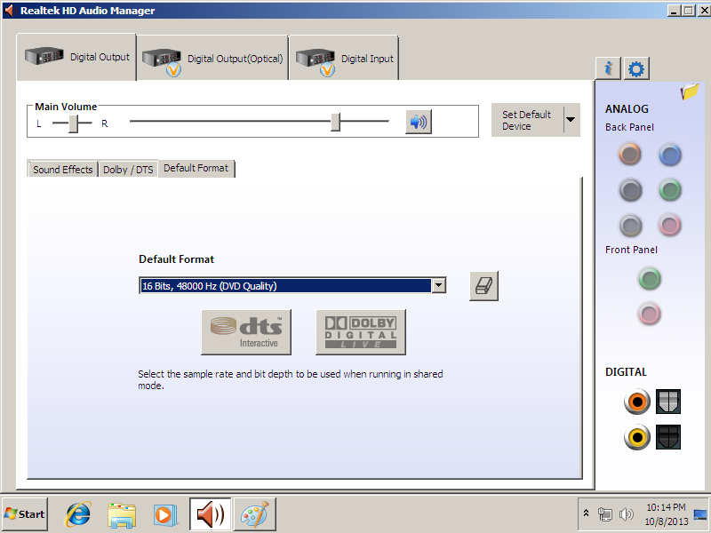

Thought I would share this here.
It fixed an issue for 5.1 over optical for me. As Optical with standard Realtek HD drivers only gives stereo sound.
Games / movies sound amazing now. Optical works and whatever the 5.1 source whether it's a game or movie it sounds amazing.
This will work on ANY Realtek HD Audio codec. (Edit: Excluding ALC2xx under Windows 7)
Check this thread for instructions, (Credit to the OP, thank you!)
http://www.techpowerup.com/forums/t...olby-digital-live-and-dts-interactive.193148/
I used the R2.75 driver pack from MeHelpful here > http://www33.zippyshare.com/v/72729438/file.html, instruction are included in the winrar file.

Just to update: this now works in Windows 10 :) I'm running the latest drivers and getting Dolby Digital Live for my Astro A50 headset. Thread here if anyone needs it: http://www.techpowerup.com/forums/t...gital-live-and-dts-interactive.193148/page-48
