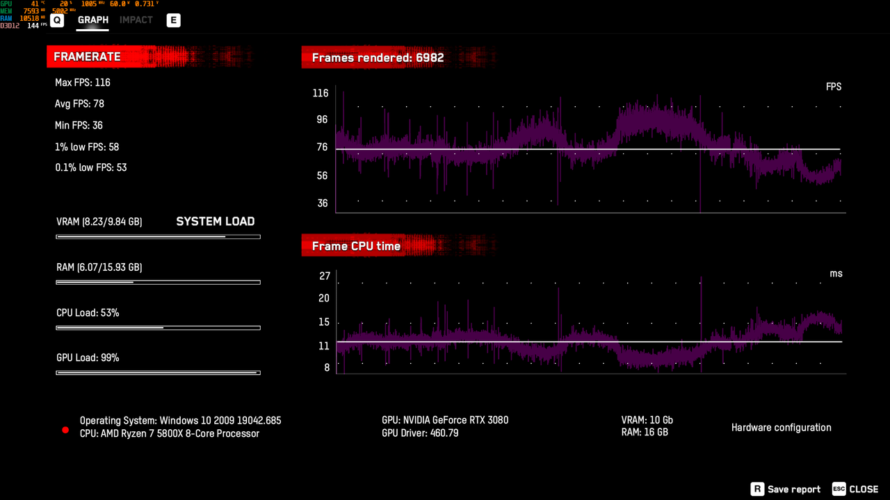

No, I do understand - fully. That's why I don't claim unoptimised when talking demanding, and why I have data to back it up. ;)
Far Cry 6 - easy peasy. You can see a single deviation on the frametime graph which is normal for open world games, it's just streaming stuttering most likely - hardly a big deal. The only other option is to have a very aggressive streaming like what Cyberpunk does but then you look at that compared to FC6 and you see clearly the nuked LOD transitions. So there's no free lunch, just a choice between compromises.
CP2077 - harder but doable. More consistent frametimes but as I said before that required a big sacrifice for LODs.
It really is as simple as people need better CPUs. If you're telling me you have a 10900K and are not seeing results like these then you might have to examine your setup, perhaps there's an issue with it and you're not aware of it. Could be working fine in most games but open worlds like these tend to expose problems that are otherwise dormant.
Might be completely missing your point here, what do these 720p res with RT on have to do with the OP running games @ 4K? Everyone knows that the lower the res the bigger the hit the cpu takes.
