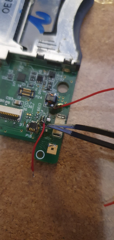

Took the DSi XL apart this evening and its worse than I thought. The charge port has pulled the pads off of the pcb, one seemed to have survived but is sort of hanging in place. So in prep for my new charge port ive run a few wires just to be sure. I'll wire those directly to the output pins on the new port and hope :D
There used to be a pad here:
It won't be pretty but it should work.
