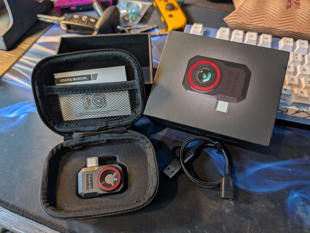

New toy!!!
My coffee was getting cold so used it to confirm... yep cold coffee!
