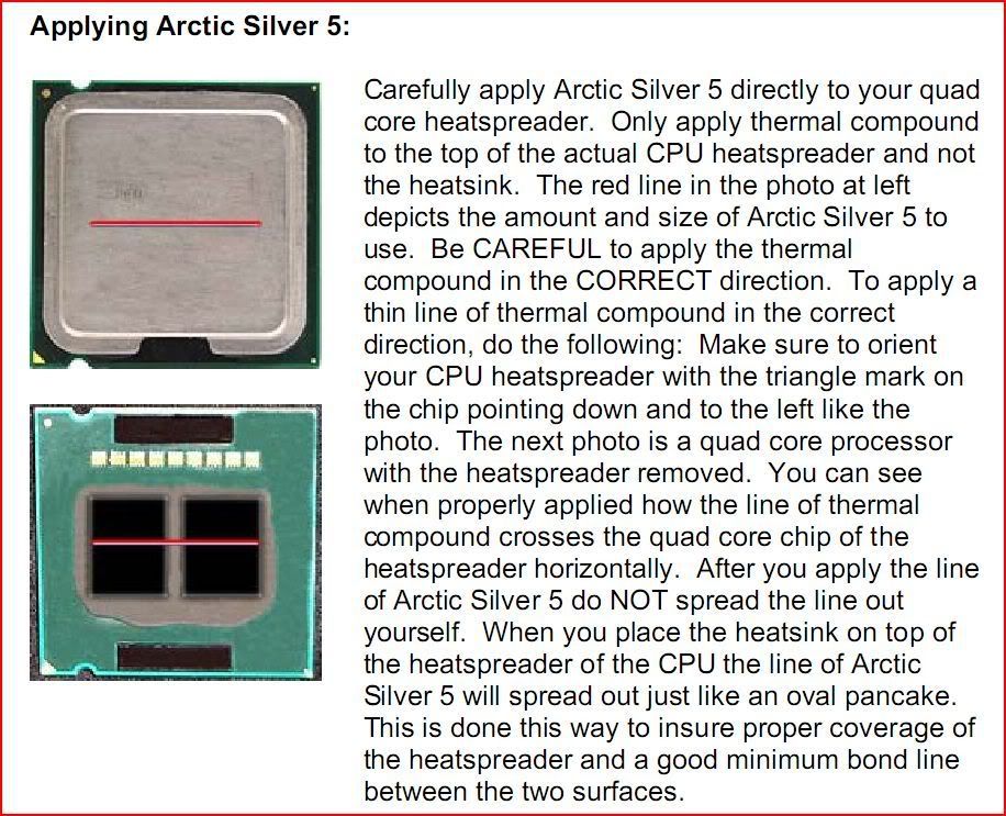

That's what I said isn't it? :p I always think of 60C as the most you'd want your CPU temp to go. 78C suggests the heatsink isn't seated properly or too much thermal paste has been used, something like that. Or simply that the temp reading is not accurate.
they say a pea sized amount should do the trick. a nice equal spread all over, rather then LOTS type of thing.
Pea sized? :eek:
For Arctic Silver, IIRC the recommended amount was a grain of rice (althought it's been a while since I built a machine). You really don't want it thick at all - the idea behind it is that the TIM just fills the small imperfections between the heatsink and the top of the CPU. Bare metal touching (i.e. the IHS and heatsink) is more conductive to heat than the TIM I believe.
EDIT: grain of rice sized *might* be the recommendation for the old AMD processors without the IHS (so a smaller surface area) - like I said, it's been a while :p
