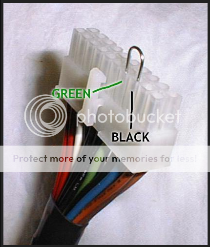

24 pin layout's have to be the same surley

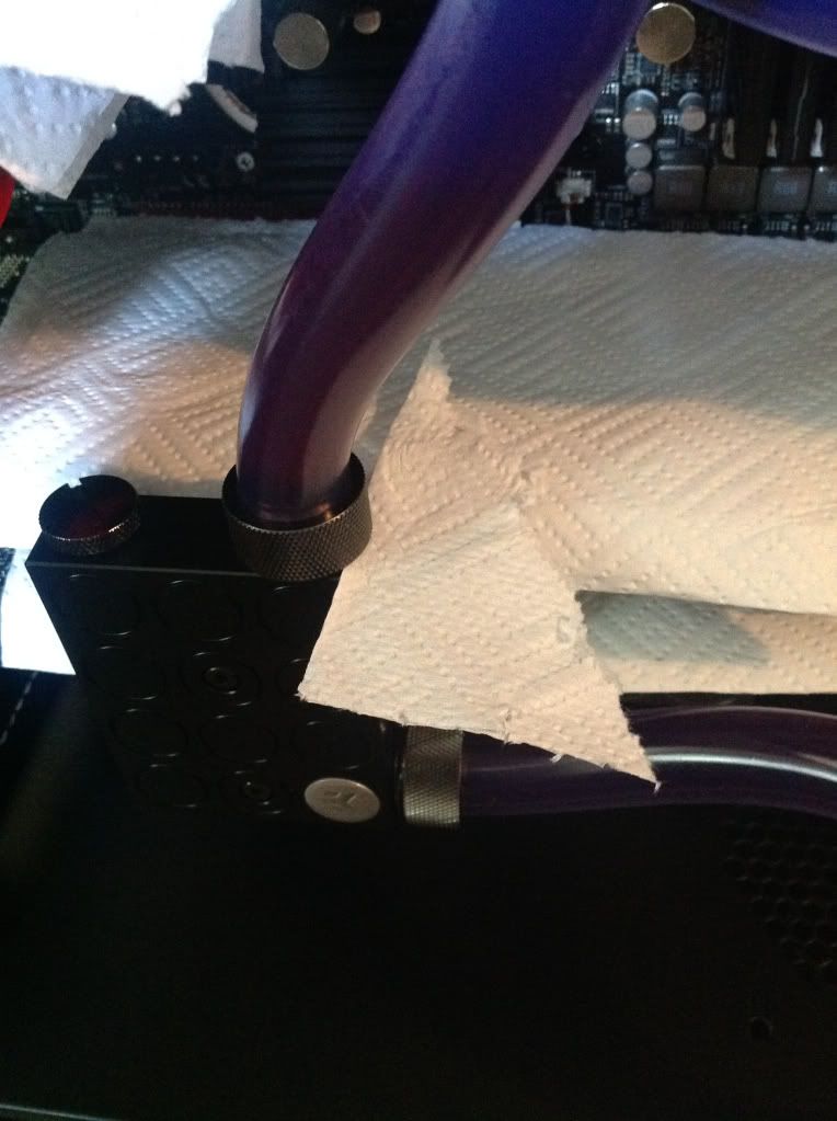

Top of the graphics card fitting , it's sorted now m8 1.5 of fluid is in :) none went on the graphics card :) just been gentley rocking the case. But it's looking good what pump speed you use? It's quite noisy :(

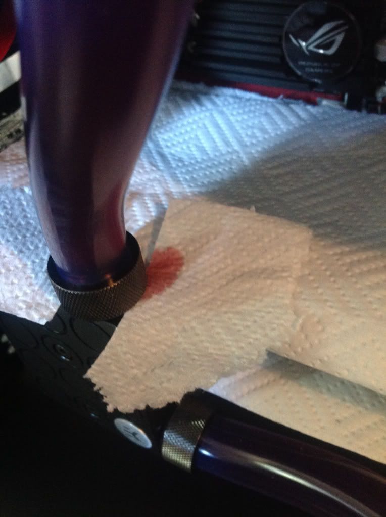

Still leaking a bit but not on the tissue just down the front of the bridge a little. Just under the compression fittings:( how should I go about it fixing it ???
It's pretty tight bit scared to undo the ring I case fluid comes rushing out. Everything else is fine :)
Done it up a little more just going to leave the pump running and keep checking. Then I can wirer everything else up and the fan controller once I'm 100% sure. Email? I can send pictures to you that way off my phone

Looks like a damaged O ring or you have threaded the fitting off centre somehow. I would drain to loop and have a look at the ring and see if you have the compression in straight. It would take a bit of effort to cross thread that tough stuff but something isnt right. Just check its not coming from where the tube seals in the barb and is running down to the joint
What's the best way to drain? And how? The compression fitting your saw in the picture are the ones I've used all over the case. I've been running it now for 20 minutes with tissue under the ring no fluid as of yet, I've tighten the ring so far so good. Or best to drain still?
If its stopped sounds like It might not have been tight enough. To be honest I would possibly drain it to make sure, but your call mate. To drain it snip your lowest tube over a bucket and drain it. When it stops free running out hold 1 end over the bucket and blow down the other half. You can then just replace the tube.
