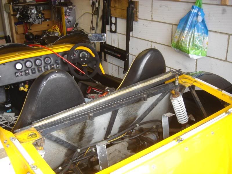

This is pretty much the first pic I took of the car.
It was a sound car, and in good condition for its age Stu said
It was running ok apart from a slight misfire...

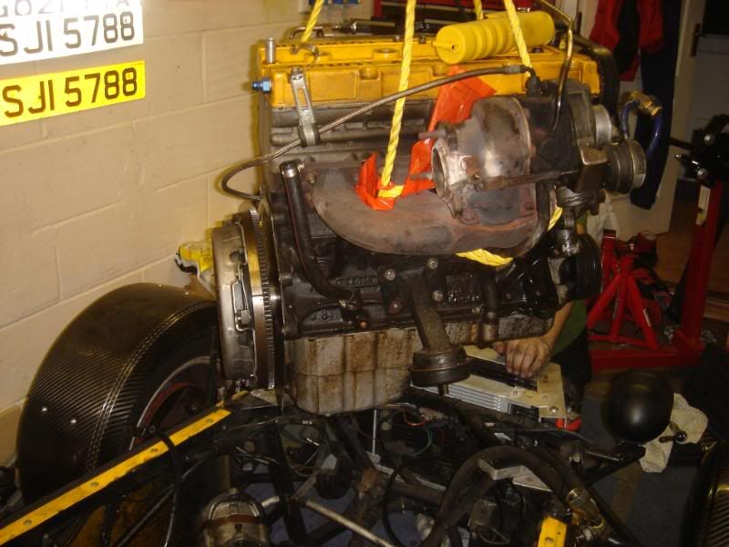

SOOO... the strip down commenced.
last ever pic of old spec!
maria and helen broke the boot lid at ND! :cry:
Box of bits started getting bigger....
found this is the coolant pipes? WTF?
Car had an electric water pump fitted... this is going in the bin. New Cossie one for mat lewis is replacing it!
overseeing the monkeys....
Head comes off tonight....
CROSS YOUR FINGERS GUYS AND GIRLS!!!!
Update!
Head is off! and its all looking good according to Stu.

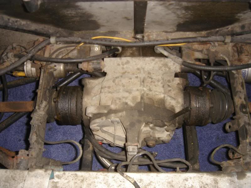

This is what is under the back of the boot when we pulled it out.

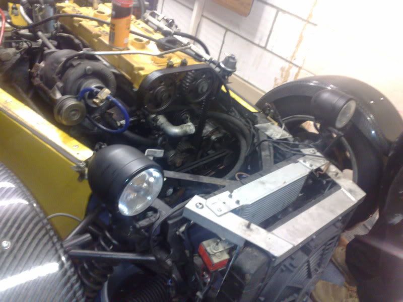

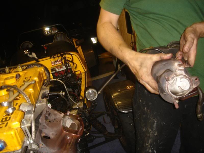

Taking off Chips new T3 Turbo for him!!!! :D (well undoing the ONE bolt that was holding in on :cry:)
Few small cracks on fannymold... anyone got a mint one?

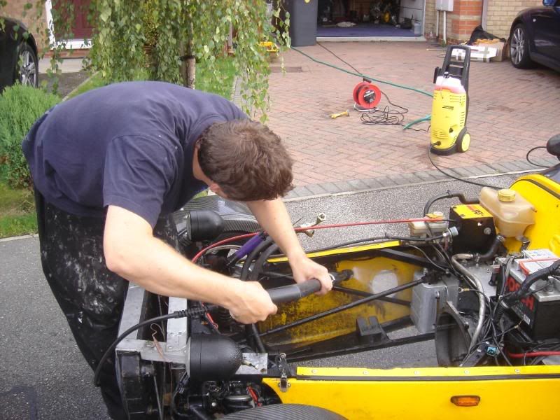

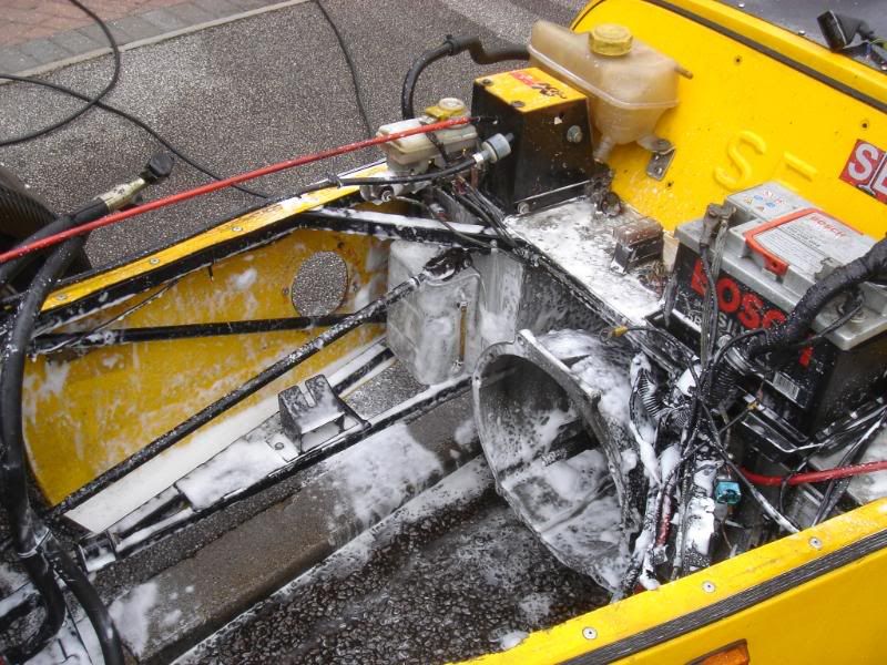

Lots of cleaning to be done in the engine bay and rear and so the car was wheeled outside and drenched in foam degreaser and I used a wheel brush to get in all the mucky bits! Stu reckons it was the dirtiest and greasiest engine and engine bay on any car he had ever seen!!!
Took him about 3 hours he said just to clean the block!!!
You can see how little car there actually is!!!!

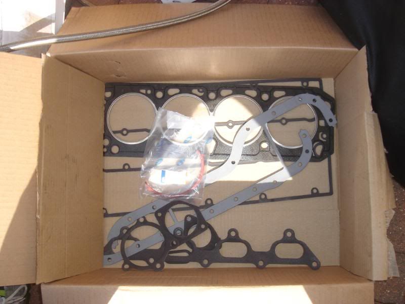

lots of cometic gaskets as well again from mat lewis. (AWESOME SERVICE!!!) ... some were already on the engine!

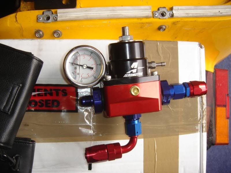

also for the new fuel system, treated yorik to an ubercool fuel reg. Its not just bling either... Maria and mum are going to be driving this... so NO corners are being cut on the fuel system and no old parts are being used. Seen enough old cossies and old kit cars go up in flames and its NOT gonna happen to this!!!

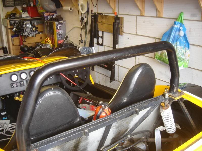

Trial fitted the new roll bar hoop.... LOOKS ****!! but much safer... it has other bars to add as well....
old... super cool looking... but totally useless in a crash!!!
:cry:
none!!!
new (half of it)

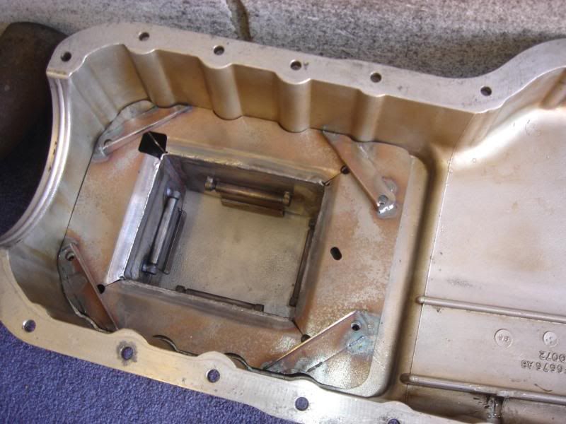

Stu also got me this supercool gated sump.... no oil surge for yorik!!!

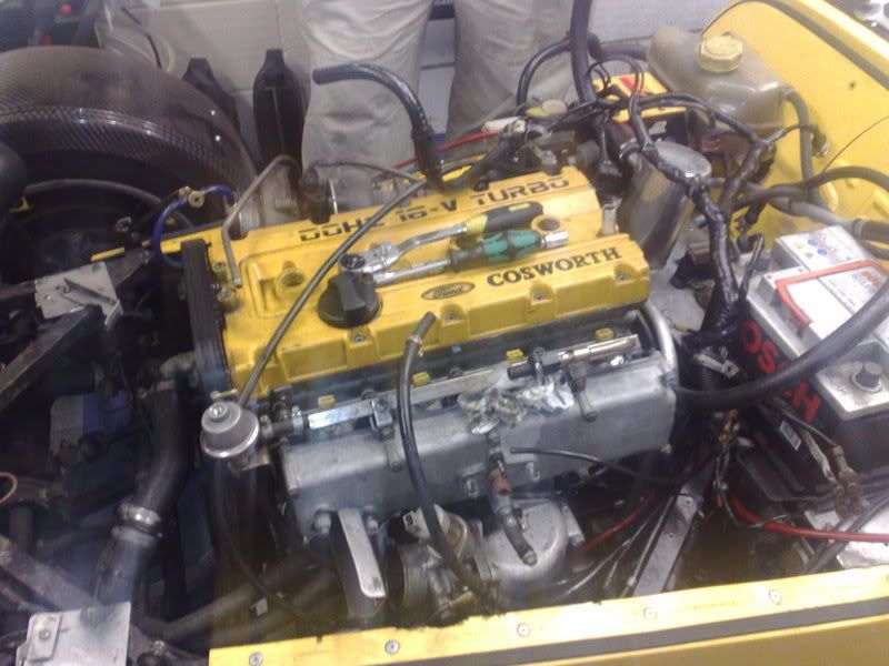

The engine was now also going back together. New bigends, the tiniest head skim, and some pocketed pistons was all we went for (thanks to slim boy steve, amazing price and quick service)
Stu has a bufty obsession and wants to be a professional engine dresser and flower arranger when he grows up.... so bufty shiny hex bolts were used with cometic gaskets and all the pulleys and washers were sprayed :cry: It was starting to look cool though... oh and stu used these washers that apparently Mountune use and they mean things wont ever come undone
New Tensioner going on... and JUST in time! the old one was ****ED and about to fail and detroy the engine!!! We think that was the squeaking shreaking noise at National day that we put down to an alternator bearing before!!! :cry:
Stu checking the Chips Cambelt job! as it went on FAR too easily.... NEITHER of them wanted to put this on as they BOTH get the willys doing it on other peoples engine apparently :cry: POOFS ;)

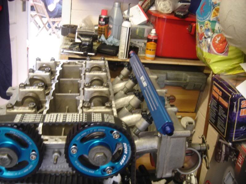

Reassembled and with the funky Reyland Billet Fuel and Siemens injectors and new Piper verniers that Mat Lewis sent by accident but that I was never going to be able to resist hahahah ... (GREAT sales technique Mat!)
Just needs some of those cool Reyland Pulley bolts! please send Martoooon! :D
Also fitted was a new 4x4 TPS as we are going to L8 with MSD coil pack conversion.... for reliability as well as performance. Seemed silly not to fit a new Ryan loom as well to really make sure things are bulletproof. Sadly Ryan is on holidays! but CossieRich came to the rescue and Chip and him ripped the one out of his saff for me!!!
Apparently it went into the Westy REALLY easily ;-) NOT! took about four hours of blood sweat and tears and the Westy was almost chopped up with an axe at one point I hear! but at 3am... it was done! THANKS CHAPS! :god:

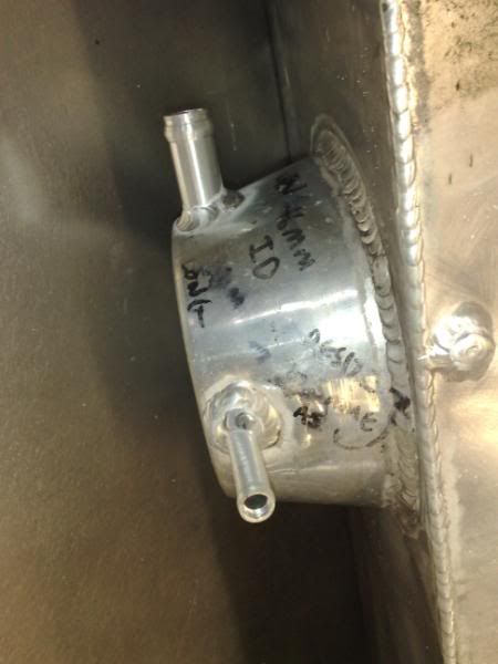

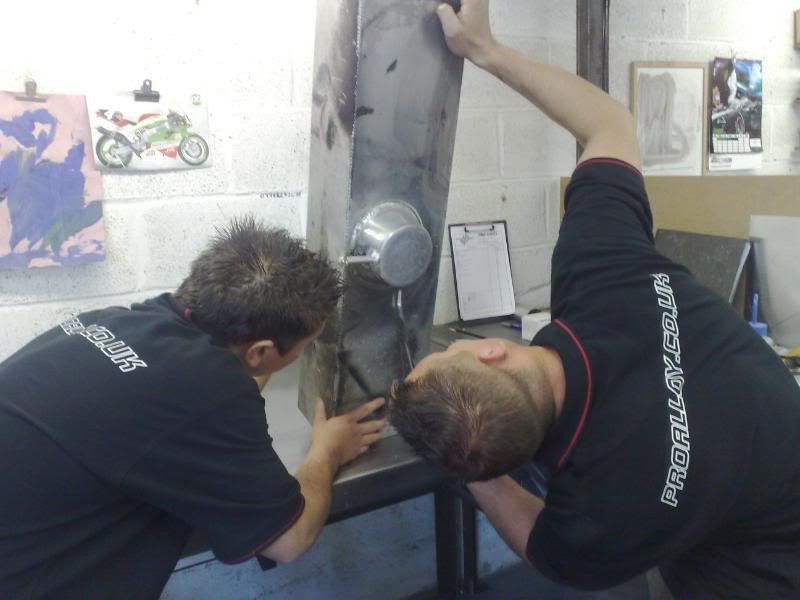

This also meant that the fuel tank collecter would needed to be modded as the outlet and return were now in the wrong place...

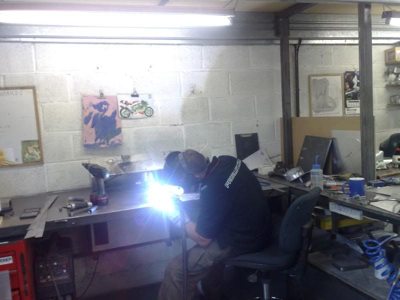

Quick call and with the promise of cakes and boobs Wayne at Proalloy would mod the tank whilst we waited! Legend!!!

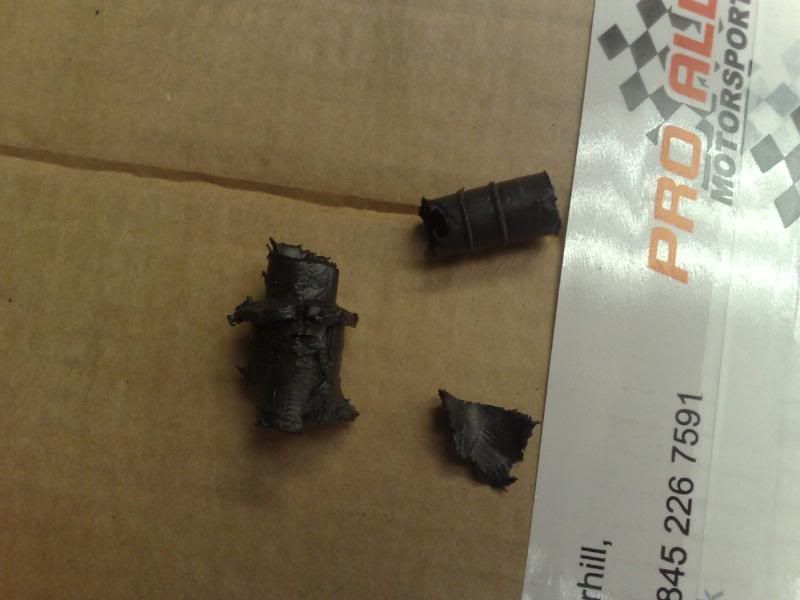

When we got there though Chris at PAlloy noticed that there was something rattling around inside the tank and was not happy with it.... and proceded to get it out!!!
this was pulled out eventually!!! :cry:
Then Chris started deciphering Stus scribbles on the tank and got to work modding it!
all done...
He then got to work making a little pipe stu wanted fabricated for the new water system he was planning on fitting.
wicked final result. Wish I could make stuff this cool in about 2 mins!!!! :eek:
Thanks to Wayne and Chris at Proalloy for super service!!!

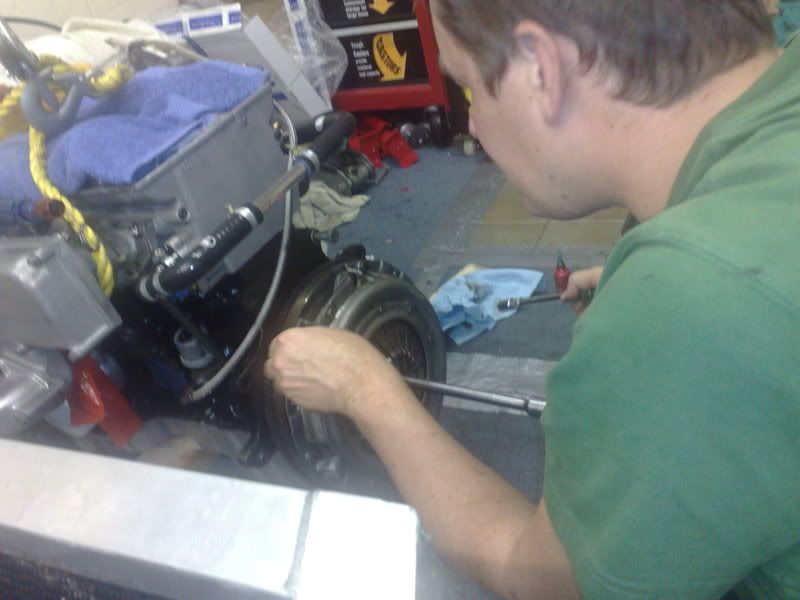

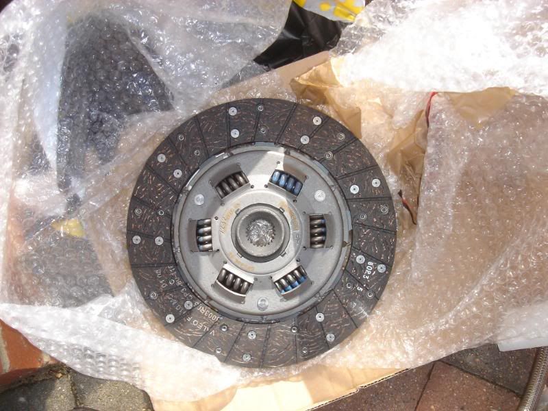

Chip talked me out of my brand new unfitted AP organic....
into a new AP 6 paddle :cry:

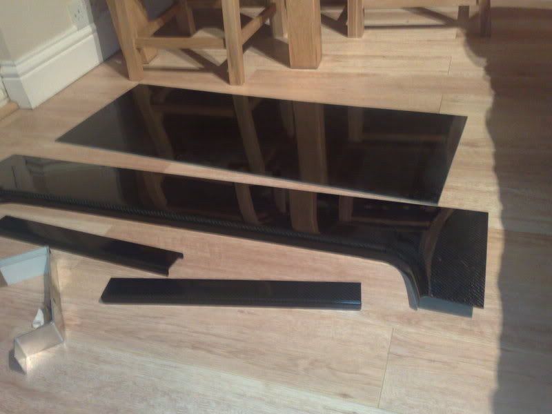

Stu convinced me that I needed some Yorik needed some Carbon fibre.... so new door top, new dashboard and boot arrived... oh and new fuel tank straps

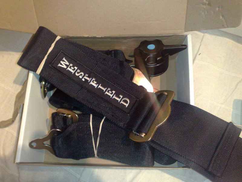

also some more new Harnesses arrived.... as a pressie for Stu! as a thanks for all the blood sweat and tears he is putting in! Thanks mate :smack:

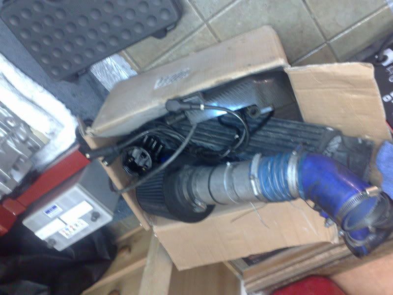

INTERCOOLER FOUND AT MY MUMS!!!
It was disguised as a Bosch pressure washer :oops:
MASSIVE THANKS TO DIVA!!
Its now a PROPER project!!! Diva is involved!!! let me know how much I owe you mate!!!
ITS IN AMAZING CONDITION!!! :god:

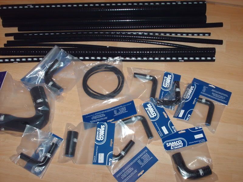

Also arrived at my mums today... was 'some' Samco hoses Stu ordered to do the cars water and boost systems with...
I 'think' he has it all covered!!! JESUS H CHRIST STUUU!!!! I am sure he is also going to plumb in his uber cool porn bath with this!!!
Colour chosen my Maria :cry: I wanted yellow... stu wanted blue... guess who got her own way!!!
ENORMOUS thanks to Renton for helping finalise the order and liasing with Samco to make sure it was made THAT DAY! and arrived superfast!!!

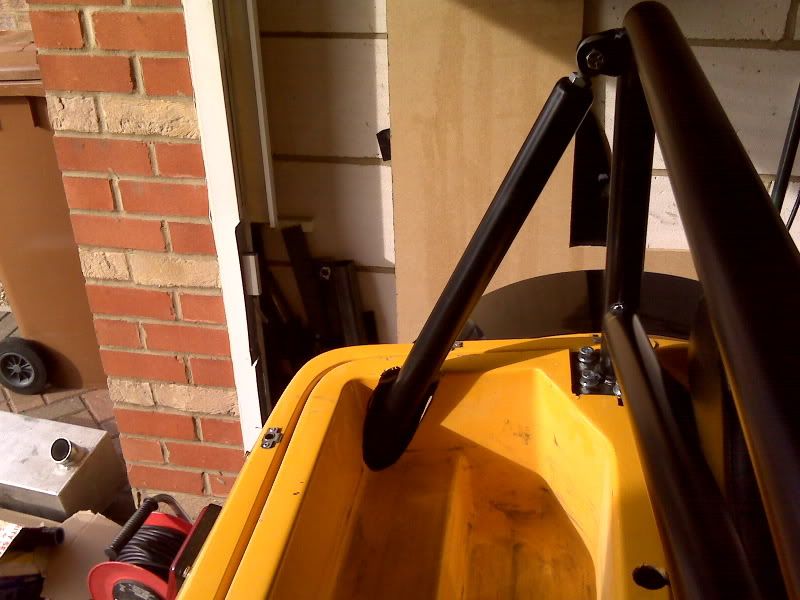

with fuel tank in, stu could then bolt the new RAC roll bar in properly.
He also modded the boot so I could still use it. (Thanks mate, I know it took ages!)

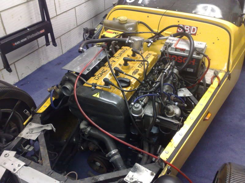

above you can also see the new Samcos starting to go on as Stu is making a whole new water system

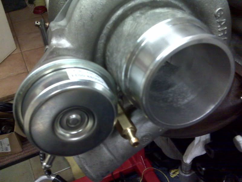

Got a brand spanking T34.63 to go on it... sweeeet
JUST NEED THE CAMCOVER BACK!!! hurry up Rainbum!!!!!
Update...
AP paddle clutch (thanks Rainbum!, super service) is getting fiitted..
with that on Stu gets to use his favourite toy.... no not the multi speed rampant rabbit deluxe turbo! but his electric engine crane...
I had to leave before it was all bolted up... and the mounts fitted! but it is now!!!
THANKS STU!!! YOU ARE A PROPER LEGEND!!! IT WILL NOT BE FORGOTTEN MATE :hug:
