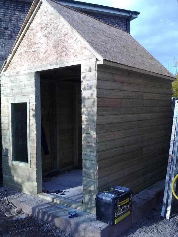

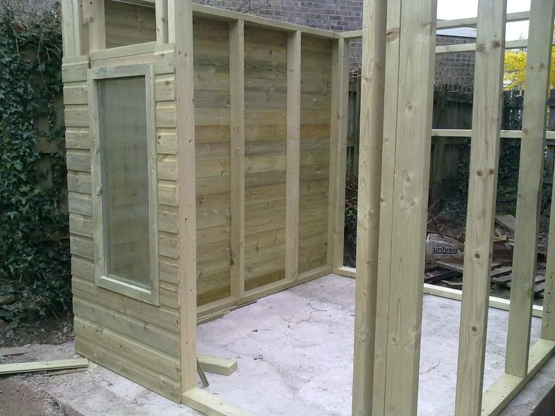

Here is a shed me and mate built from scratch last year on a base, granted it was easier because we had slabs to build on but could get the same base with hardcore/rubble to keep things level and such.
Edit: Sadly I don't have a picture of the completed thing. :)
That is one strong base! Looks great.
