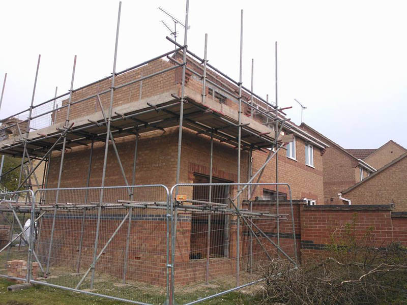

The work finally started a few weeks back and I thought I'd share the progress here is anyone is interested. The plan is to extend two of the bedroom upstairs and create a second living space downstairs.

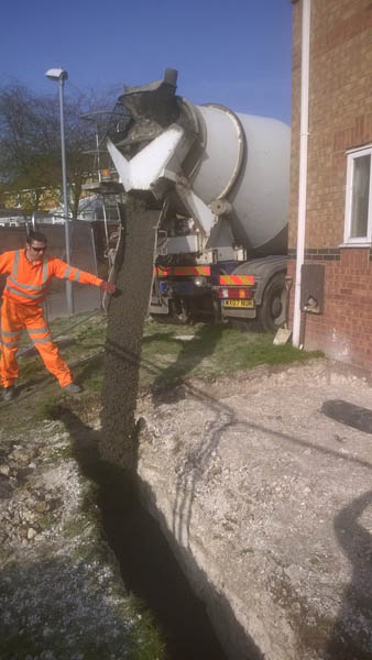

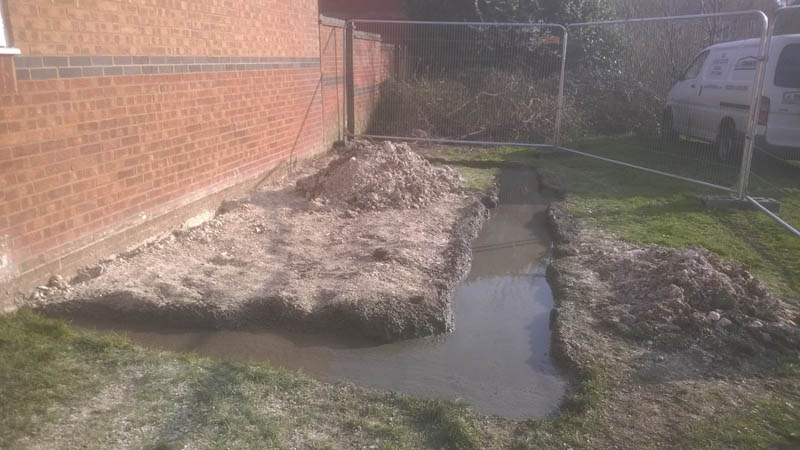

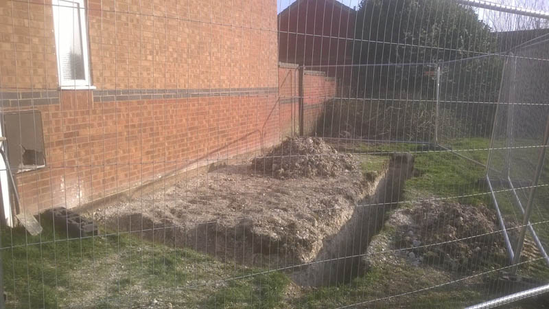

Foundations dug & poured

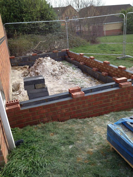

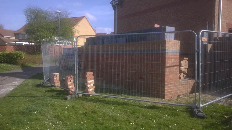

Brickwork started

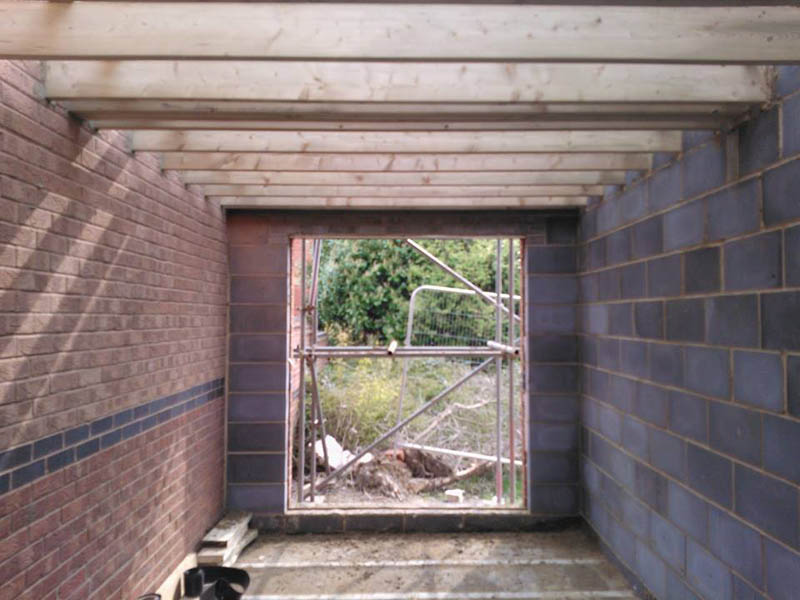

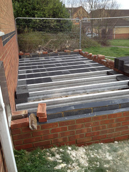

Suspended concrete/block floor
Taking shape

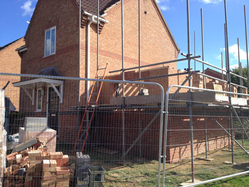

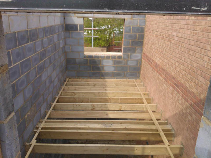

Ground floor brick work complete and 1st floor joists in
1st floor brick work underway and beginning to look like the plan
Rear
Ground floor
1st floor

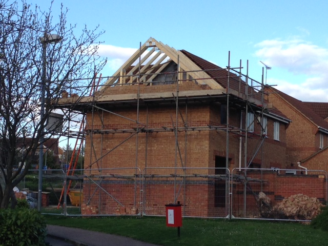

Still so much to do with next step being the roof going on this week but really pleased with progress so far. :)

How deep are those foundations?! :eek:
1.5m iirc and the building inspector was questioning whether we needed to go to 1.8m, which made us smile seeing as the house itself is only sat on 0.4m.
That must be some crap ground the buildings on! Most buildings I've dealt with either have 150mm or 200mm strip rounds with a layer of mesh, two in extreme cases. Only real time we need more is for large industrial buildings or pad foundations under columns.
If you are on clay (and Greater London mostly is) and you have trees nearby (as far as 20-25m away even), you are suceptible to the clay swelling/shrinking due to the trees' water demand. So regardless of ground quality, you have to found at very deep levels so that your foundations are unaffected.
I am putting 2.5m deep ones at the moment on some projects, despite the originals being around 0.7m. The alternative are mini piles. The building Inspector is right to suggest it if it hadn't been considered because they tend to learn the soil profile of their geographical area well.
If your property is partly sat on 0.4m footings, and 1.8m elsewhere, expect some cracking in the finishes at the joint, so make sure the detailing ais good. Soil is stronger further down you go, so the the deeper you found, the less settlement there will be.
(limited to 25mm usually).
Some estates are notorious for shallow underdesigned foundations, and then homeowners wonder why cracks appear around doors and windows.

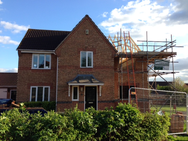

Good to see your using attic trusses, so much space usually goes to waste, shame more people don't use them when building extensions if practical, & also when building houses.
Well planned, great when thought goes in to an extension, balances the house nicely at the front.
Some extensions are like a carbuncle, oversize for the plot, & badly designed.
That was part of the delay last week, A frames were being cut with standard V trusses so had to cancel and re-order with attic trusses.
Intention is the loft will be used as a storage room (via pull down ladder access) for home tech equipment and non-seasonal clothes. Also allows us to consider converting at a later date to an inhabitable room without major structural work.

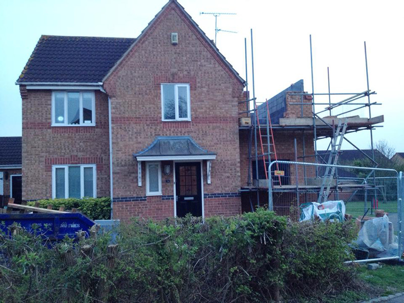

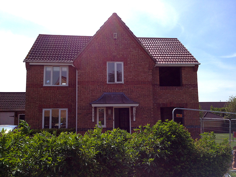

Busy couple of weeks, I won't post loads of pics but updates to date:-
  • Gable wall block and brick work completed.
  • Roof tiled and cemented.
  • Fascia board and guttering up.
  • All original outer brick work from side wall removed.
  • Block work removed between old and new loft.
  • 1st floor in.
  • 1st floor partition wall installed.
  • 1st floor partially plastered (walls/ceiling).
This gets us to here:-
Next week should see the windows and doors installed, 1 fix plumbing and electrical, whole load of stuff in the garden (clearing shrubbery and existing permitter brick wall, preping for new drive way) then the real fun starts the following week when we knock through. :eek:
