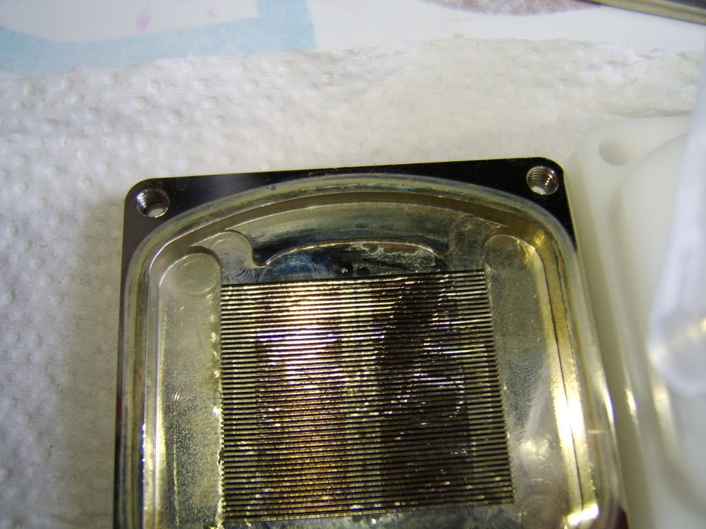

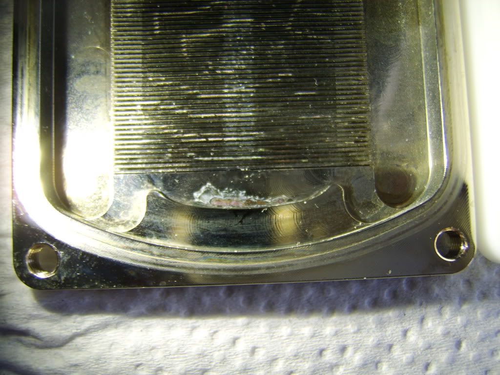

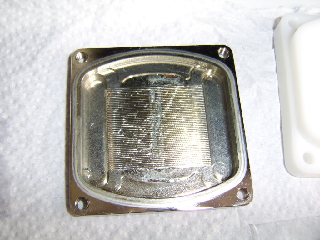

After a clean with water an a brush - close ups of the top and bottom
Dear ek Support
I recently removed my ek Supreme from my loop to replace my stock plexi top with an acetal one (oval shape purchased for the ek shop)
Only to find two areas of corrision under the injection plate (see images below and attached)

And after cleaning with water and a toothbrush

That line of grey "gunk" running across the middle of the block, perpenciular to the grooves, i.e. where the jet plate slits are, was that definately metalic plating residue?
My opinion on this nickel plating issue has always been "so what if it corrodes, it is only exposing copper which is not going to affect the performance of the block, and you can't see it anyway if the block top is not plexi". I personally always assumed that if the plating did go that it would either "dissolve" or be so small that it says suspended in the fluid. *BUT* if your experience is that that grey stuff is solely made of nickel bits then it does put a different complexion on things, as it appears the bits are big enough to form a blockage.
So could you tell if it was just nickel or something else mixed in with it, or some other gunk in the system?
The gray line must have at lease 20% gunk in it - metal doesn't just clump together in my limited experance - AS5 is a 88% metal paste, the rest is oils and binders.
This may be dead algee/bacteria, plasticizer, mineral salts
Was using de ionised and a silver coil - so a very mild acid getting stronger over time
It didn't dissolve - makes a very nice silver speck cloud coolant
simular in look mayhems Aurora - but without any of the benifits.
