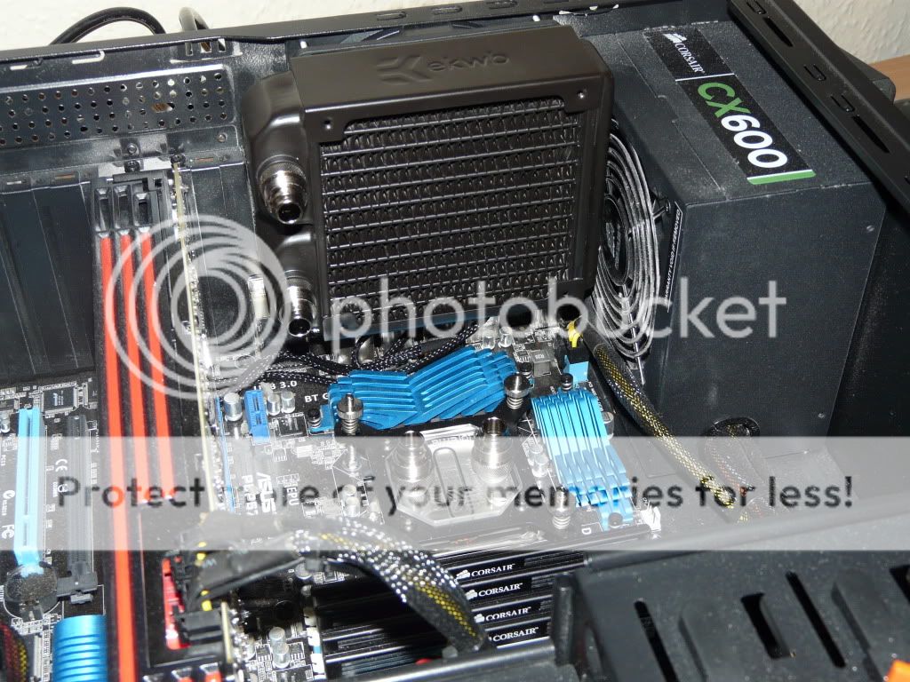

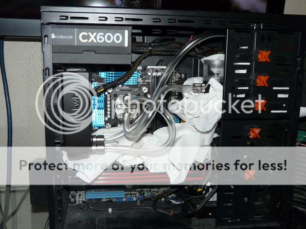

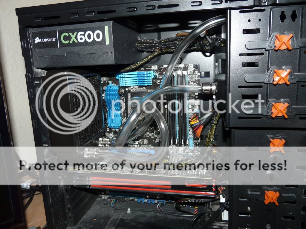

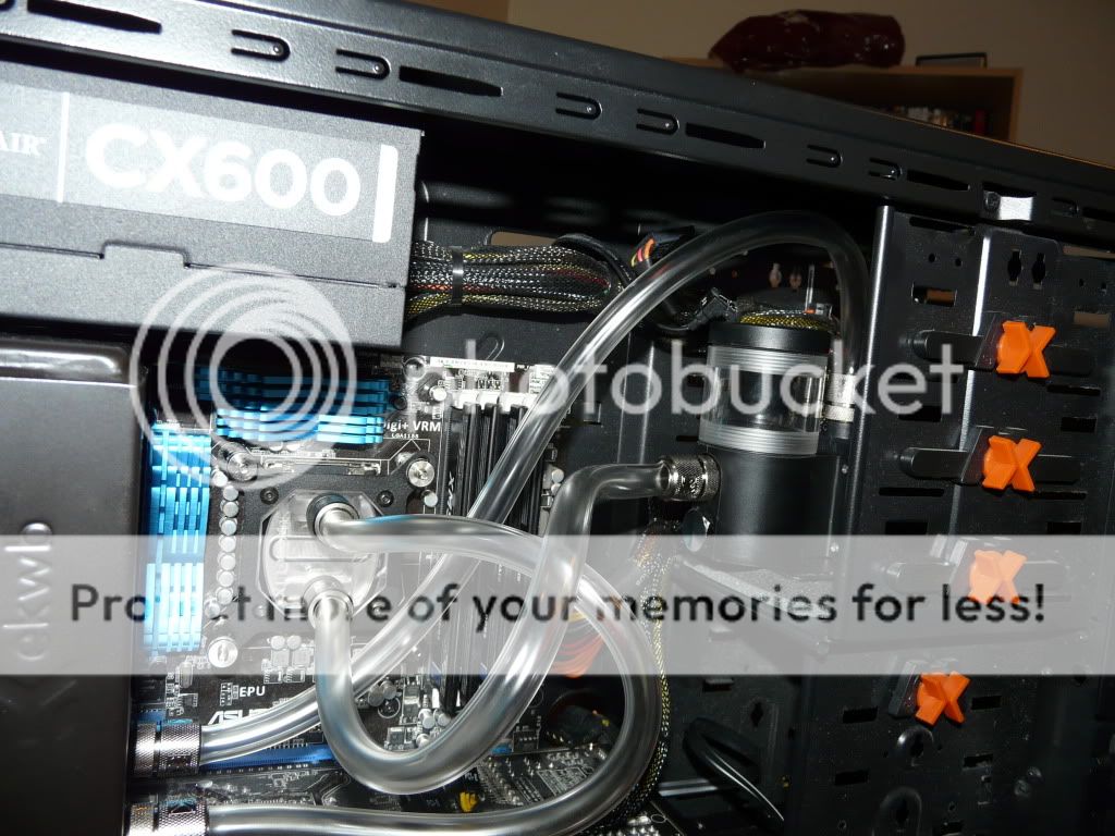

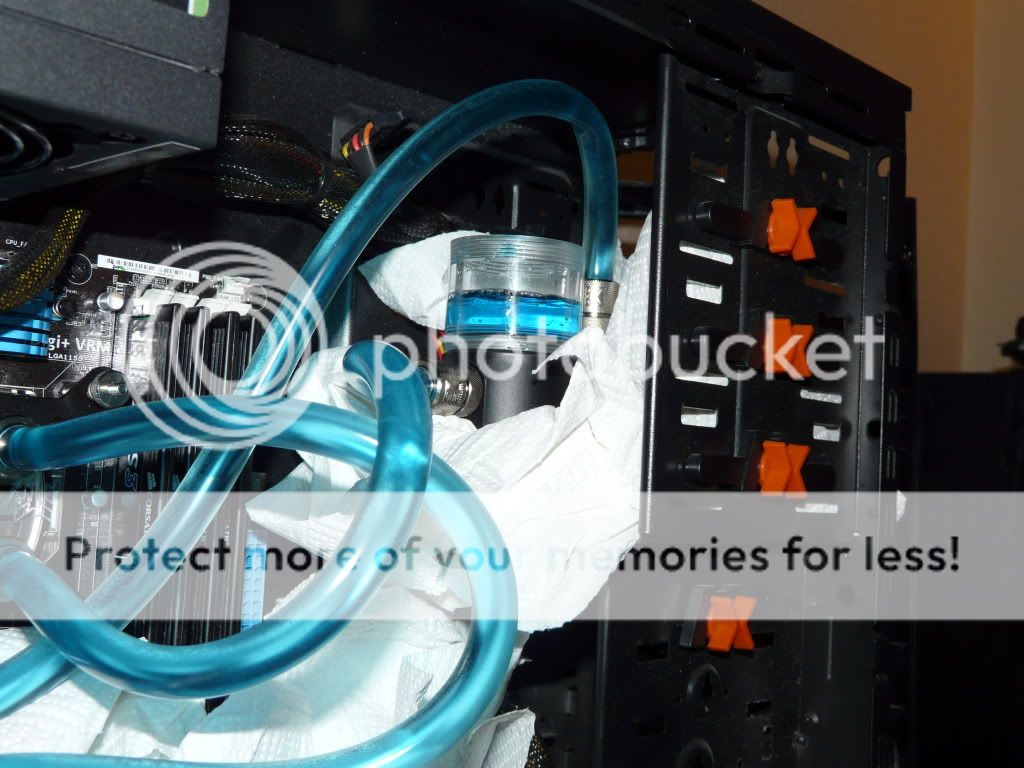

1st time i have touched a water cooling kit, thought i'd show some images, might help some people.

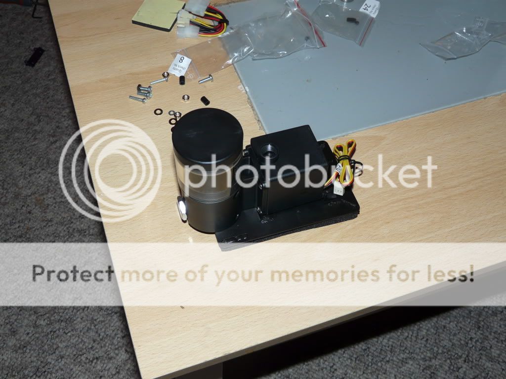

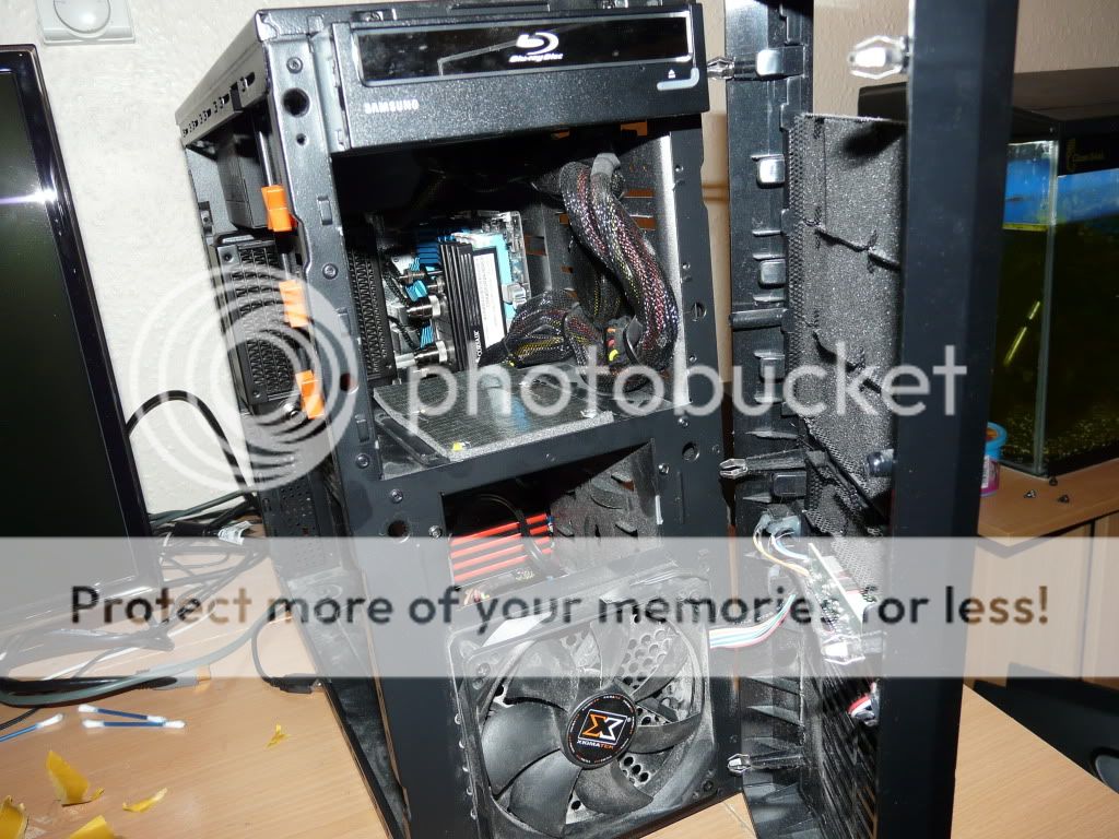

As you may ahave noticed i repositioned the pump this was because i couldn't fit my Blu-Ray player back in without a big kink in the pipe so i moved it forward on the bracked and cable tied it a lot less fiddly than then screws and bolts.
regards
Guy
Ps while i think of it, before i installed i had a fan at back and rear, the front dragging air in and the rear pumping it out. Now i have the rad installed the fan on the rear has to be dragging it in which i have done with the included fan. Should i turn the fan round on the front of my system to pump the air out as isn't the air fighting each other, it does seem warm in my case.
Thanks
Very impressive for your first attempt :D
a few minor comments

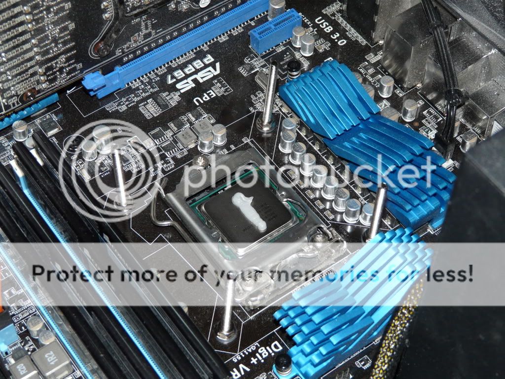

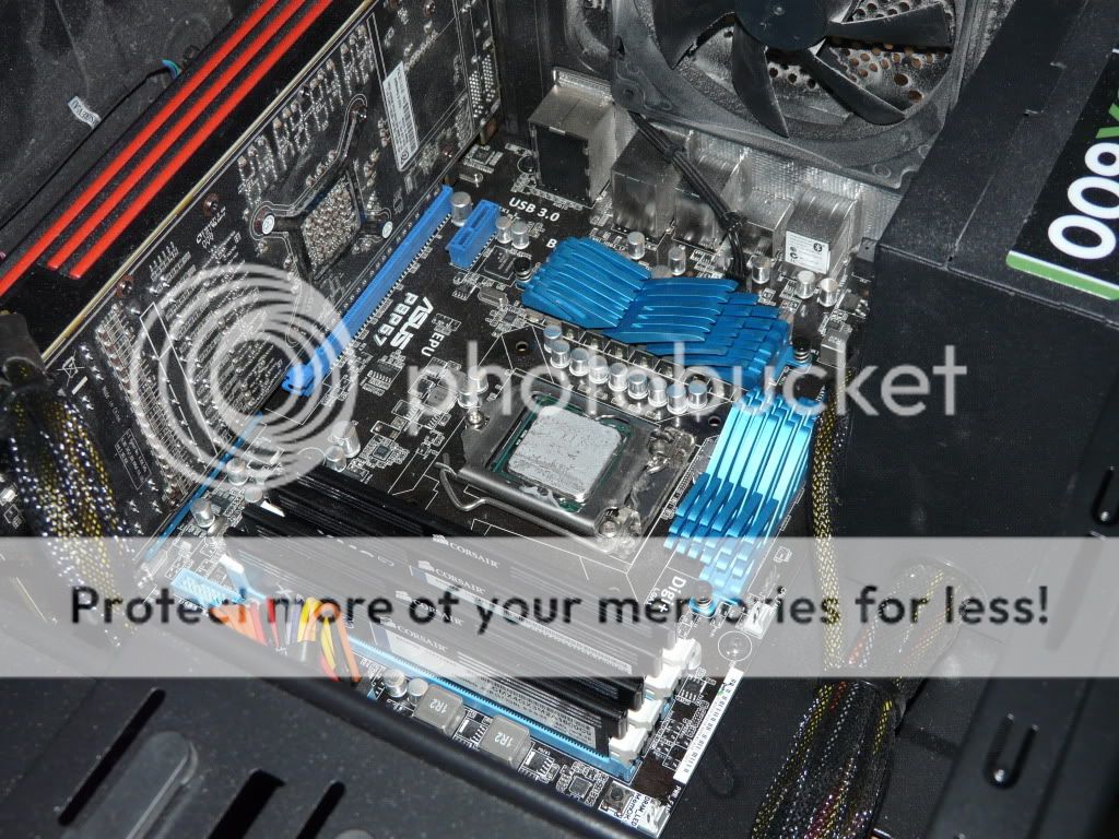

- a lot of thermal paste on the cpu
- a lot of excess hosing, could do with some angled fittings
- get some Gentle typhoons on push pull ;)
Hi Panyan i didn't think it was that much but what do i know, in the manual they put it in a cross pattern, but from what i read a single line is best as you can get air bubbles between the crosses.
I tried shorter hose as its only a midi case but then you get kinks, so this was the shortest i could have without kinks.
So i will change my front fan to pull as its still at push?
Thanks
Guy
Thanks
Guy
some of these should allow you to make straighter tubing runs and not have so many large curves: http://www.overclockers.co.uk/showproduct.php?prodid=WC-182-EK&groupid=962&catid=1529&subcat=1852
normally i just apply thermal paste in the standard: pea size in centre -> let cooler spread when tightening
personally i would have air coming in through the front (dust filtered) and then having the fan pull the air through the rad out the back
id also get two of these for push pull config: http://www.overclockers.co.uk/showproduct.php?prodid=FG-014-SY&groupid=701&catid=57&subcat=4
but that may be an for a later upgrade :)
tbh seeing as you have a small resevoir the lenght of tubing is adding to your volume more volume is always good. so unless you want an uber neat system with short tubes id leave it if your happy with the performance
Hi Rossi, i went back just now and put a little blob in the middle, temp wise i think it might have mad 1c different, but i understand why you shouldn't have to much, its there to fill in the imperections, bit like a gasket, but metal is a better conductor so you still want as much of the chip touching as possible.
regards
Guy
