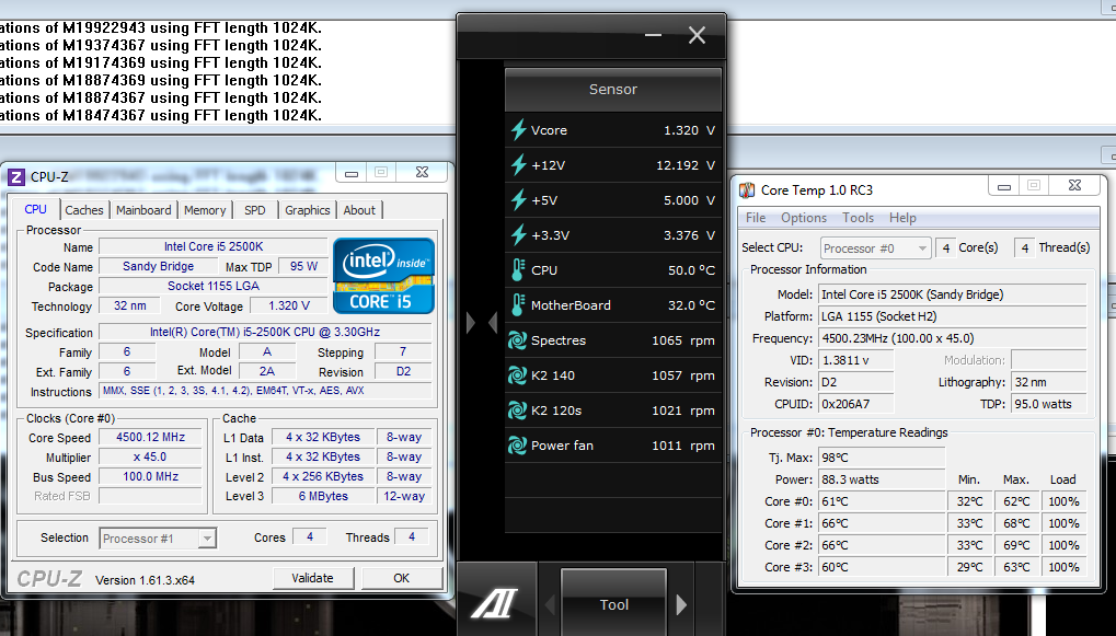

Here's my 2500k @4.5 with a K2 running 2x120mm+1x140mm @1000rpm on Prime95 blend (ambient 25C):
It's virtually 'silent'.
The intake fans on the case make more noise as they produce intake whoosh through the grills.
In real world stuff like gaming etc, I doubt you'll be producing those kind of temps. (I stand ready to be corrected :D)
