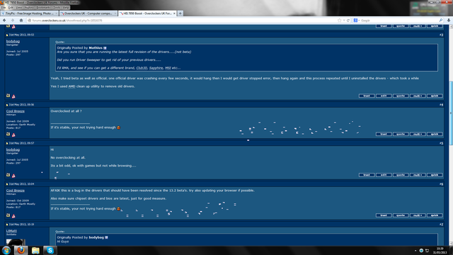

No luck....i get graphical glitches all over the place, i will try and post a screen shot.
there you go, as you can see the white boxes - now they move allover the screen and get faster as I type....lol
pic posted.
I would suggest trying to disable hardware acceleration on flash and using a different connection to your monitor (if you can) to see if either temporary solution fixes the problem.
Are you on a single monitor?
PSU is a corsair 750 bought 3 days ago, tried another PSU BE Quiet 600w, both do the same thing I disabled hardware acceleration no luck. its got to be the card. O.C are picking it up Monday.

As long as they can replicate the issue you'll be fine. Make sure you tell them what to do.
It looks like not enough voltages on the 2D memory clocks to be honest. I would RMA it anyway since it's not working like it's suppose to on stock settings.
