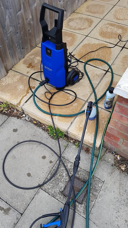

I used my new Nilfisk today to wash my car. The thing is, after a few seconds the hose goes flat and the water pressure gets weak. So it took longer to do the job.
After not using the machine for a minute or so the hose reinflates, I get a few more seconds of full pressure and then the hose goes flat again. It's a new hose I bought last year and I'm running it about 30 feet from the tap in my garden to the front of the house.
I made sure to untwist all kinks along the length. Could it be the wrong gauge hose as I think it's slightly narrower than standard?

Yes, tap fully on. I think you're right, that a vacuum is being created and flattening the hose. It probably is the wrong gauge hose. It doesn't appear to be narrower than the pipe, though it still might be that that hose needs to be wider. But see what you think from my photo.
And I measured the hose to be just 1.5 cm wide. Perhaps I need one that is 2cm+?
That hose looks a bit odd but I’m in bed so don’t have mine to hand to measure. Can you borrow a neighbours hose to try?
hose is fine .. I have a 50m hozelock starter set driving my karcher of that dia. 12.5mm/1/2" internal ... you could check how long it takes to fill a bucket.

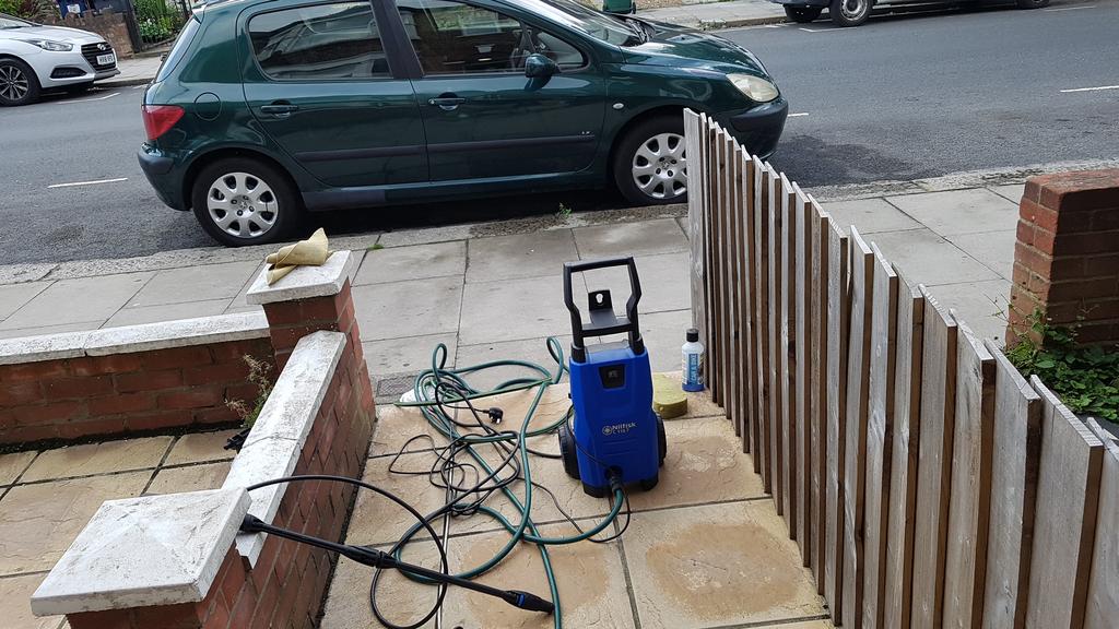

Thanks Psycho Sonny. Well I've done some testing today and a short video. First thing to say is that there's nothing wrong with my water pressure, which I'm happy about.
I tested two hoses. The first hose in the video is an even narrower gauge, an inexpensive Homebase own brand, about 1cm wide, and after testing with a standard multi pattern spray gun that came with that hose, it also worked really good with the Nilfisk while coiled up on the reel and there's 10 metres of it. Full pressure, no collapsing of the hose.
Then I tested with the hose I used yesterday which is 25m long and couldn't get much water to come out of it today. I then cut about a 6 foot length from it and tested that and it worked flawlessly with the Nilfisk with no reduction of pressure or flattening of the hose.
I'm not sure why it doesn't work properly when the full length is connected, especially considering my other narrower hose works with all 10 metres.
Could it be that 25m of hose is simply too long?
All other things being equal, the longer the pipe the lower the flow rate, due to resistance.
25m of hose is obviously reducing flow sufficiently that the pw creates a vacuum and collapses the hose.
I would say that the 25m of hose is just poor quality, shouldn't be collapsing.
Bin it and buy a hoselock one or something from homebase or b and q, if it happens again take it straight back for return and try different one
he hasn't confirmed what the internal diamter is but likely to be 1/2" since the fittings look 'normal'
but the hose quality does not play, if the nifisk is pulling more water than can be supplied that problem/vacuum will remain even if the hose has more integrity.
