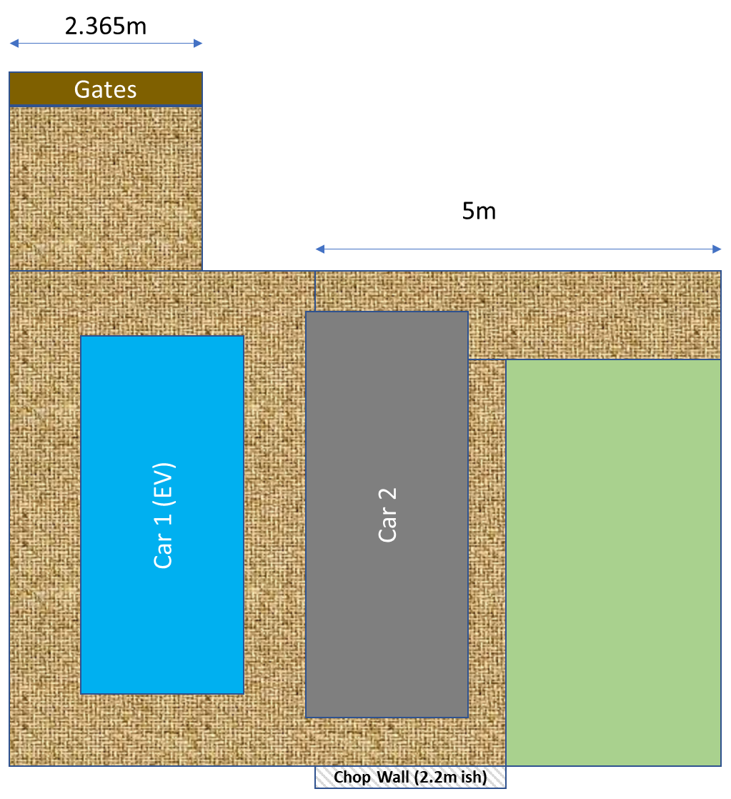

Hi folks,
Me again... this time - driveway. I am getting pretty tired of swapping the cars around and hiding my car up the back left (street view) and climbing over the passenger seat. I'm planning an electric charger on the front left of the porch.
I've had a quote to roughly achieve any of the below in standard block paving bricks - £4.5-£5k (written quote TBC). To put it into nicer Tegula it is approx. £1200/1500 more...
Edit: Just doing Option 1 and not touching the existing drive is like £2.5-3k.
What do people think on best approach?
Things to consider:
* Unfortunately to extend the dropped kerb where I live is INSANE (like £2k-£4k) and the last 3 applications on the road have been rejected. So the more of the front wall I remove, the more I am visibly a cheap skate/will have to bump the car up and down the kerb/may get some jokers who DGAF about parking in front of my driveway because it technically isn't a drop kerb
* The garden where it joins the neighbours garden is a dodgy AF soakaway for the roof channel. A drainpipe just dumps it into the middle.
* The garden is much higher than the driveway so will need retaining. The quote includes sleepers as presumably this is a cheap mans way of retaining nowadays. To extend the granite front wall is about another £2k.
* It is a busy road so ideally the less of a wall/the more of a front garden/the more I can plant high conifers/box to stop some of the road noise.
Current:
Opt 1:
Opt 2:
Opt 3:

I can't help but interesting to see the outcome. We have a very similar front garden to drive ratio and it's something I've considered, as we currently park the 2nd car on the road at the front of the house.
When I've considered it in the past, I'd always thought I'd go for something more like option 2 or 3, as its more aesthetically pleasing.
Will you have enough room to get car 2 off the drive if car 1 is parked up? In guessing so, or else you wouldn't be doing it!
Yeah the main difference between opt 2 and opt 3 is how close to the wall my wife needs to get so both cars can get on and off. She's a new driver so opt2 may be forced...however it's electric and I'm far less of a purist when it comes to moving it a fraction (hate cold starting and then not letting it warm up), and I rarely use my car tbf.

I'd go for option 2 or 3 type design, but take the wall back so you can park like option 1, with dropped kerb to suit.
This gives you flexibility and a nicer looking drive :)
