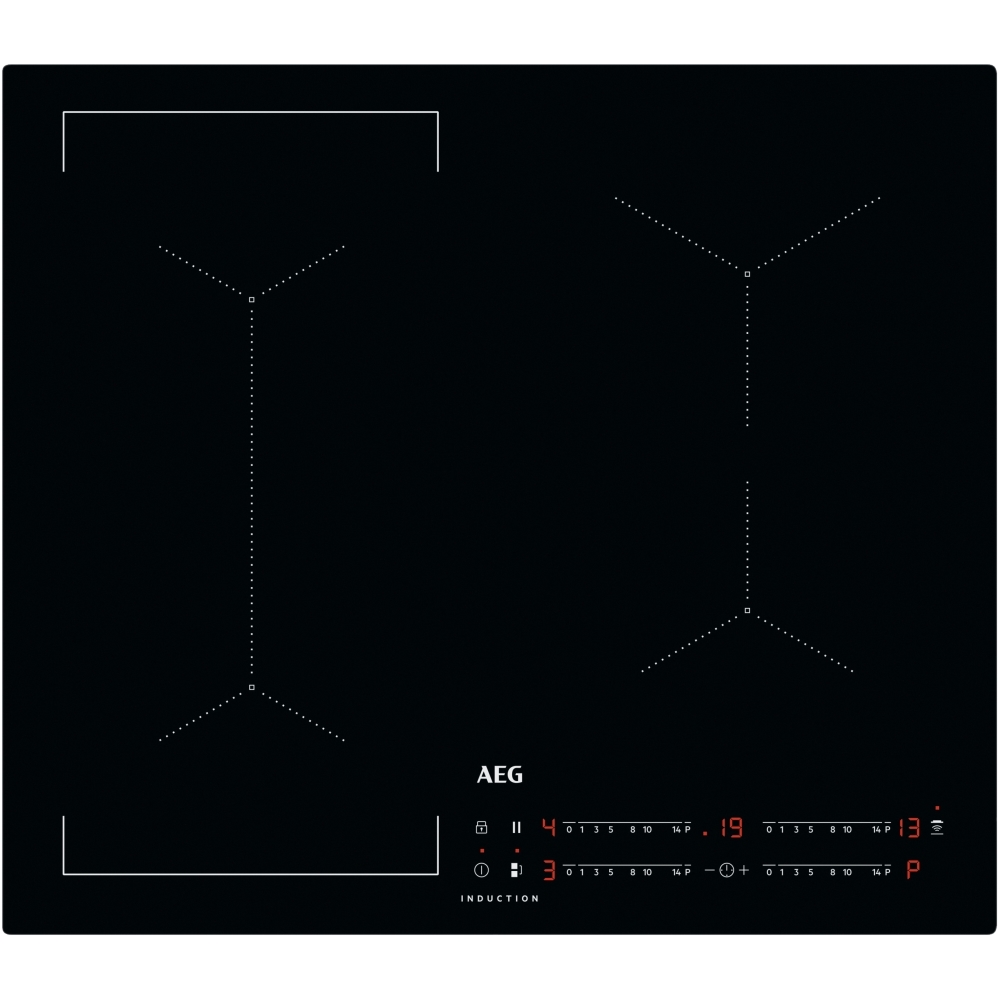

I switched to this one in 2020. Smaller than your options, but just to give you an idea.
It's never missed a beat and its used nearly every day, The top is holding up really well. Power options are great. Boost for quick boiling and pan heating. The dual zone works great, especially with our cast iron griddle for burgers and veg.
I miss gas for wok cooking, but I bought an induction wok, and whilst not the same, it does the job.
As others have said, the touch controls can by temperamental when wet, but it's never caused me a huge issue. The fact that I don't have to press + or - on this version was a big selling point for me. Have my numbers for cooking, simmering, warming right in front of me.
Most of the AEG ones can also link to extraction hoods, if that's a consideration.
I would go AEG again without hesitation.
