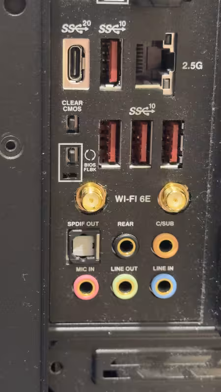

I will do that and have tested the GPU (4090), memory (DDR5 6000) and PSU (replaced old 1200 with new 1200) and all are working fine. It hasn’t moved and has been working fine for 2 years and just started playing up. The BIOS has been redone (had to hold my finger on the rear panel for it to stay on, but will reseat the 7800X3D to remove that. Nothing obvious on the motherboard but just won’t turn on anymore using front power or motherboard on/off button, only the BIOS rear panel button and as soon as I remove my finger it shuts down.
The only button that turns it on and needs me to hold it down to stay in, is the BIOS FLBK button with the white box around it.
I think thats the BIOS flash button.
