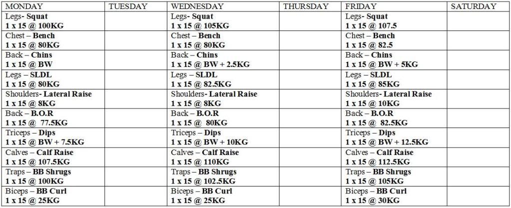

Week 2 for me is going to be something like this:
Im possibly going to need to alter some weights as the week goes on.
Also bought some STC whey today :) better taste nice at a fair bit more expensive than unflavoured whey :p
Looks good mate.
Interesting as you've got 2 sets of 15 reps.
I thought it was 1 x 15 for 2 weeks, then 2 x 10 for 2 weeks and then 3 x 5 for 2 weeks. Or is the set total the same for the duration with just the rep range shortening & weight increasing?
