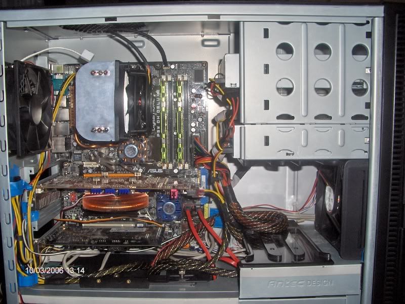

My pc in pic.

I had to offset the fan on the SB to accomodate the stock cooler on my X1900XT it over hangs by about 1 cm, but I do only have one. A 1cm high fan will not fit between SB and stock X19xx cooler.
