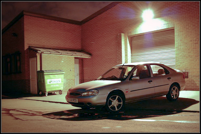

Hi guys, I've got a Nikon D40 with 18-55 lens. I'm off to a car meet tomorrow evening and have promised to get some good shots as i'm the only one with a decent camera. I have a tripod so long exposures isn't problem. Now.. i've just been out to a car park with orange floodlights to get some practice and i'm struggling to get decent shots, i've tryed ISO 200 to 800. 1.6 secs to 3 secs exp, but my pics are still dark and dull.
Can anyone recommend me some settings please?? I'm too tired to go back out and practice more (although i know this is what I should be doing :( )
The big problem I see with that shot is that you're shooting into the floodlight so you have the problem of blown highlights and most of the subject is in shadow. If you want to have the floodlight in the shot then you're going to need to use fill flash which is going to take a fair bit of practice to get right.
Oh, and lose the wheelie bin ;)
Like has been said. Shoot RAW and fix the white balance and any exposure issues afterwards. Really, there's no excuse to shoot in JPG! That's just my choice though. To be honest the kit lens isn't really fast enough to get non blurred shots in low light without a decent exposure time/tripod. You can go to ISO800 ok with the kit lens. I would stick the camera on auto ISO and set the max value in the camera to 800. Peronsally i think 1000+ on the D40 is completely unusable.
That photo isn't too bad (technically speaking!) apart from the white balance. There's really not a lot you can do about the blown highlights with the exposure times you'll need on the kit lens, without using a flash. And really i would avoid using the onboard flash. You can always have a play with it though.
Hope you don't mind but I had a quick play, couldn't do much about the flood light, really over exposes the shot.
EDIT: looking at it again I've now given it a dodgy green tint.
ISO 2-400, F-stop according to artistic intention. Expose for the scene, and as rpstewart said try not to shoot directly into lights unless you're using (off camera ideally) fill flash. And of course shoot in .raw so that you can correct the white balance later.
