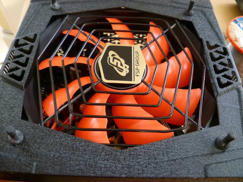

My Power Supply, the FSP Aurum 700W is a 80 Plus Gold unit that achieves 91% or thereabouts efficiency at the loads I put on it. The stock fan is a 2,400 rpm model which is wired to an rather aggressive fan controller. I've checked temperatures and the differences between case and rear PSU external temperatures never go more than 3 degrees at any load I can put on it. I'm thinking FSP have gone very aggressive with the fan assuming that Joe Public will want it to exhaust system heat as well as PSU generated heat. For me in an Antec P183 this is not as issue.
I should also add that the noise generated by the Aurum is not particularly high in any regard but is high compared with the rest of my system with no fan ever over 1,00 rpm and suspended hard drives inside an insulated Antec P183.

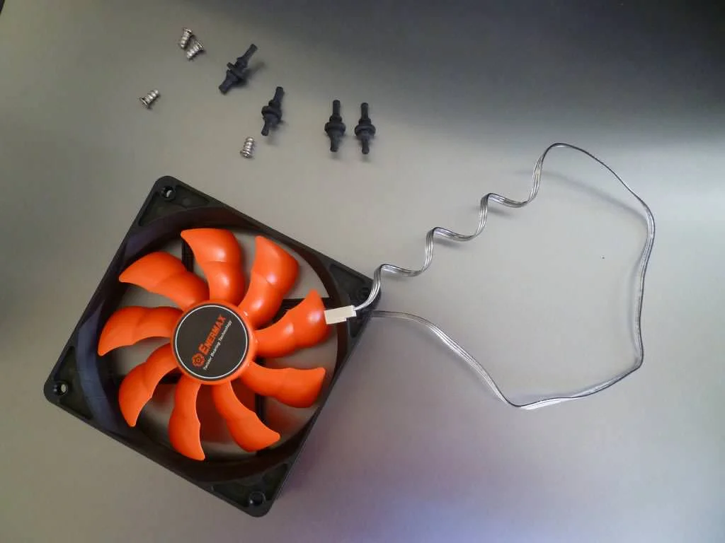

So I needed to decide which fan to replace with. In the end the choice was a now defunct Scythe S-Flex 1600rpm or the one I went for, the Enermax Magma. The Magma has a 85 degree C working temperature, 100,000 hour MTBF and is 1500rpm and pushes decent air. Perfect.

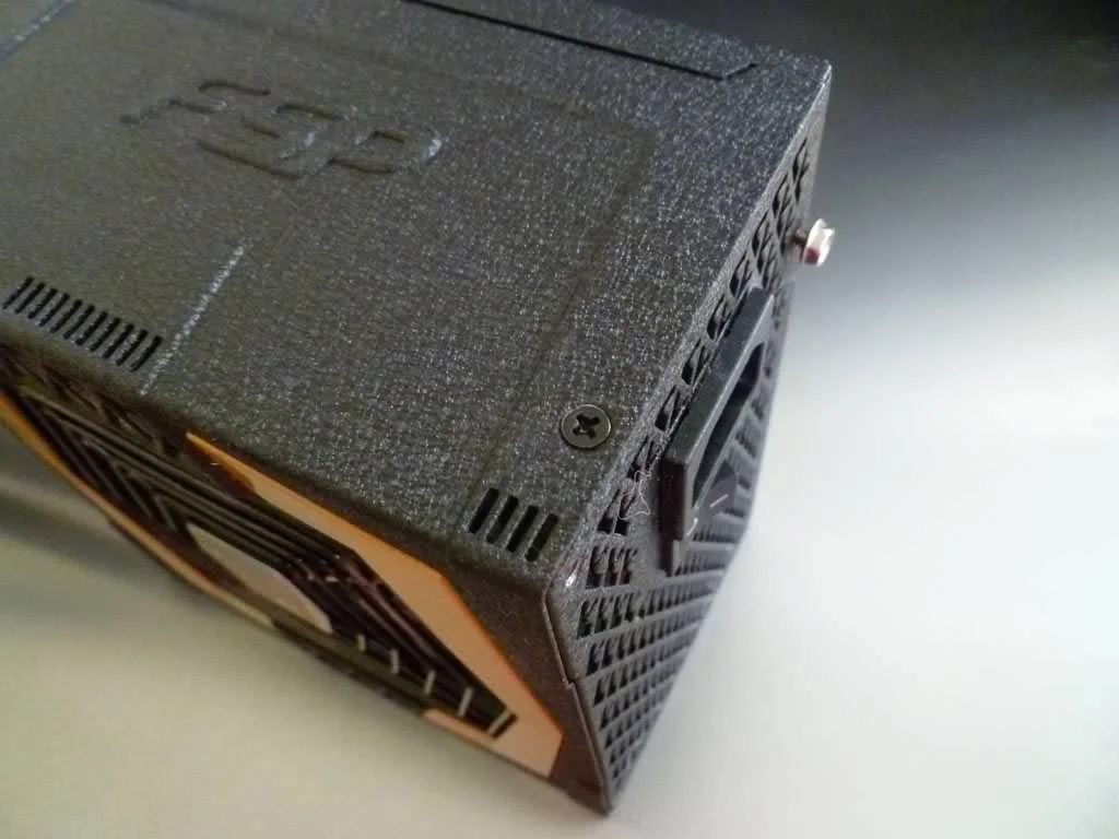

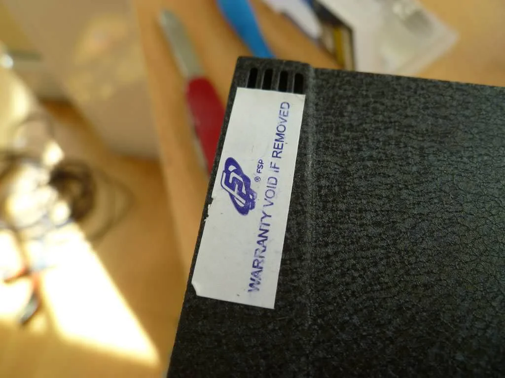

Remove the four PSU case screws to get at the inside. One of the screws may be covered with a Void sticker. Remove the sticker carefully, you may be able to reapply later.

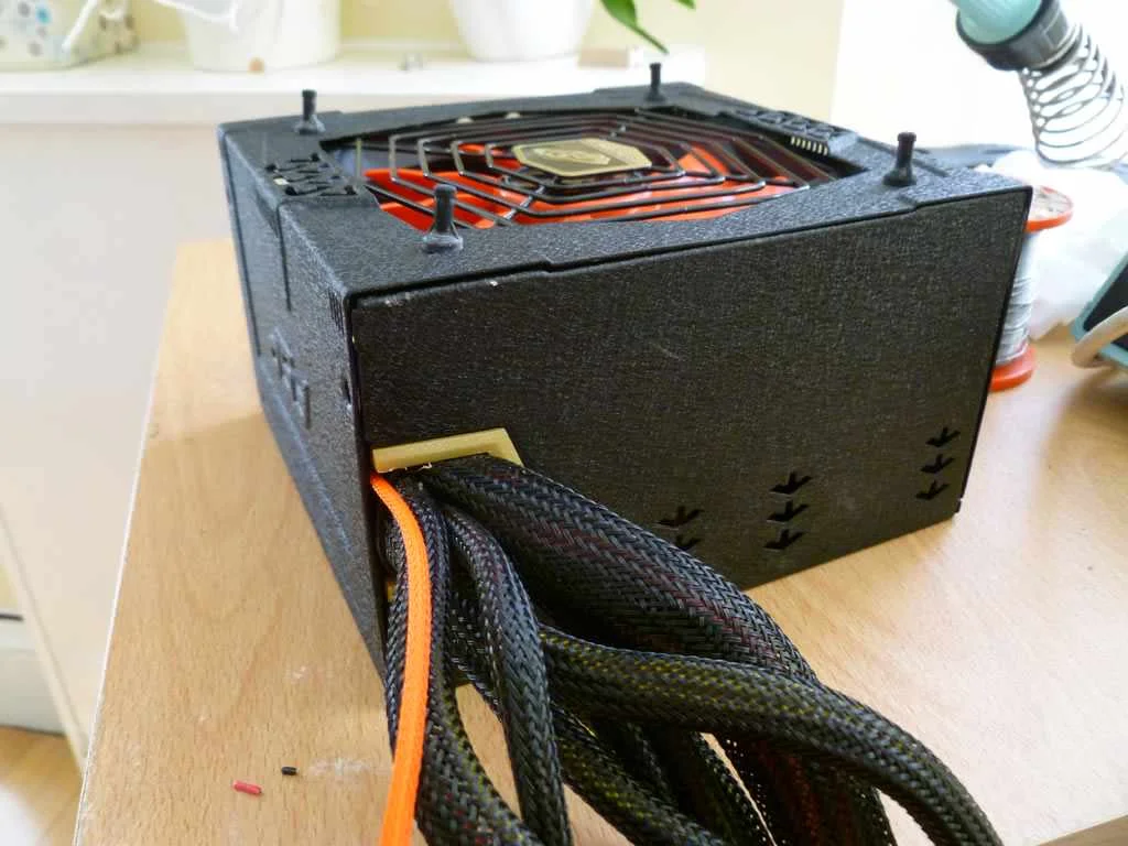

The casing may need to be prised from the top if it's anything like mine as the sides are kind of tucked in.

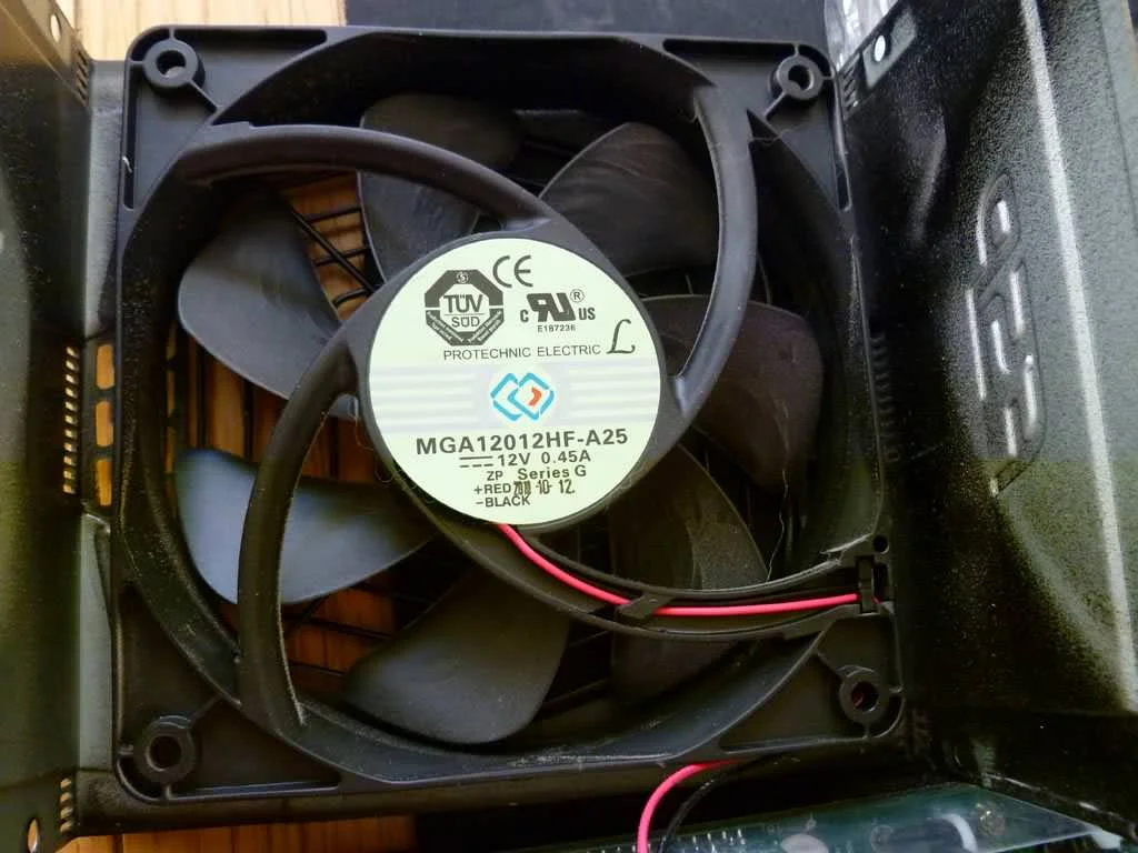

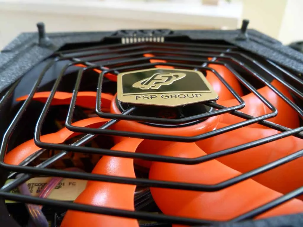

The stock fan.

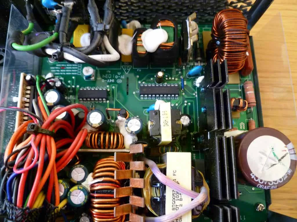

The power regulators -- basically this is what needs cooling (hence the big heatsink)
Unfortunately the FSP Aurum has it's fan wires soldered directly to the PCB and I can't just shove the 3 pin fan header connector in place of the stock fan.
So I need to cut the wires and stuff. Oh joy. :D

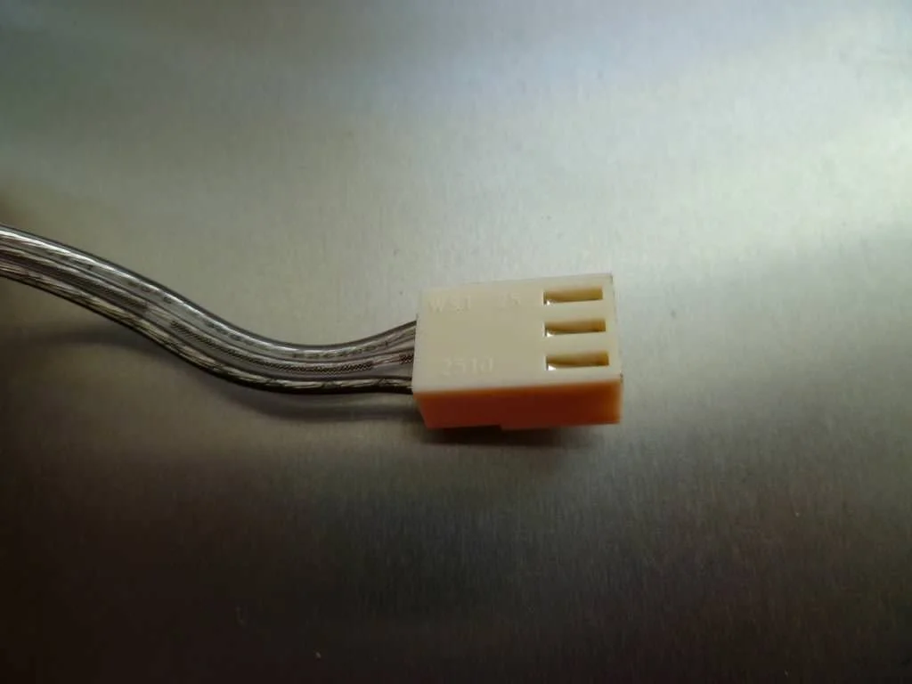

First thing first let's identify and understand the wiring.

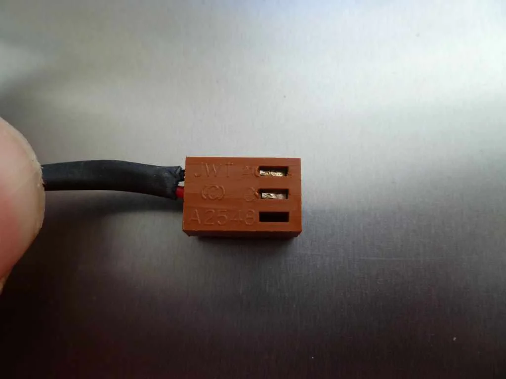

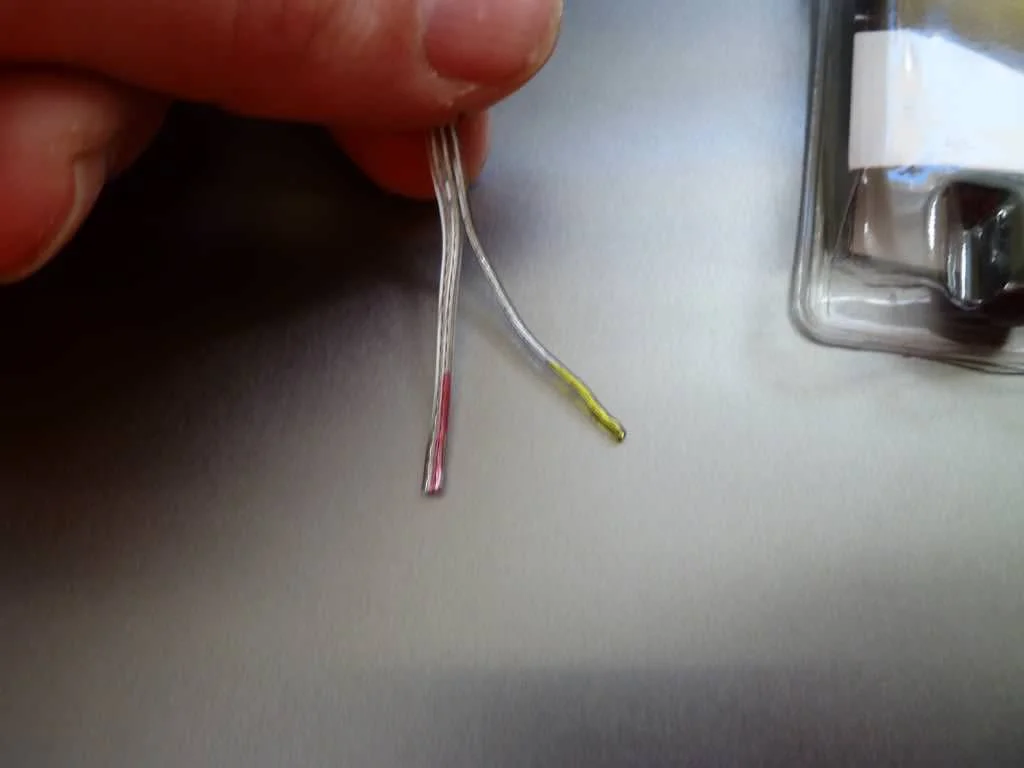

A normal fan connector.

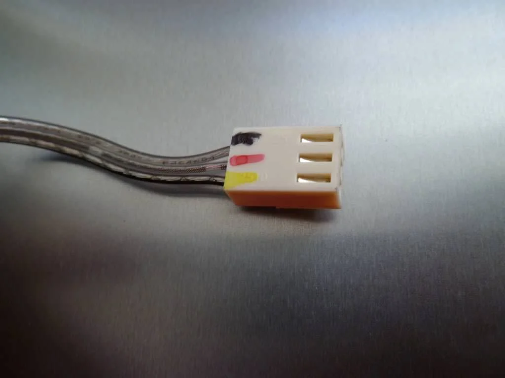

And a modded Magma connector.

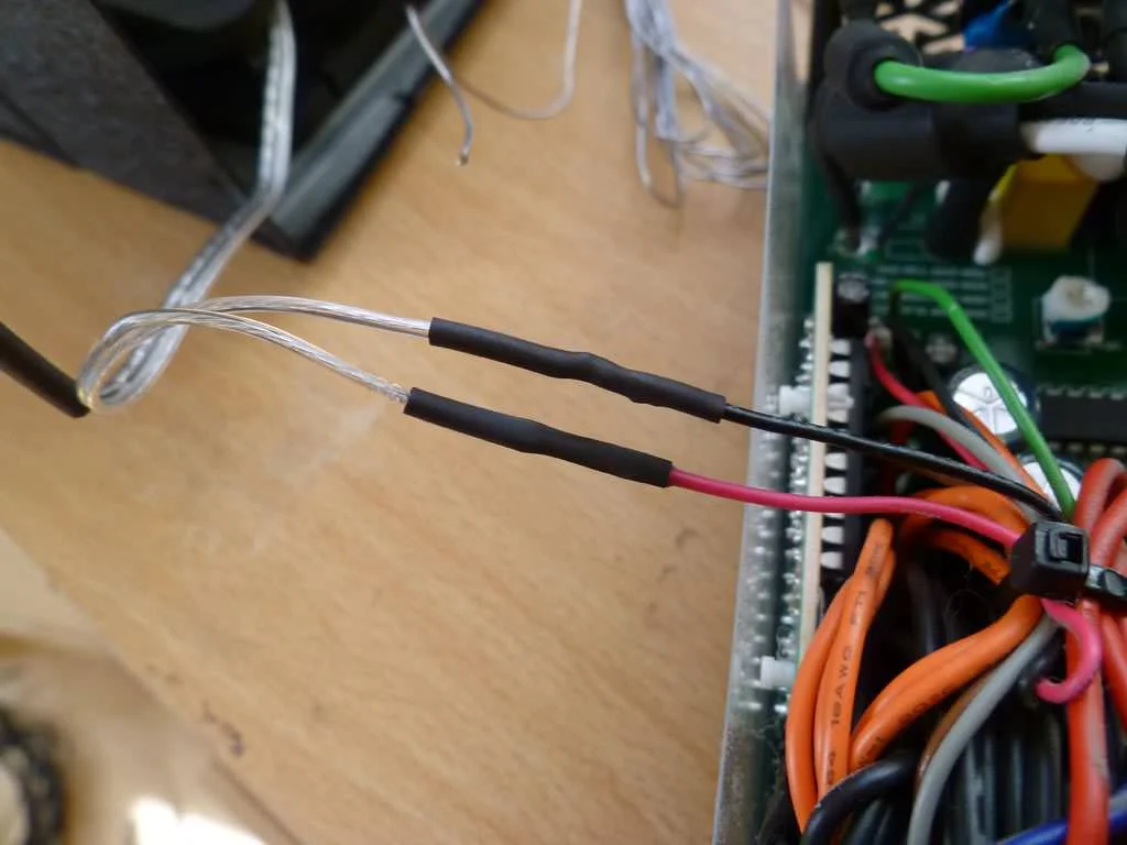

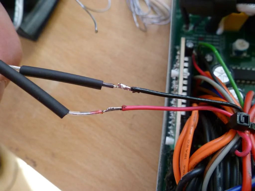

So cut the wire and mark as appropriate.
Bare and tin the wires and then fit heatshrink. Solder together.
And shrink.

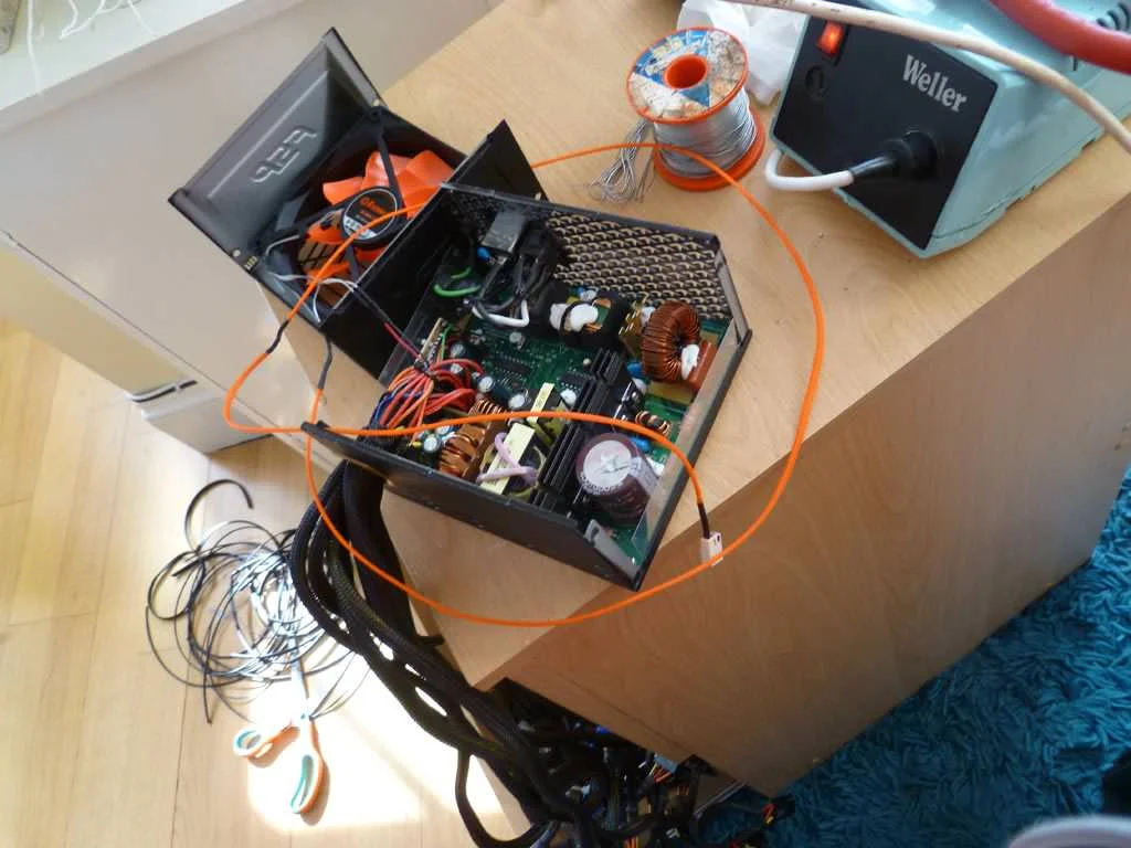

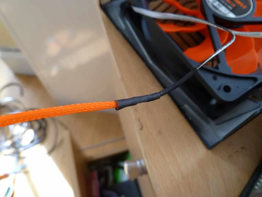

I wanted the sense wire (normally yellow) to run into my case and be plugged into a motherboard header so that I can monitor fan speed in the PSU. I used some Orange braid for this wire. Nothing complicated here, just basically soldered a yellow wire to the redundant Magma fan's sense wire, added the braid and heatshrink.
Fully wired up.

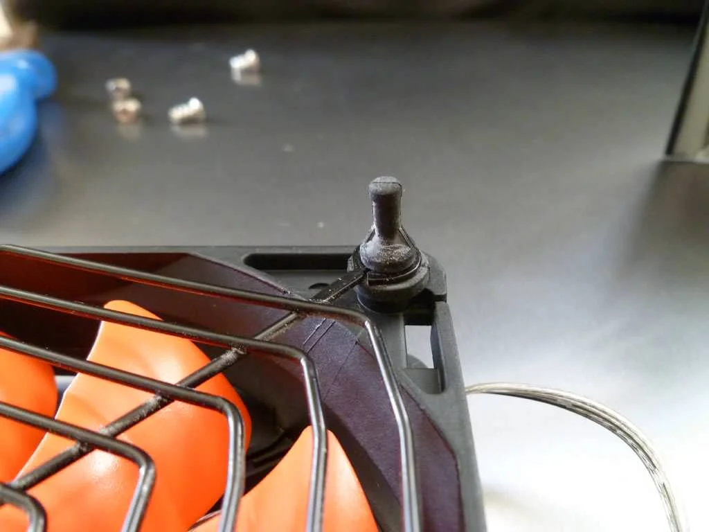

Fan needed to be fitted back into the PSU cover. Fan MUST have airflow pointing into the PSU. The fan will usually have arrows to help with this.

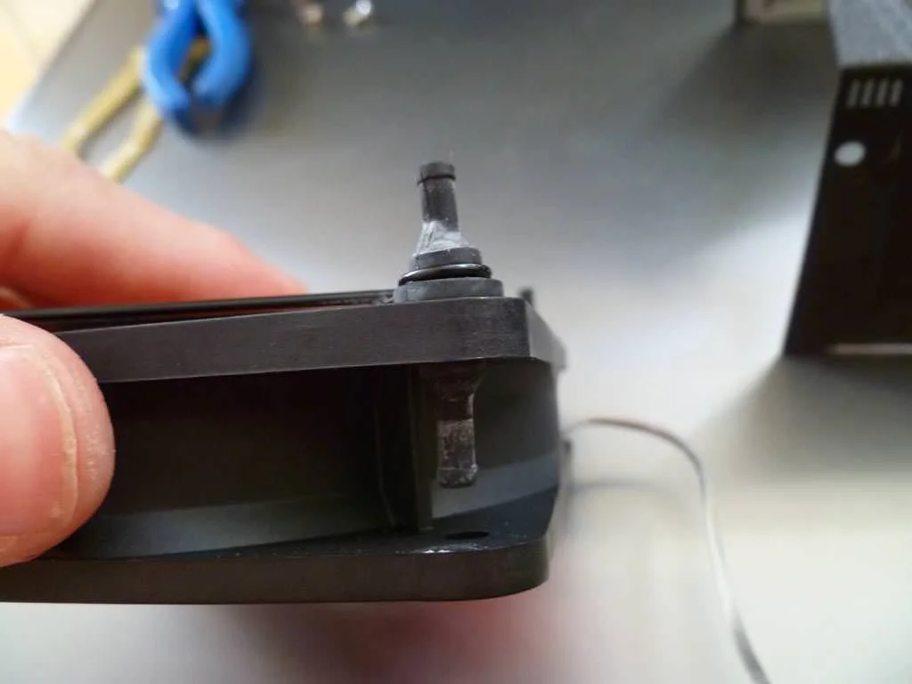

I used the rubber grommets that came with the Magma, inserting the smaller diameter through the case and into the fan grille and eventually fan, like so. I used a pointed nose plier. Fits together pretty nicely. Nice grommets from Enermax.

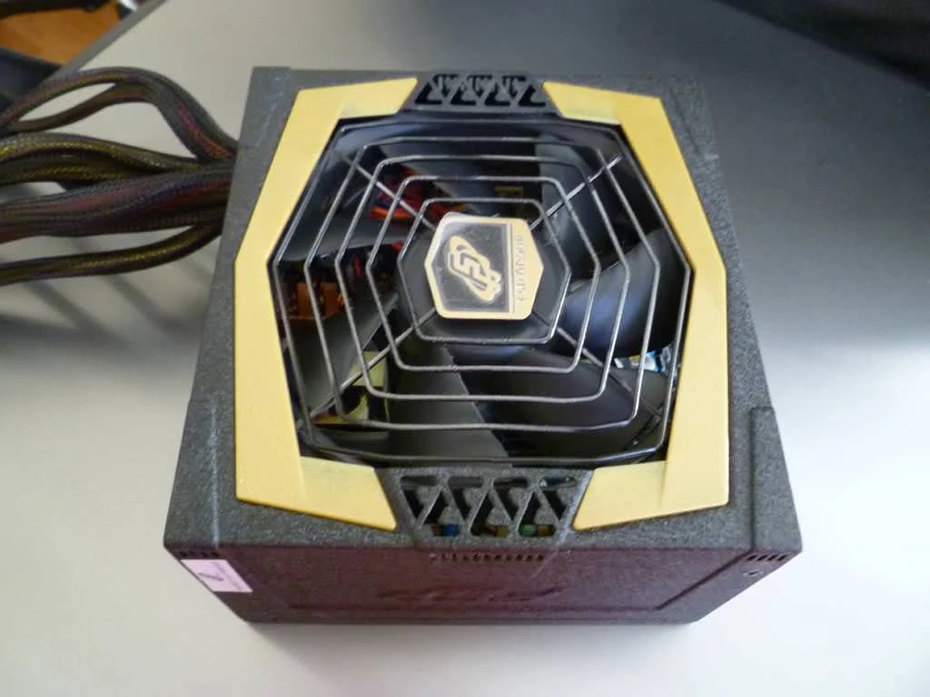

The job is done.

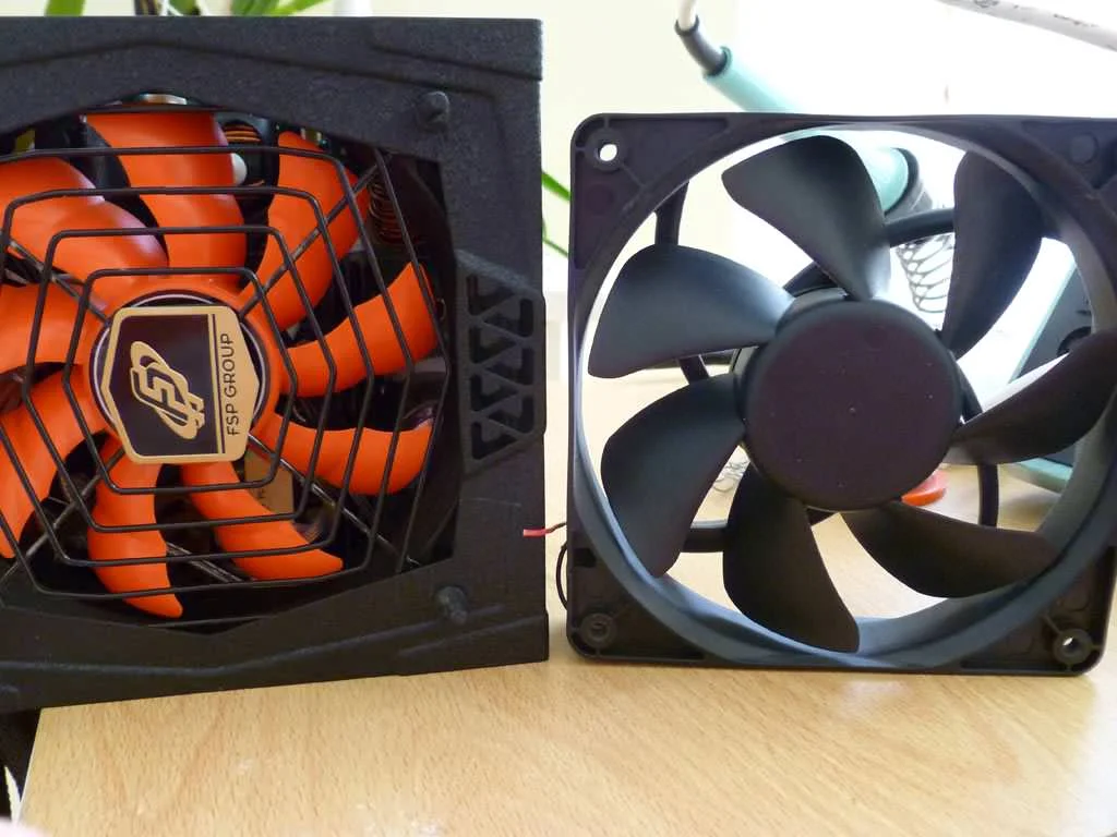

A comparison on visuals.
Chuck the crappy 2,400rpm fan away.

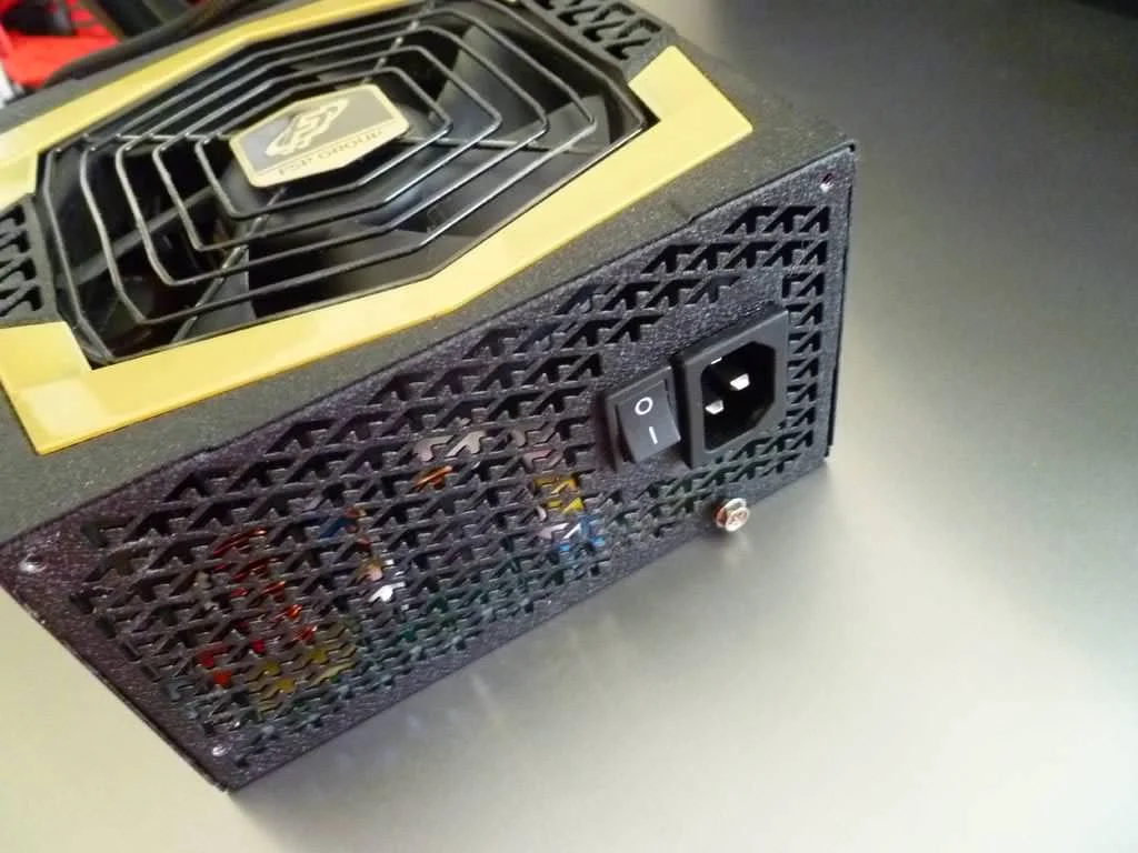

And fit back into your case.
And now for my result. The difference between the 2,400 rpm mounted with screws and this 1,500 rpm mounted with grommets is staggering. At idle, where it's most important to me, the PSU is to all intents and purposes silent with the fan purring away slowly. The air coming out of the back is actually comparable to the airflow I felt before the change, which is odd but yet comforting that the components are still getting cooled.

This monster capacitor must hold a joule or two when energised. I wouldn't want that energy dumped through my heart whether it be DC 12v or AC 230V.
