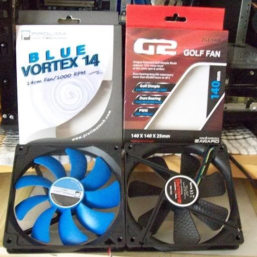

My Zaward PWM 140mm fans have arrived will do a small review, compairing them to the ProlimaTech 140mm Blue Vortex fans which are already installed, both set of fans will end up a Push
ull config on my BI GTS 420 Triple Fan Rad. The only downside is when are manufactures going to realise we want different coloured fans not just black or just Blue, glad to see a lot more are braiding the fan cable. If a manufacture produces a good fan, having them in various colours would be a good selling point.

Zaward 140mm PWM Fan Spec-
Dimension-140x140x25mm.
Fan Speed-300±250rpm~1200±250rpm.
Bearing Type-Duro bearing.
Max.Air Flow-74.14CFM.
Operation Voltage-12V.
Connector-4-pin.
Life-60,000Hrs.
Noise Level-10.1 ~ 20.3dBA.
Weight-166g.
Colour-Black.
Led-N/A.
Extras-Rubber mounts + rubber washers for vibration.

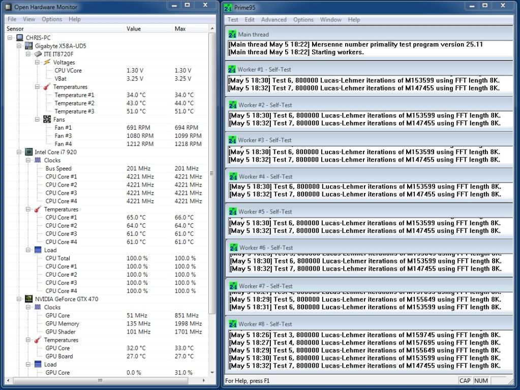

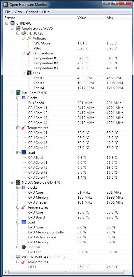

Zaward PWM x3 fans-Push/ProlimaTech x3 fans-Pull config-
1-Idle after 10mins > 28/30/28/32'c +/-1'c > Zaward x3 fans-403rpm / Prolimas x3 fans > 1090rpm.
Note-Fan 1 > Zaward PWM fan / Fan 3 > ProlimaTech Fan.

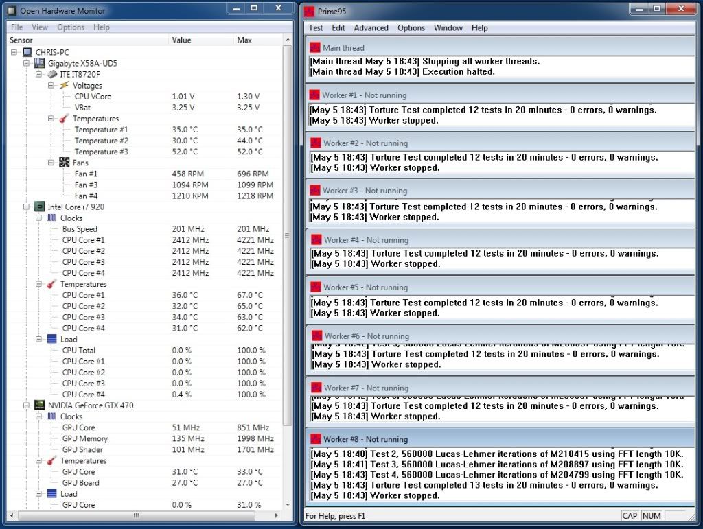

2-P95 after 10mins > 61/61/64/66'c +/-1'c > Zaward x3 fans-694rpm / Prolimas x3 fans > 1099rpm.
3-P95 at 20mins > 62/63/65/67'c +/-1'c > Zaward x3 fans-696rpm / Prolimas x3 fans-1099rpm > checked room temp now at 20.5'c
4-Idle again after 10mins > 29/30/28/32'c+/-1'c > Zaward x3-435rpm / Prolimas x3 1080rpm.
5-GPU core temp went upto > 33'c from 28'c.
