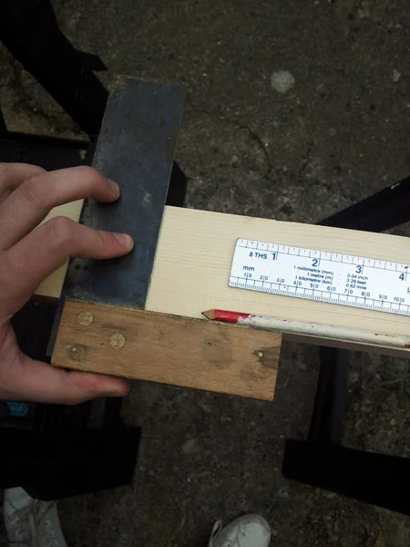

Firstly I had to mark out the framework for fixing to the walls, this will be what the desk rests on out of sight.

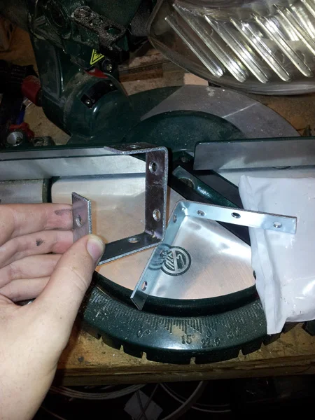

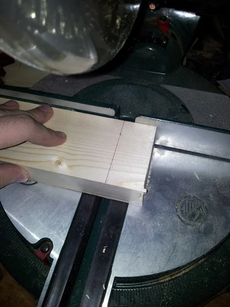

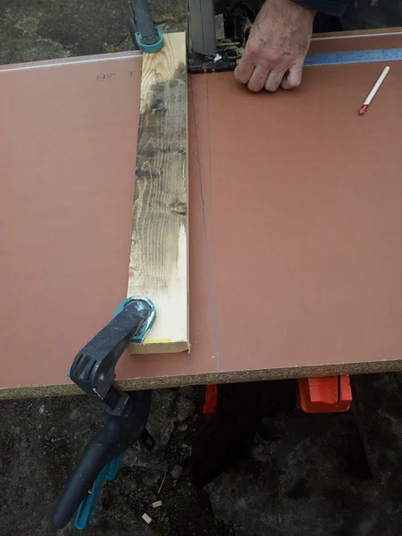

Forgot to allow for the thickness of the backplate for the side brackets ;) derp.
Bench saw soon fixed that

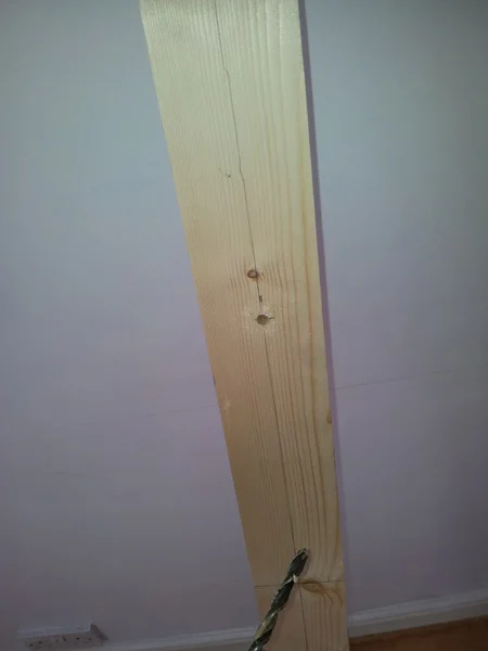

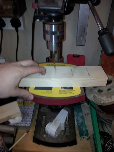

Drilled the initial pilots for the back/side brackets

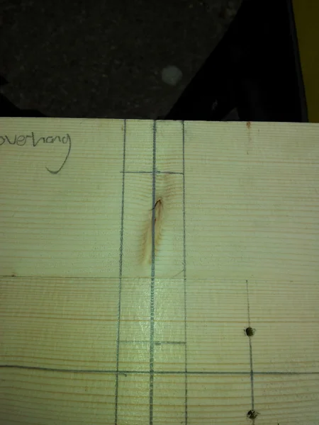

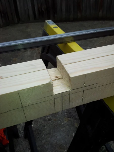

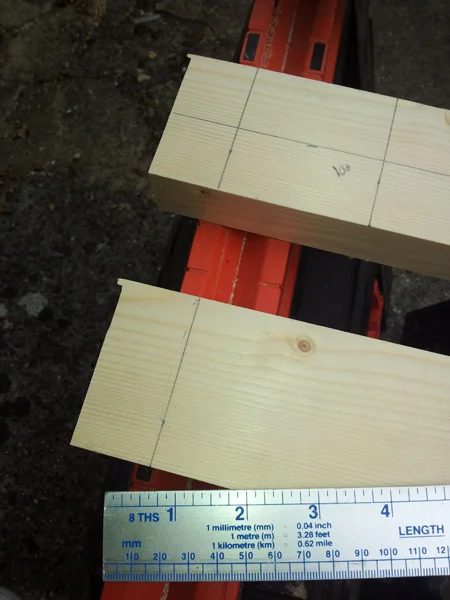

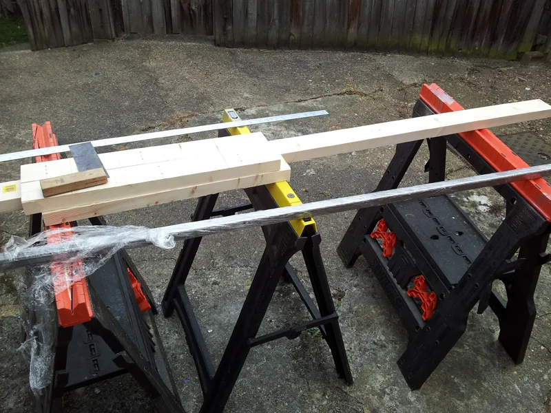

Next had to mark out the notches for the steel support to sit in
Then sawed and chiseled out the notches

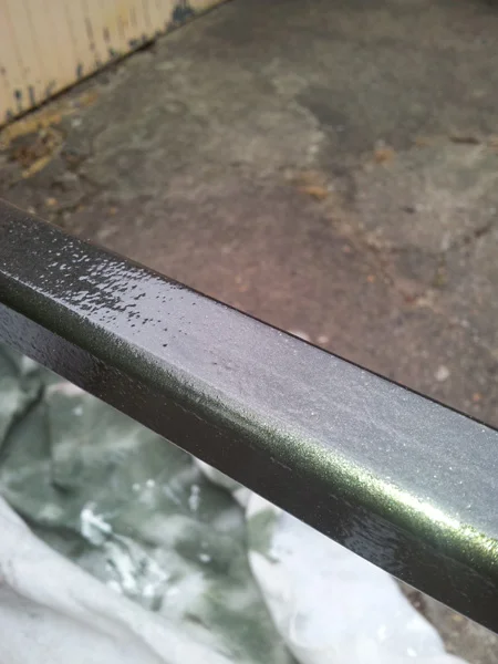

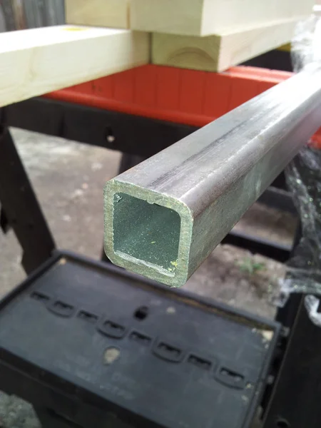

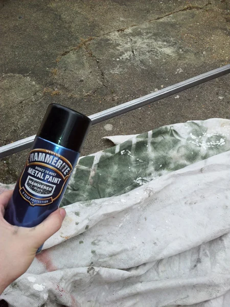

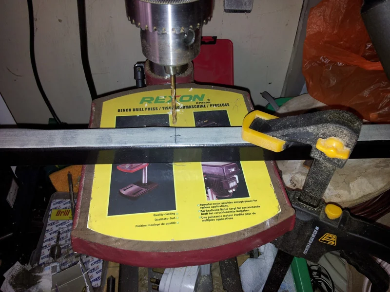

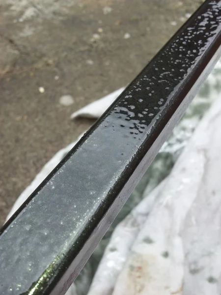

25x25x3 Box Steel, all rubbed down with thinner and sand paper to ensure it was free from oil.
Due to the kind of steel, I need to coat it to prevent it rusting, I chose this as it had no need for primers / undercoats.
First coat on
Third coat on
Well deserved rest

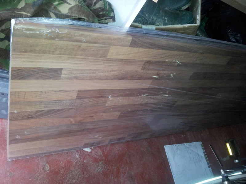

did you buy the work top especially or did you have some left over from a kitchen you've just fitted?
Bought it for the project. It's 3 meters in length so I may well make a little shelf with the remainder for the printer, server and switch.

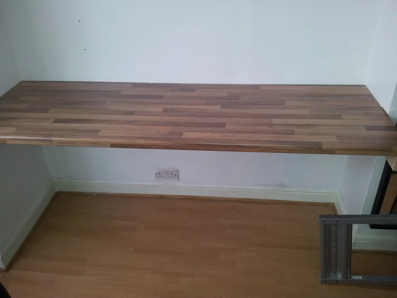

UPDATE

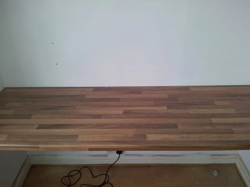

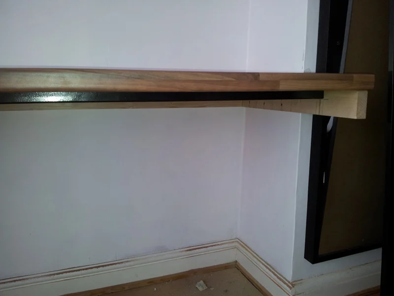

A quick update on the progress, desk is coming along nicely! It's all fitted for now, but some work to do yet (as well as repairs).

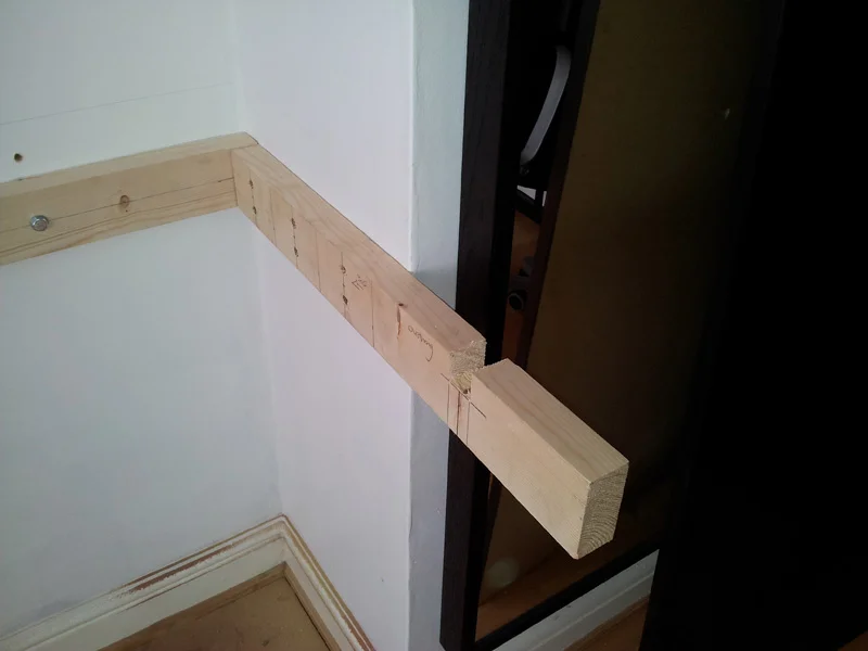

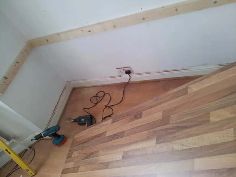

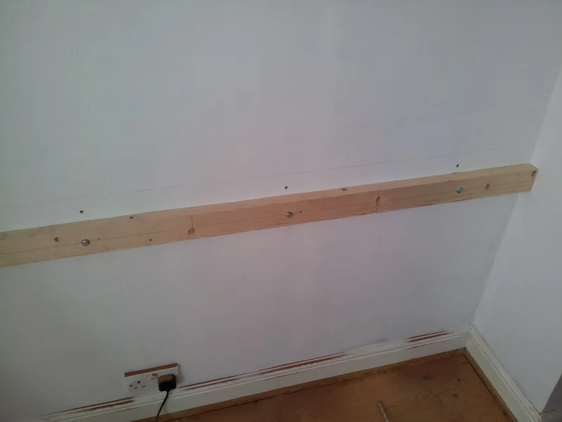

First of all I started opening up the holes for the back bracket (the strongest fixing) with 7mm drill bit and 10mm for the wall plugs.

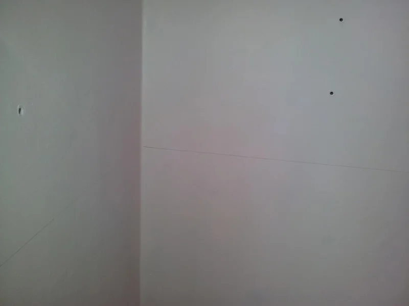

Marked up the wall for the bracket(s) to sit, found this quite hard as to judge the level I wanted the desk to sit at, however I'm fairly happy with the height it came out at.
Success!

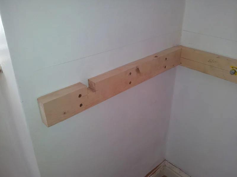

Then fitted the right hand fixing, this has an overhang as the wall its fixing into the chimney, fitted 3 fixing points with 2 screws each for extra stability
Then the left fixing

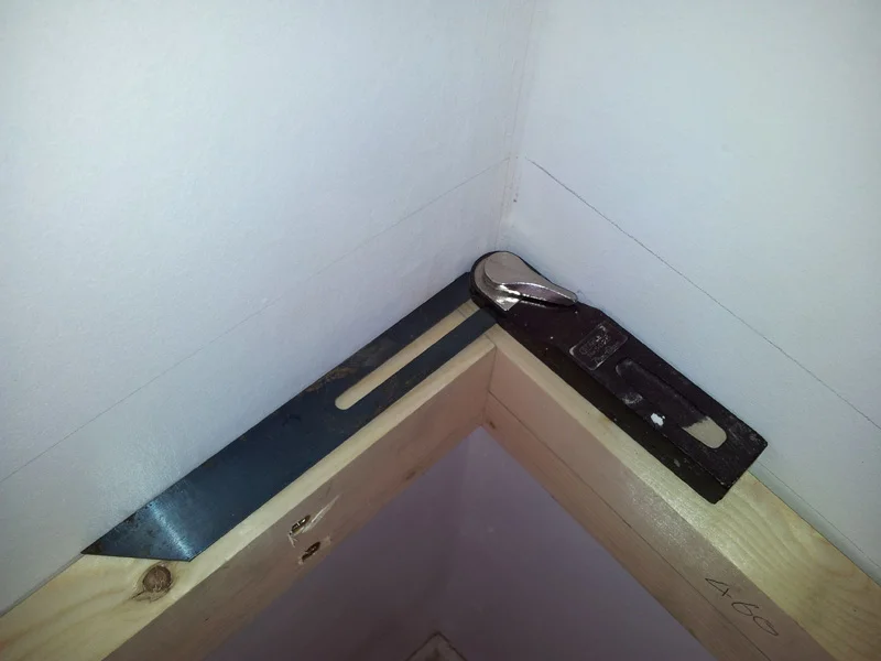

As the walls are not straight, I had to deduce the amount the walls were out, which is where this tool comes in handy.
In true father son spirit, I delegated the work and took a management role ^^

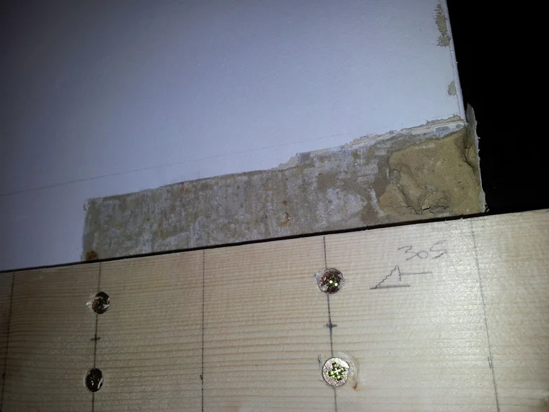

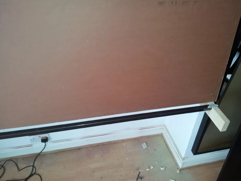

First fitting... did not go so well, as it turned out the right wall was 90 degrees for a short distance and then bulged slightly causing the measurement to be a very tight fit.
The solution? Destroy! This will be touched up after with filler and special caulk.
Now it fits
Then in with my big black rod, and marking out the top end screw points to fix into the brackets

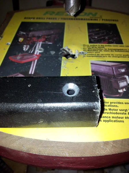

Drilled out the holes on the topside and underside (for fixing into desk)
Countersunk
Fit the steel brace and the desk is secure

The rear mounting board is fixed in with anchor bolts to a main adjoining wall to the house next door, the house will come down before the desk :D. The left support is fixed in to the main exterior wall the the front of the house and the right is fixed into the chimney, which is my weakest point due to the overhang.
It is also worth noting that the main weight will be on the right edge (where the PC will probably sit) which will be close to the fixing point to ensure the least amount of strain on the desk, and along the back of the desk where the monitor will sit; I can't see any issues.
The weakest point in the desk is between the rear brace and the front steel support, that area will have no significant weight placed upon it.
