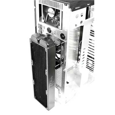

But to avoid cutting I was hoping to just use an external Rad mount instead like done here. My case has the holes factory drilled in the rear of the case (probably what it was designed for) to do this so I would just need some kind of mount/shroud? Anything on OCUK that I can get with the V8 kit to mount externally?
You don't need to mod if you are going for a top mounted pull config. Edit - just saw you have the Mark 1, not the CM690 II, apologies.
You can get external radiator brackets such as this:
to mount externally.
That looks great thanks! I'd like to go this route so I think I'd prefer to go the custom route rather than the kits.
There are a few Radiator Mounts on UCUK, I've also seen a Swiftech Radbox that allows a Rad to be externally mounted, would that be better?
Could you spec me a decent 360 Rad with a 5.25 res and a pump good enough for this or should just I bite the bullet and just get the external mounts with the V12 kit? I like that kit but I'd like to get one of the Dual 5.25" badboys!
Thanks for all your advice and pointing me towards the right direction, it's been really helpful!
You do not need a shroud, I haven't had a chance to look at the radiator mounts on OCUK as I use another watercooling vendor (sorry OCUK). As for rad choice it will depend on whether you prefer to use high rpm fans (loudest route, best possible performance) or low rpm fans (quietest route, excellent performance). However all radiators perform very well. The bracket should extend the rad far enough for it does not intrude with GPU connections etc. There's a koolance one which extends it an inch further with a useful quick release feature.
Is it the BKT-HX001? That seems exactly what I'm looking for thanks:D

*Koolance BKT-HX001 external mount
I was going to get 3X Scythe Gentle Typhoon 120mm 1450 RPM but I already have 3X Thermalright TR TY-140's (They're 140mm but have 120mm mounts). Would these do the job or will I need to get the Scythes?
Thanks guys, I'm almost there!
The GT's are really nice, they push a lot of air with high static pressure and are silent. The TR TY's will do the job however. Yeah it's the HX0001 bracket.
