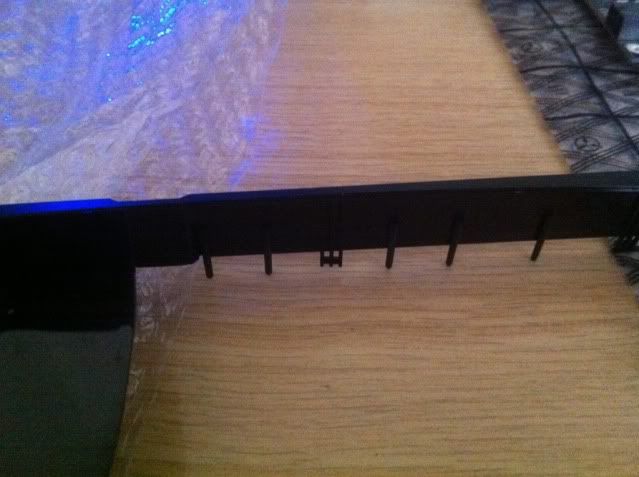

First step is to pop the top half of the shroud off. You don't need to remove any screws for this part, you just need to pop the plastic tabs on either side (4 tabs on one side, 3 on the other):

If you wanted to keep the stock shroud on (and the directed air flow & aesthetics it provides) you could if you used the cable tie method, but because of the bracket I've used I'd have to brake off the middle 4 plastics pieces shown in the pic below:
