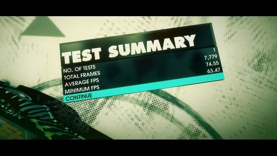

985/1575 at stock volts, note that it's not quite stable at these settings (will shut off under peak load).
I think I have zeroed in on 940/1575 1.025v for 24/7.
What settings were used for the game ?
Resolution ?
Max settings ?
Which view setting were you in when benchmarking (in car, outside view etc ) ? (The view set can make a difference too).
With my 6970 I get 41 AVG, and 36 min on maxed out settings 4aa/ultra/1080P etc. Can't say its not very playable:) - its smooth
