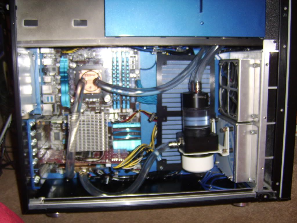

We'll I've been watercooling pc's since 2006 and never had a major Arrrrr! moment.
That is untill Friday night - Loop was fine or so I thought.
Had the usual minor issues with new loop layout, that are sorted during leak testing.
The Koolance res top needed an extra half twist to squish the O rings.
The phat boys needed more omph to get the 7/16 over than I expected.
Xspc Edge is to wide to have all four ram slots filled :(
But after a good 2 hours of gaming the tube on the Xspc Edge poped off the barb!
Que sound of 'glug glug glug' as the rad emptied all over my graphic's card, via the unattached tube.
The D5 was going a good job of soaking the inside of my case via the now open barb too.
I frantically pulled the power cable out the back of the case.
And cursed the acoustically isolated twin side panels slowing me from stopping any more water loss.
Wet carpet was the least of my conserns as I remove the pools of water on the top of my GTX 460 and Asus DX.
Half a roll of kitchen roll, and 36h of drying time later (and an unhappy wife with no facebook daily bonus)
I start the rebuild not knowing what survived this morning
I take the oppertunity to trim the block so I can use all my ripjaws.
Already redrilled the s775 holes as slots, so it fits s1155 :)
New TIM, cable ties over the barbs, wire up, plug in and cross fingers.
Flick the power switch - nothing, not even a pop or sizzle
check all the cables again an notice the power cord isn't pluged into the wall - Doh!
Try again and ...
She lives, thank god - and off to church while the loop bleads.
It's even quieter now (D5 isn't held in bracket now) and now I have all my ram slots filled.
So silver lineing to every flood :cool:
Nothing like a disaster to force the changes you intended to but couldn't be bothered to make :)

That's the reason when using barbs you should always use clips of some sort regardless of how tight you feel the fit is! :) Too many occasions I have had hose wanting to to pop off barb and random times for no apparent reason.
Was about 600ml of disilled water in the end - and always used cable ties before.
Not sure why I didn't this time - the phat boys do have a larger OD, but the barb edge isn't sharp.
The koolance and Dtek barbs I own have cut me (and really 'bite' the tube)
You live and learn - just really glad it wasn't an expensive lesson - just time and hassle
With my barbs I decided to use Koolance Clips. Despite the fact that getting the tubing over the barbs was incredibly difficult. Just extra peace of mind I suppose.

It was a few days in the loop - and also using the koolance clips (on the gpu)
And I pulled the plug within 2 sec's but it got well and truely flooded (the screen when crazy)

How old was the loop? 7/16 over 1/2 barbs become loose over time and if you've got a high restriction loop and a powerful pump it'll push them off those barbs :)
Loop was two days old.
Ultra low restriction
D5 on setting 3 (at the time)
All I'm pointing out is: Bitspower Phat boys + 7/16 thinwall by itself isn't good enough.
Clips or cable ties are required
