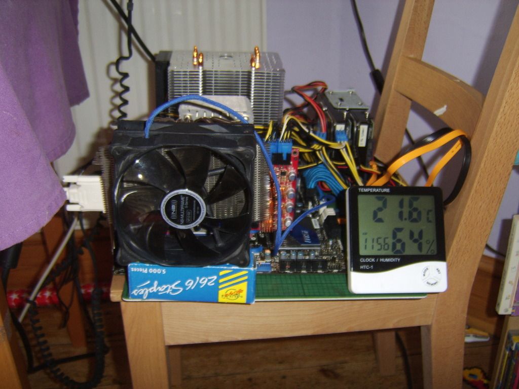

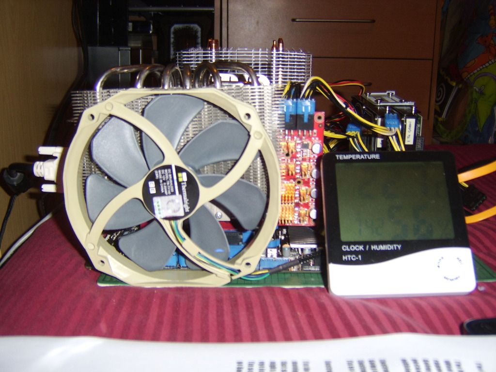

Test bench setup
Cpu cooled by thermalright Macho (passive)
Bequite Efficient power 600w (cooling Macho)
HTC-1 thermometer
FurMark 1.10.2 run for 15min (6v NB-S2 testing was run for 10mins)
Gpu allowed to cool to 25-28c between tests (~5c above ambient)
Photo taken just before running Furmark (fan IS spinning - it's just the flash)
Dawn of War (DofW) Max temp are after a Hour of gaming

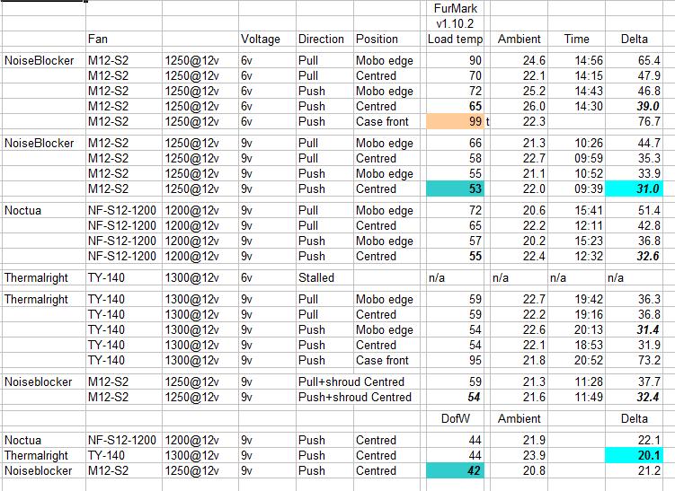

Comments:
Gpu throttled at 99c
Moved rooms half way through testing - pc hardware on cutting board (moved as one)
Didn't take screenshot (sorry)
Photo's of every setup on request
Results:
Case fan (semi passive) airflow much worse that active cooling
TY-140 position (due to it's size) made little differance
Adding a shroud gave higher temps (push and pull)
Delta Temps give more accurate data - see gaming temps (bottom of table)
Temps with fans Pushing air are slightly affected by fan position
Push significantly better that Pull (all fans)
Temps with fans Pulling are significantly affected by fan position
NoiseBlocker NB-S2@9v Push + Centred
Fan pushing air & Centred, best results - Just better that 140mm TY-140
Noctua NF-S12-1200@9v Pull + Mobo Edge
Fan Pulling air and out of position gives worst results
Shrouds give worst results
Over sized fan - position makes little differance
