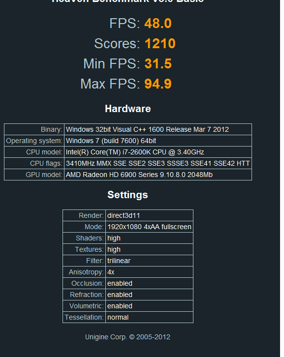

So I had to have a little play with the card in my 2600k system to see how it compared to my unlocked clocked 6950 940core 1375 memory.

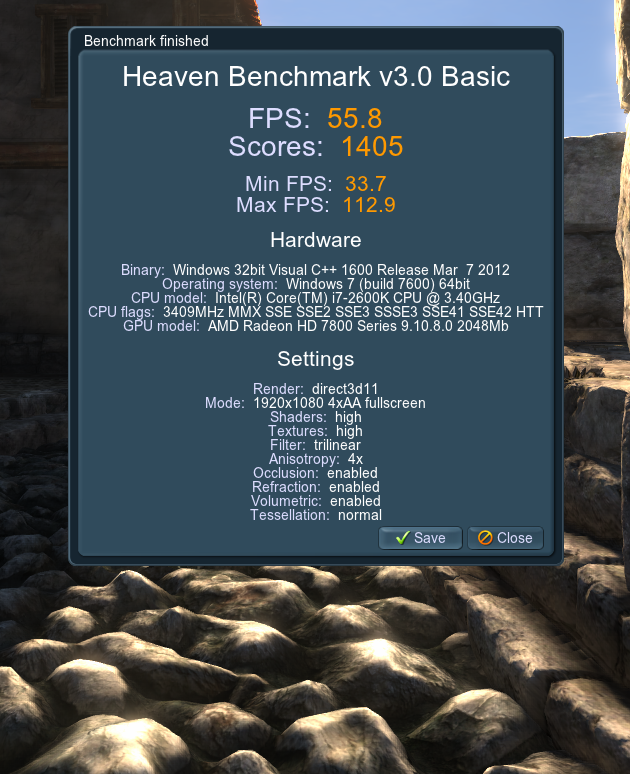

Using 12.11 b11 for both cards this little card when clocked to
1000c/1300m equals my 6950 in heaven 3!! I havent had time to compare many games but in bf3 the 7850 seemed to provide greater average fps.
The max I have been able to run the card at has been 1200/1400 but that was on 12.11 b8. Here is a screenshot of 1150/1450.
6950 =

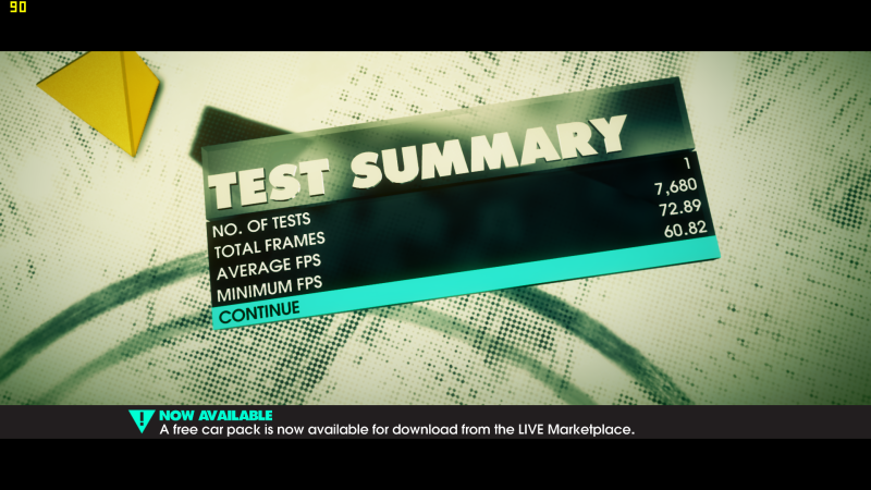

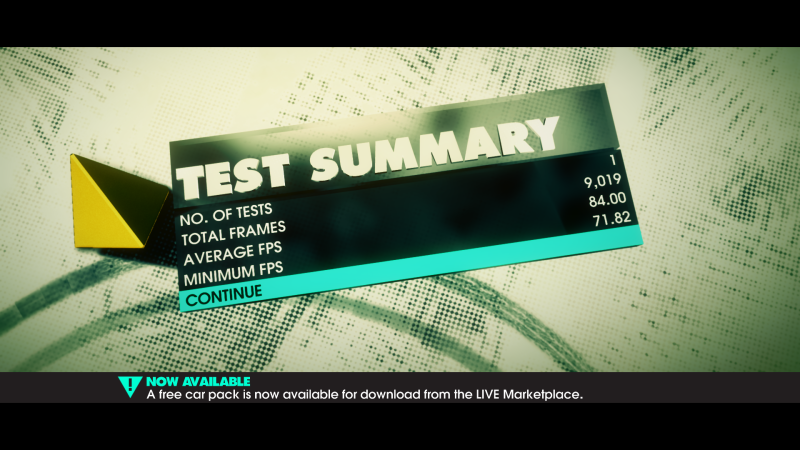

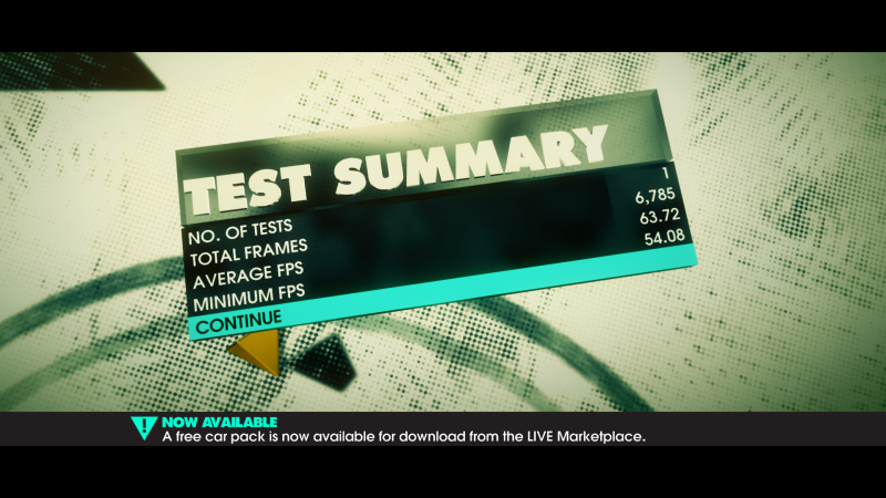

dirt 3 links
6950 =
7850 std 860 1200=
7850 1200 1400 =

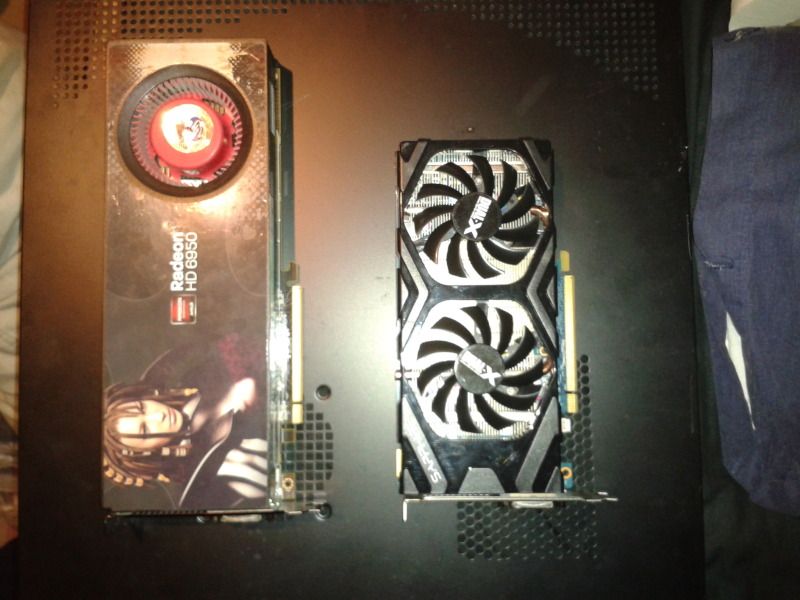

The card is very short and runs cool, the fans are pretty quiet when gpu is at full load.
The difference in temp between the 2 cards when fully overclocked is
7850 63c max
6950 82c max
8'' vs 10 3/4''
