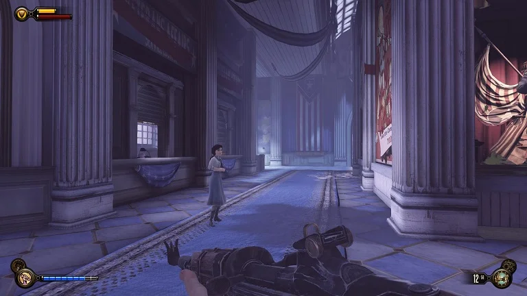

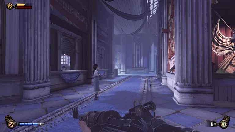

After experiencing fps drops from 80fps to 30fps in totally random situations. I decided to investigate. I have found an issue (with 310.90 and 314.22) with possibly Nvidia only?
Anyway, with Ultra dynamic shadows, these random drops occur, without, FPS stays permanently high and solid.
Comparison:
With ULTRA
Very High (one down from Ultra)
The only difference I see, is the window. I am going to test outside, but honestly, with vsync on, constant fps of 60 without the ultra setting. With, it would drop to a solid 30 or go between, but never below 30???
Just thought I would let you know as I don't think I'm the only one suffering with this...
To be honest I cannot see any difference between ultra and very high. Maybe it's just because of how small the screenshots are but I can't see anything different.

As for shadows, the setting probably determines the amount of nearby lights to render shadow maps for. It might be the case that these lights don't have any effect on the scene that you took the screenshot for but are still being rendered just because they're nearby. I've not noticed any lack of quality in the shadows even on High settings and I'm quite picky about these things. I'd prefer the extra 10-15fps you get from dropping the setting down over the almost imperceptible visual improvement.
